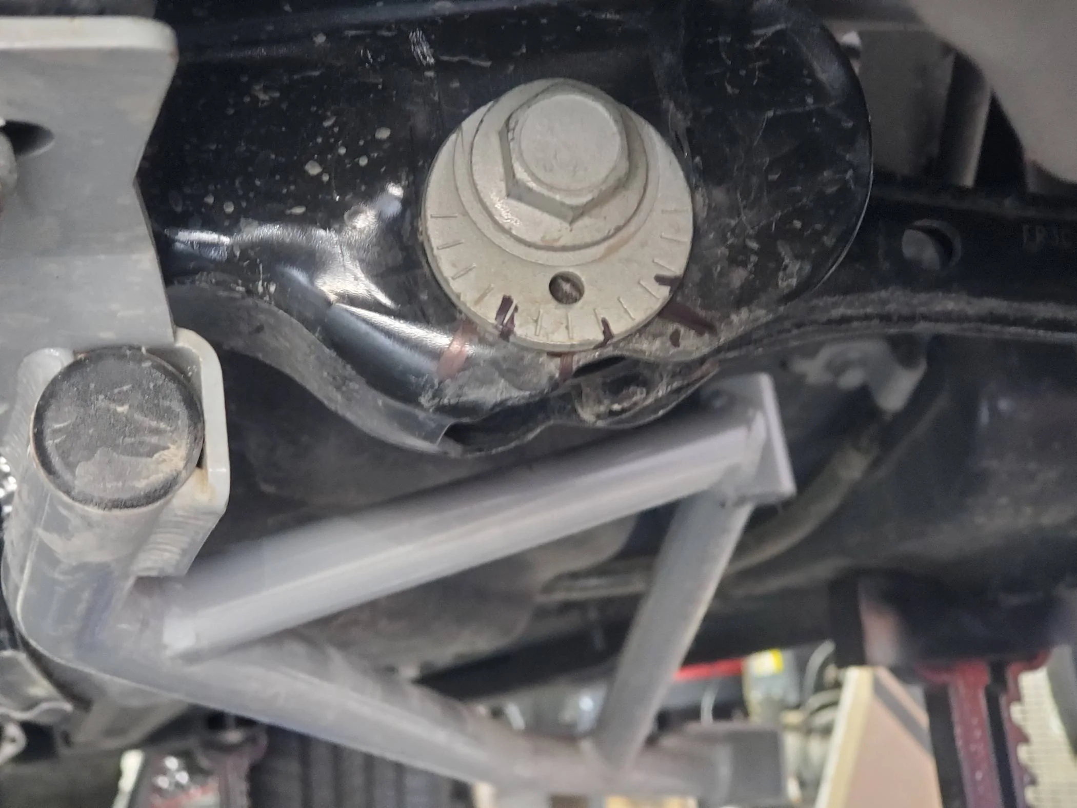

Busy weekend. Somewhat finished of MCS install. Since I was in there, I put in SPL rear camber arms. The driver side took 1.5 hours while the passenger took 10 min lol. Added MMR rear bar relocation bracket

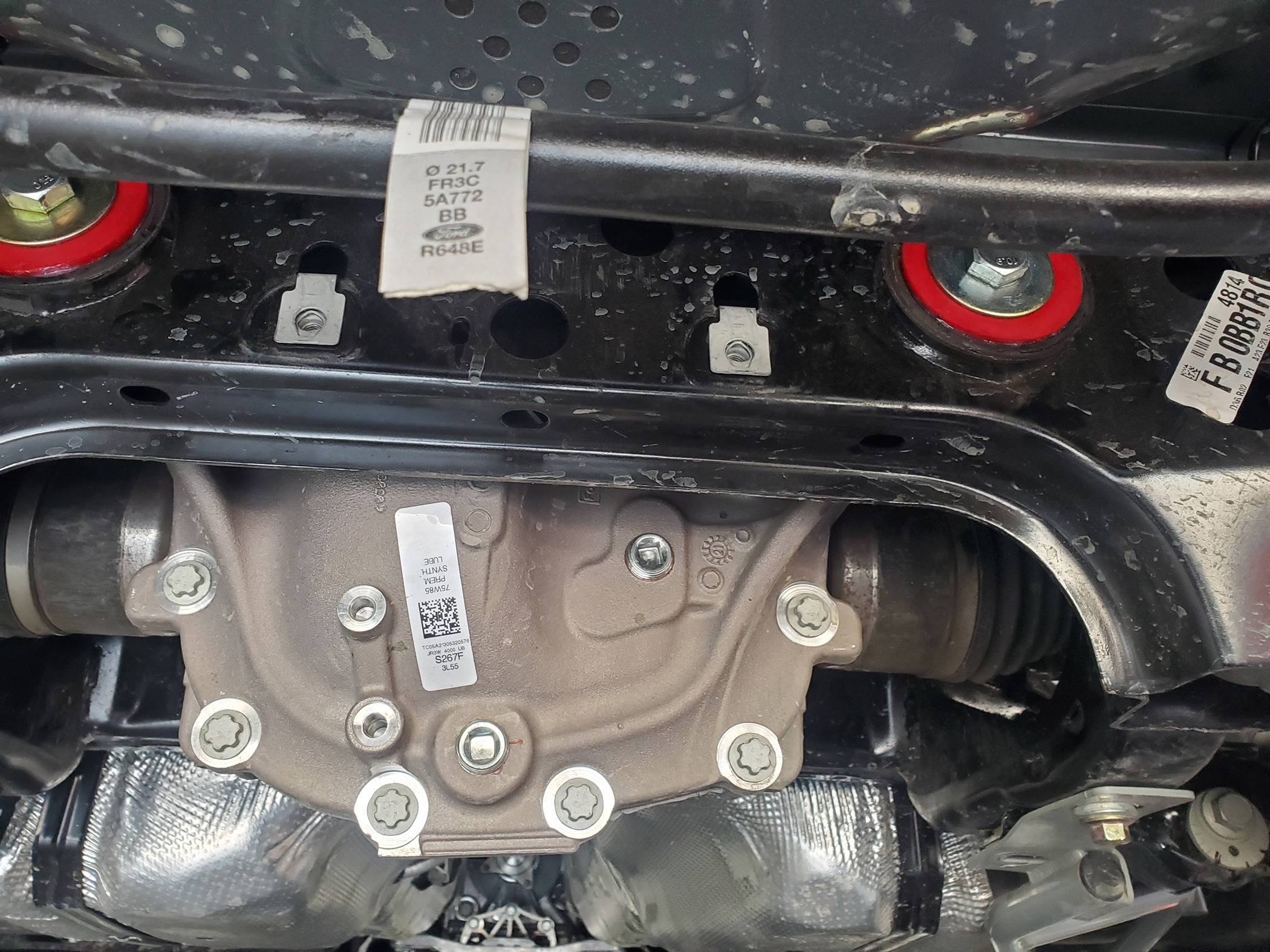

I went to see an old friend who’s got a few machines in his garage, so I could start work on the broken diff cover.
On the table, oil return port was first :
Then the broken bolt was machined out from the back, the drill wouldn’t budge it, and it still clung in there until the last four threads, even hitting it with a four flute end mill :
Shame on Ford for loading that bolt in shear on the minor diameter (if the joint is loose / loses clamping force) :frown:
Then the ears got taken out to M16 clearance, faced up (0.5mm) to clean up the scuffed face, and then counterbored on the back (25.4mm) to accept the M16 cap head (24.0mm).
All done :
The counterbores :
Same guy made me new stainless spacers for the Steeda diff bush inserts, with the rears sized up to suit the M16 conversion :
And finally, the two steel pieces for the toe link bush removal / installation tool :
We finished at 1:00pm, in an unheated garage, that was only a few degrees above freezing … 🥶 Yes, I still had my shorts on (but not my crocs) … :giggle:
