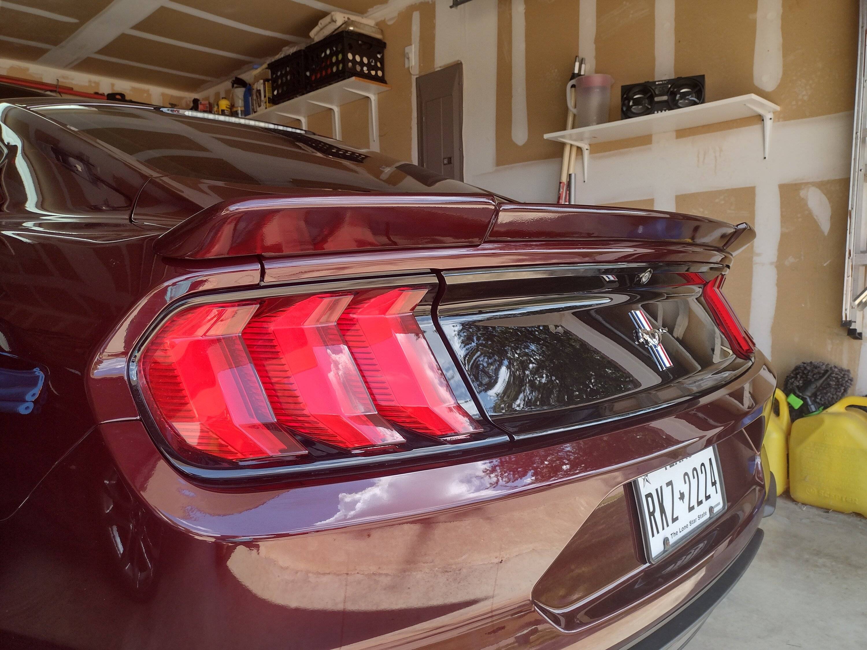

MP Concepts GT500 spoiler fitted. Was killer today, car was reading 30ºC (86ºF). I'm a Geordie - we don't do heat in the north east. We do cold here. 🥵
Geordie of the Antarctic
Got to say, my dad and I were laughing at the instructions (or lack of). 7mm and 11.5mm holes? We measured them and actually, 6mm and 10mm were the correct diameters. And the spoiler didn't even line up with the supplied template. Good job MP Concepts!
So we drew around the locator pins and used them for our initial holes. Then we put some white chalk pen on the ends of the threaded screws and put the spoiler in place, and then used the transfered white marks for drilling the 7mm holes. 🤪
Anywho, alignment niggles adderssed, I stripped out the liner inside and then my dad was tasked with drilling. Thought I had the safe job. Screwdriver wasn't my friend today. 😁
Popped some silicone on the threads as I'm paranoid about water getting in.
And the end results. I think it looks much better than before. Has more purpose about the rear end. We didn't put the gurney flap on - we think it looks better without. So I'll keep a hold of it and if I change my mind we'll fit it at a later date.
The Mazda paint seems to be a really good colour match as well. No idea why the Kona Blue Ford suggested was totally different on the swatch sample. Weird!
