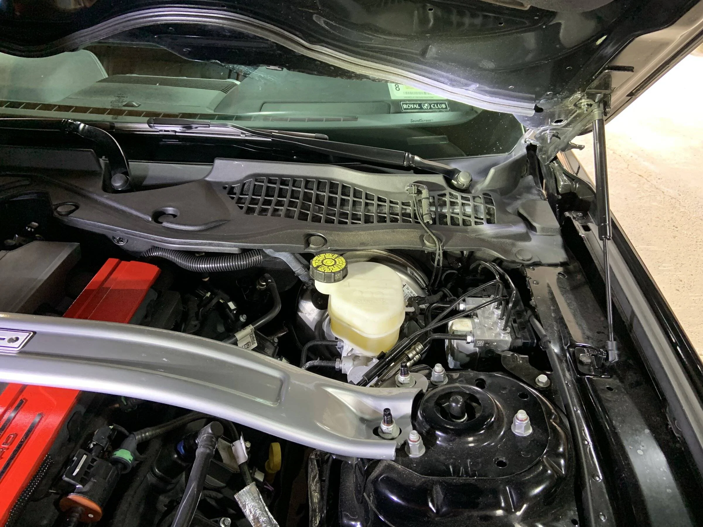

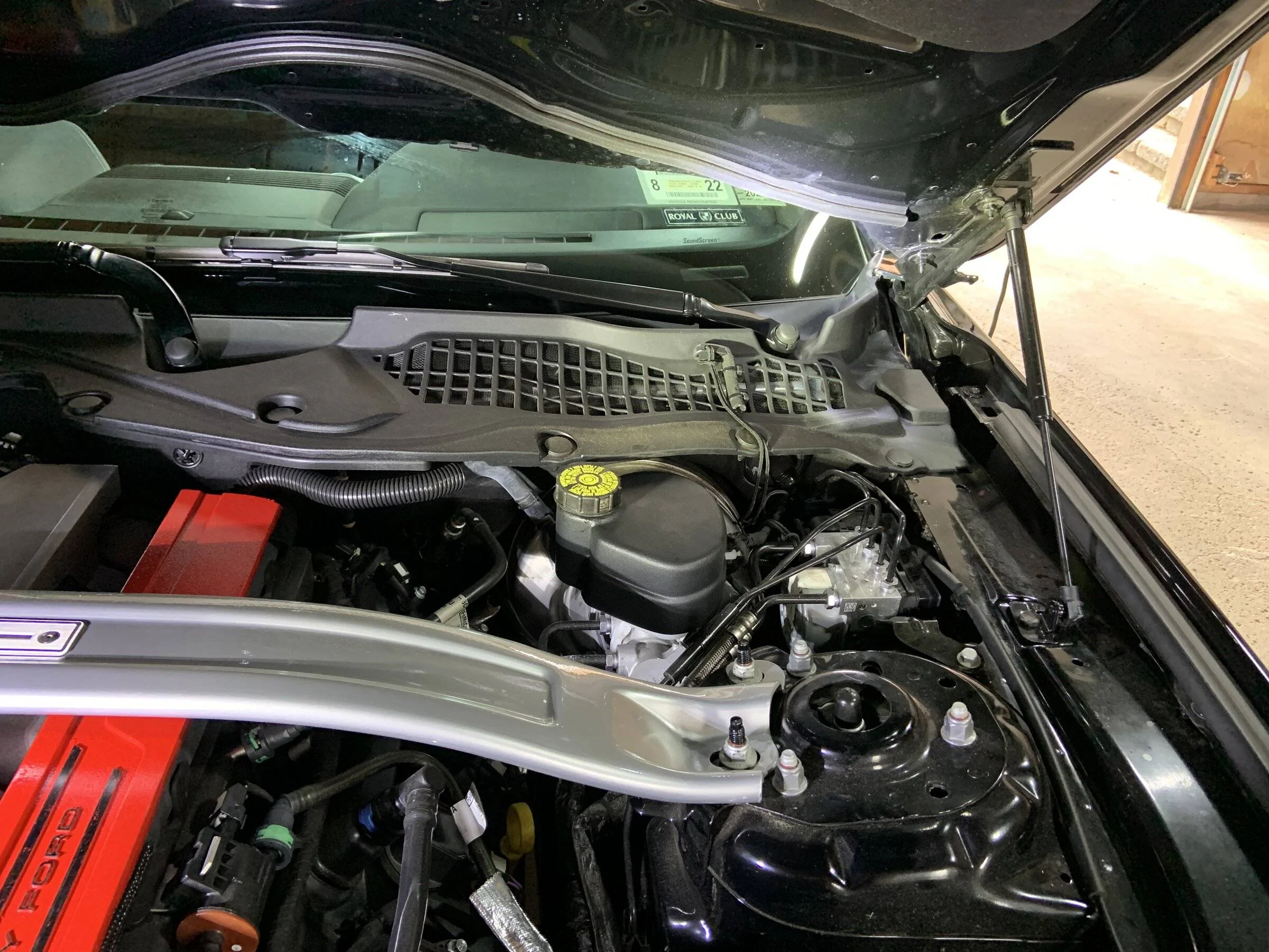

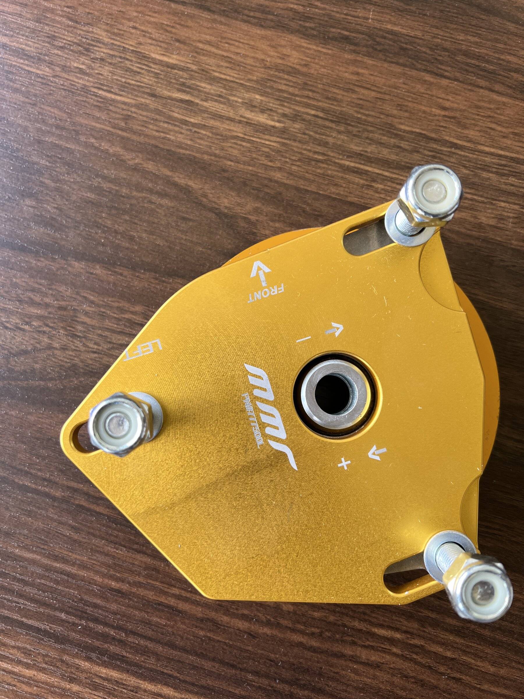

Not sure what you are fastening, but those nuts with a rounded crown appear to be non-standard. Is there blue epoxy coating on some of the threads? This is a common joint thread locking feature. Or, do you see white plastic around the top of the nut? This also is another way to prevent the joint from becoming loose. Let me know as I am a fastener engineer from Ford. These concepts are used when only a shallow height nut is necessary, because over torque-ing will break the nut, not the bolt or stud which is the desired failure mode. You need to know the torque spec. for correct installation.
This was me. :) I installed the Steeda strut brace and those are the aftermarket nuts it came with. The nuts have the white plastic inside. Steeda say 35lbft for the torque and I'm going to redo the fitment today.
I think the bigger issue is that the steeda bar has more angle than the stock one, because it's not designed for the cowl brace to be there. I think it's intended for people who have the base cars but who don't want to install all the other stuff. Or did it come with the cowl brace (the black bar that runs from the firewall to each strut tower)?
If the cowl brace was on your car from factory but without the strut bar, that's interesting. In America the only way that happens is if your car is equipped with a 20 inch wheel package as far as I understand it.

Thanks. Its coming off tomorrow, I'll pop a washer underneath to fill the small gap on the inner coloured ones, due to the extra brace.
I'll then use two washers on top so that it doesn't dig in when I tighten it up. That should hopefully then torque down properly without it going on and on. 👍
Mine did the same thing. Had to buy a bag of grade 5 nylock nuts. A few of the nuts stripped out trying to get them to the correct torque. The studs for the struts are luckily harder then the nuts so those give first. I eventually pulled the bar out. Gets in the way and it's kind of just a show piece.
