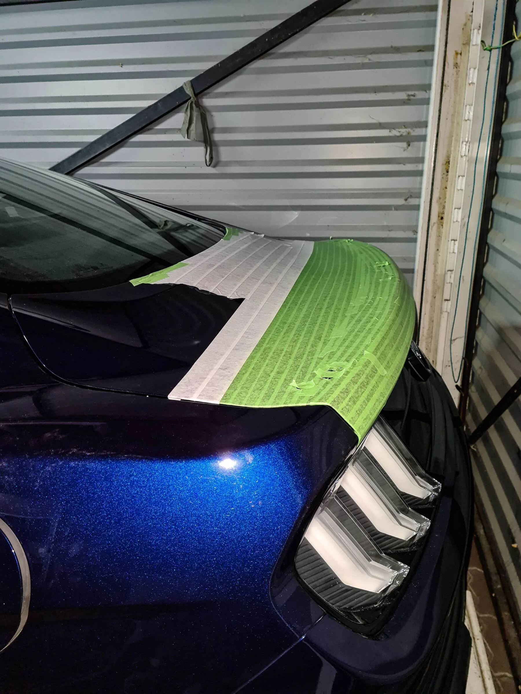

I originally went with Black acrylic. The emblem they did looked fantastic; but there were some issues I couldn't foresee.
The decklid panel has a bit of a curve to it. Its not much, but its enough. The emblem itself was actually slightly concave, in the opposite direction. VERY slightly, but those slight curves combined for sad results.
The acrylic DOES NOT want to flex at all. When I tried to press the emblem down, it cracked across the middle.
Contacted them and told them the problem, they were extremely helpful; suggested that the aluminum composite might be a little more pliable... also suggested I downsize it a bit which I had to admit was correct.
They even gave me a break on the price for the second try and rushed the fabrication for me. So great customer service to go along with top notch quality...
Aluminum composite was perfect; I was able to bend it a little bit without breaking it; went down perfectly on the curved decklid, and looks great.
