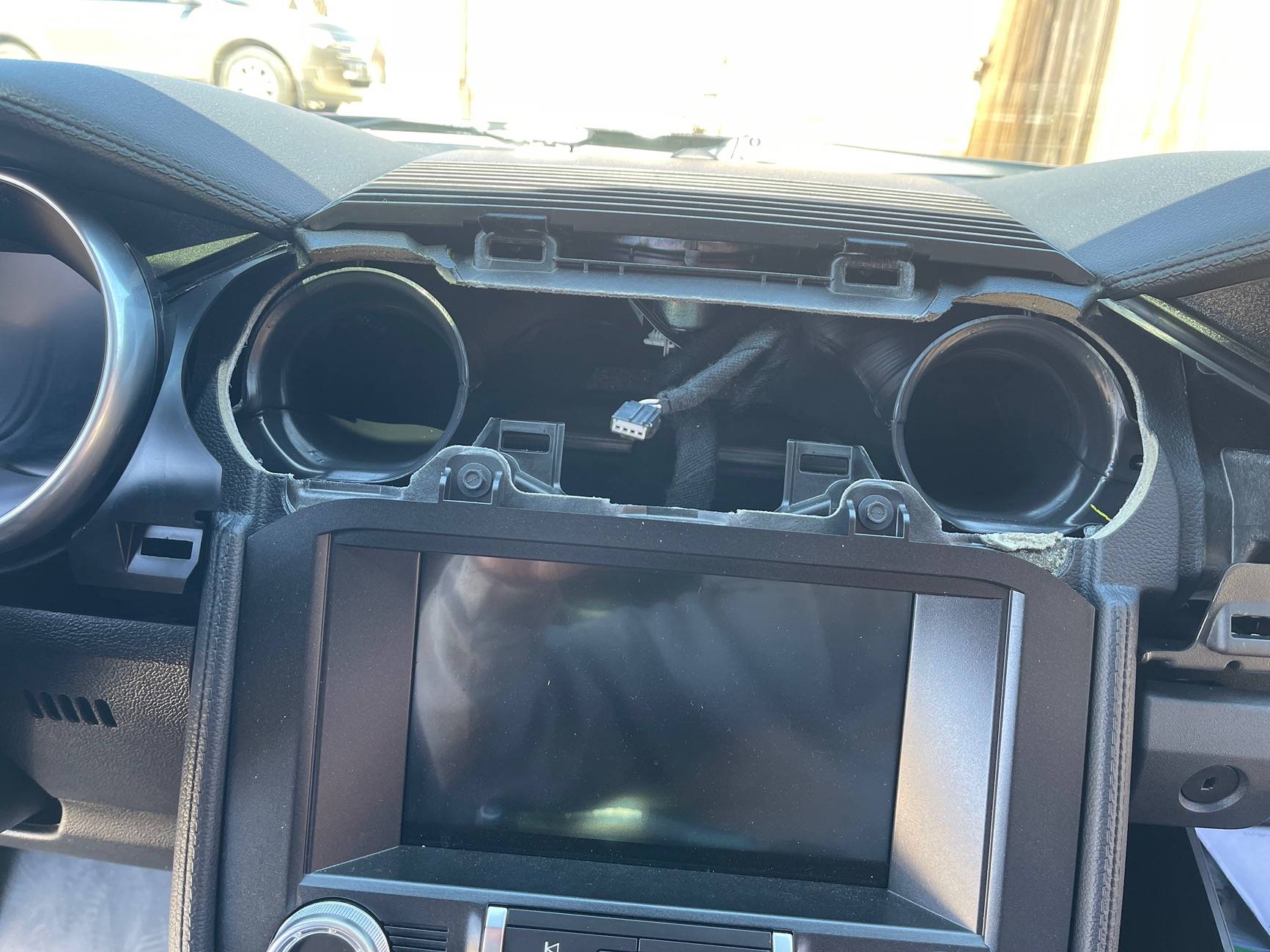

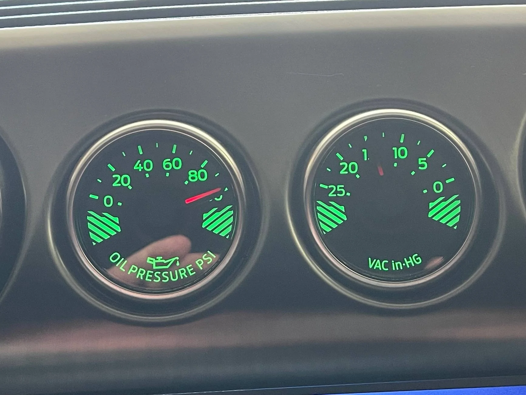

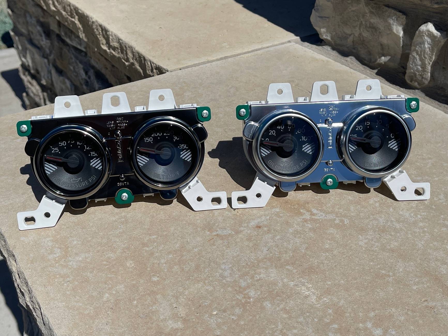

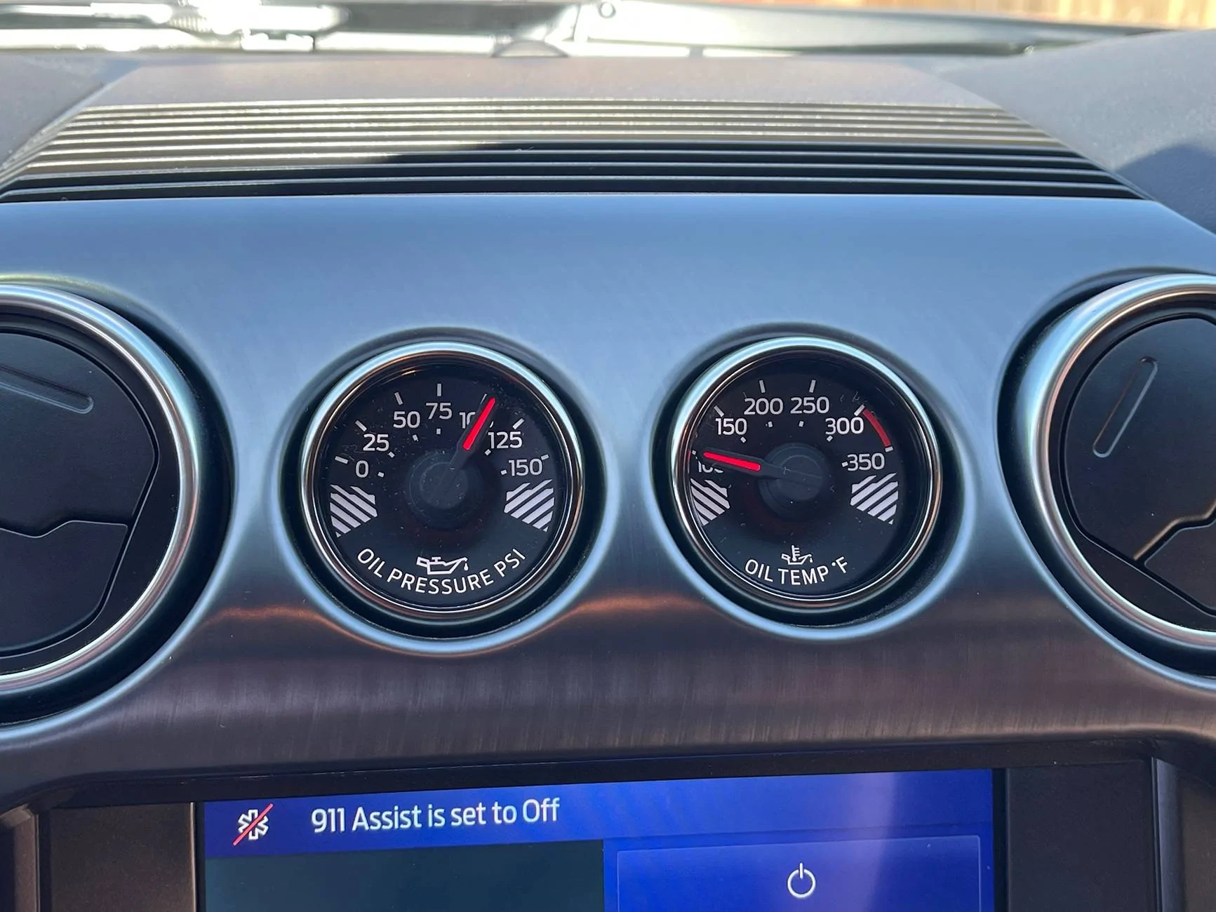

Swapped the center gauges for the GT350 cluster to add the oil pressure and oil temp. Easy swap after jerking on the dash to pop the clips loose. Only thing is the gauges don’t change colors with the rest of the dash gauges. They stay white all the time. Not a huge deal unless you’re super OCD. Having a dedicated oil temp gauge makes it well worth it as well as an oil pressure gauge that reads to 150 psi versus the factory 100.

Probably the easiest yet most effective mods I have done...

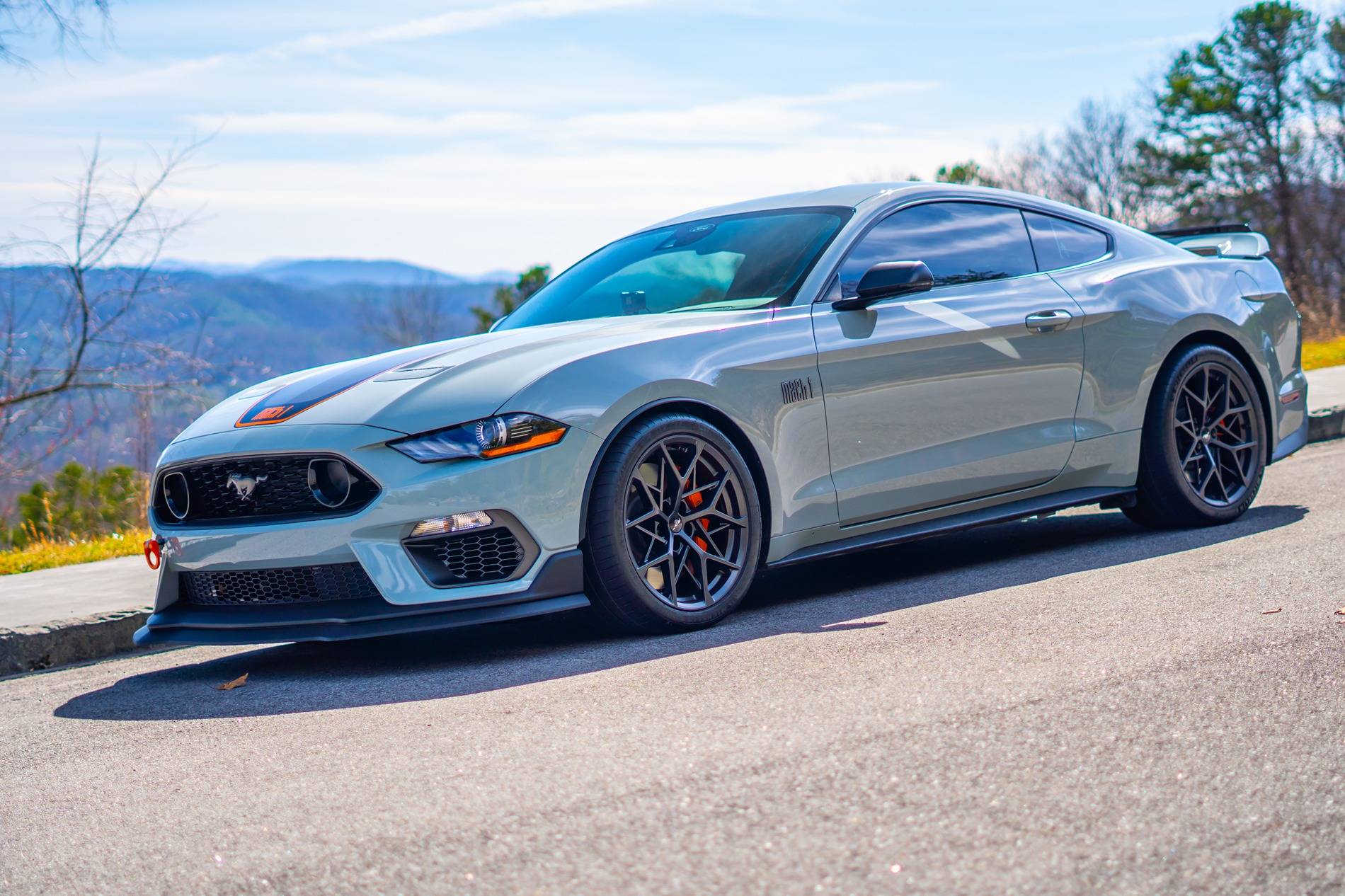

I agree, I have some with a bluish tint too. Its pretty cool...
I see blue quite a lot in yours, it must be the combination of phone type and camera settings :like:
I know for sure that Samsung captures grabber lime much more realistic than iPhone (x) :like:

Yeah, I have found that an iPhone picks up the blue a bit more in the right light, but it is downright white in harsh sunlight... My aunt even asked me if my car was white once when I shared a pic :). My profile pic was made by a friend with a Mirrorless Sony DSLR... I love that pic..

Those with stock M1's: what is your idle speed and vacuum reading at idle?
At operating temperature, the engine idles at about 750. Vacuum is 17.5 Hg.

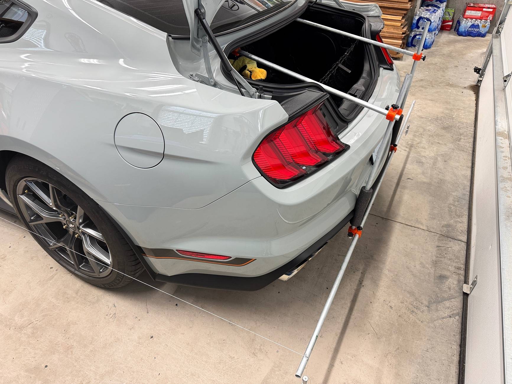

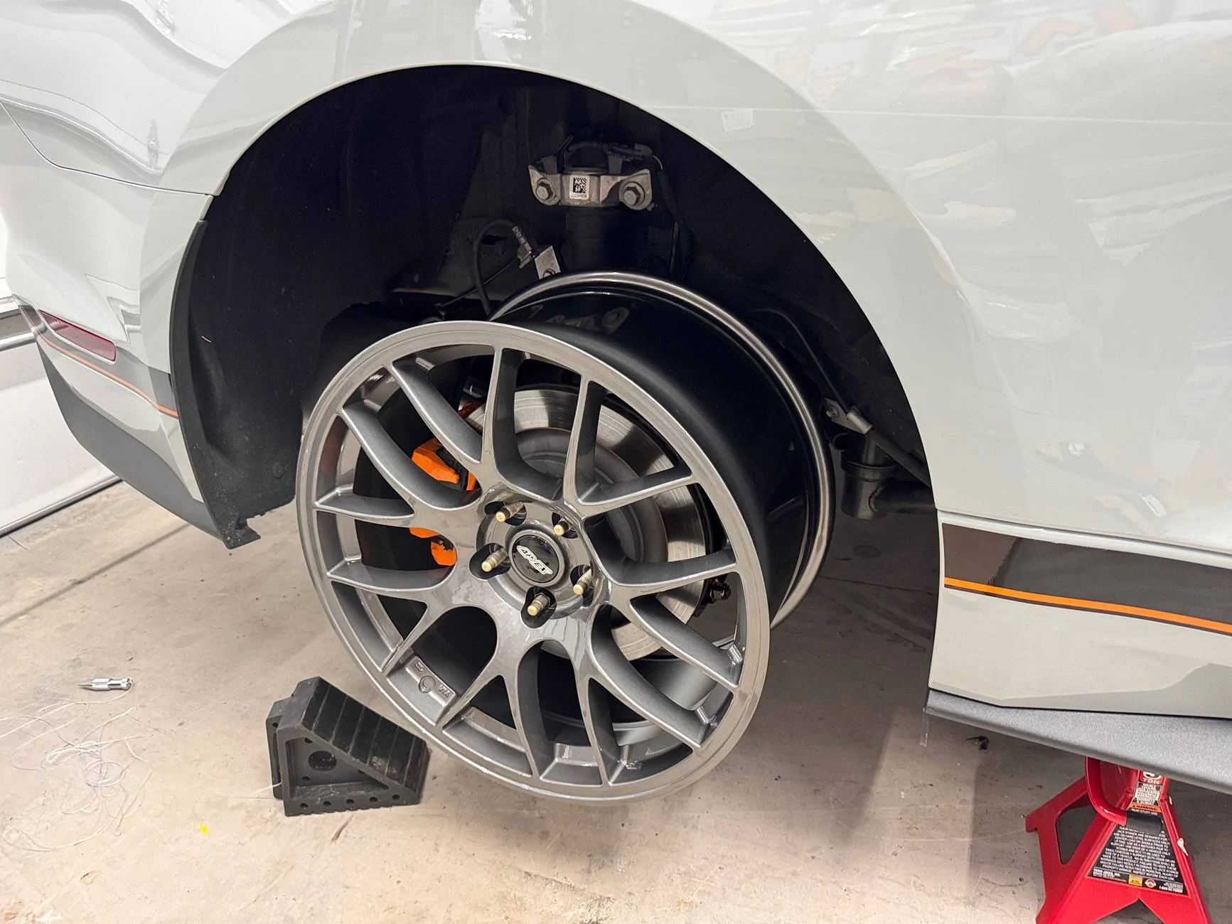

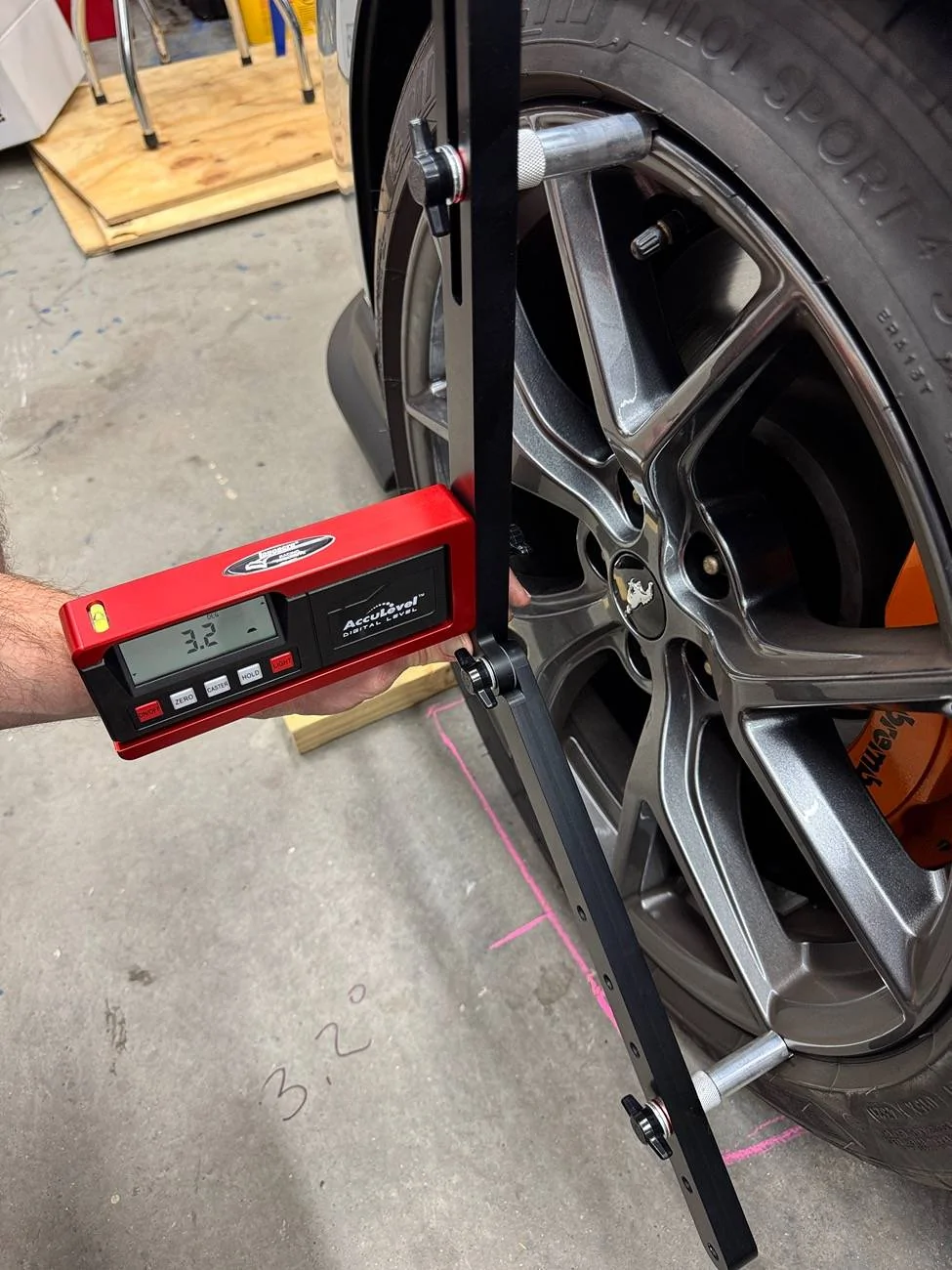

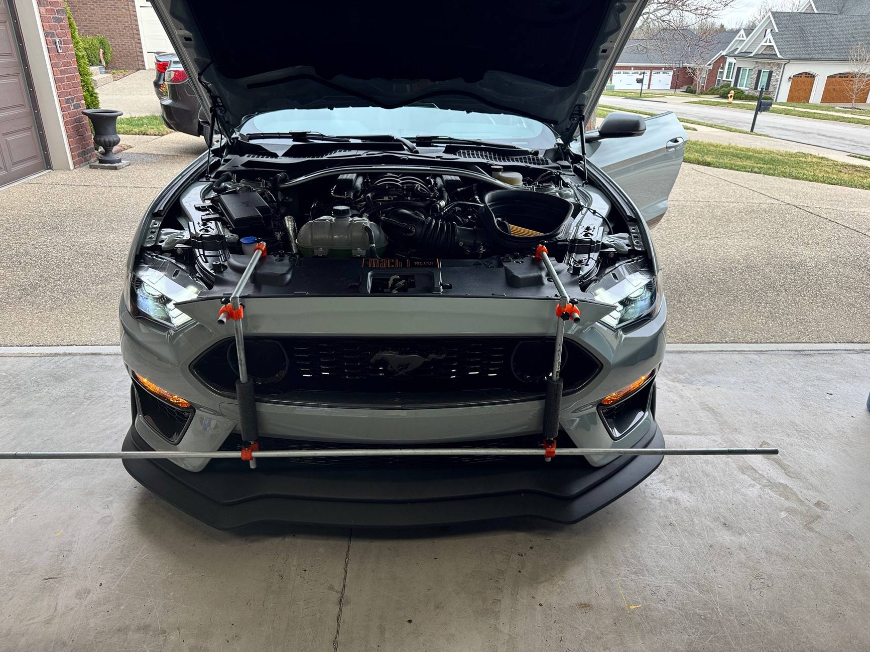

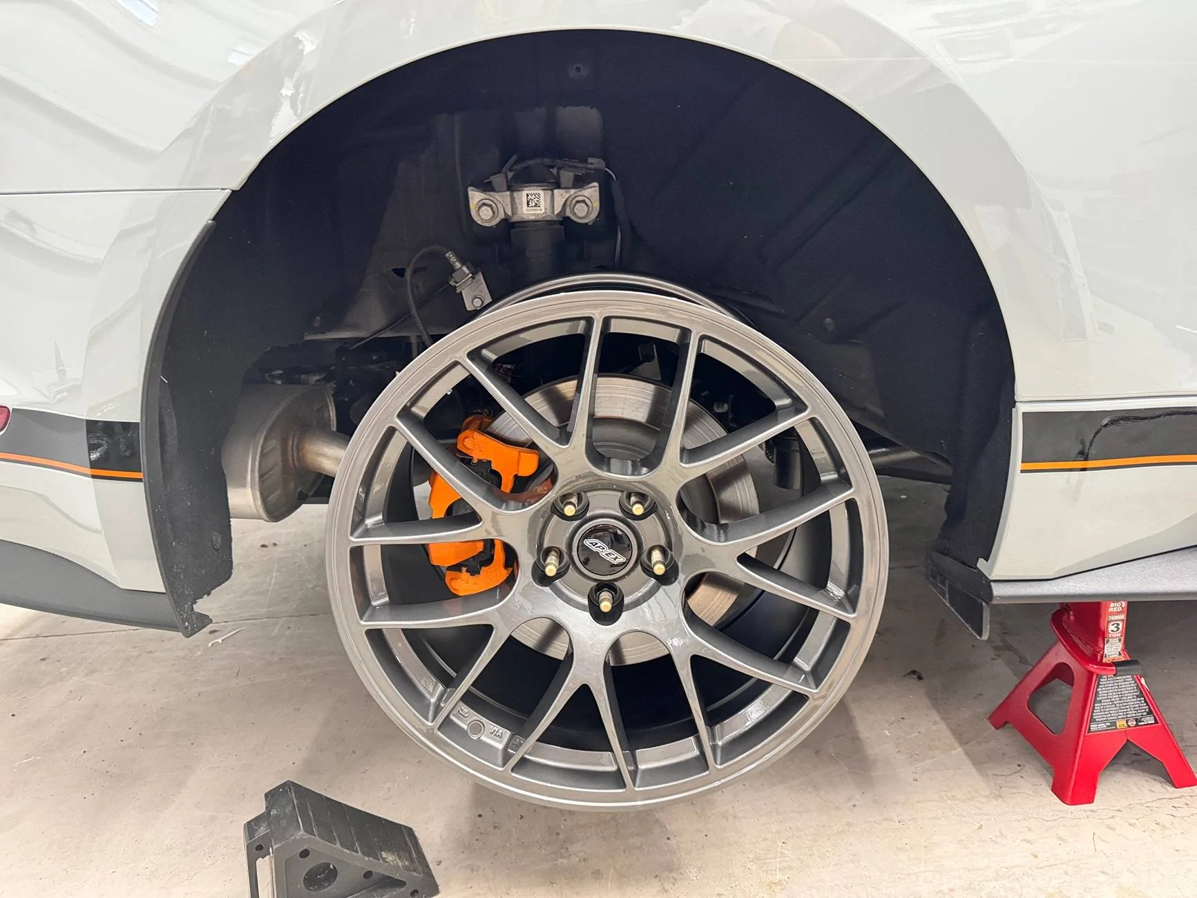

Test fit Apex 19x10 street wheels (these will get DWS06 tires for year round driving-minus salt and snow). Also tweaked the alignment-mainly rear toe. I’m debating selling the factory non-HP PS4’s and just having Apex 19x10’s and SP2 19x11’s (summer/track). I’m honestly not sure how much more I like the the caliper garage alignment setup versus just using two pieces of conduit, strings and jackstands. My wife thinks I’m crazy.
That style works really well though. Exactly how proper race teams do it.
You need a QuickJack though! With my QuickJack this is a very straightforward process. No fussing with jacks and jack stands.

Quick jack is def on my list. I could see it making this a lot faster and not resetting everything. I could put a 2-post on either my 1 or 2 car side of either garage, but I'd hate losing the flexibility in the floorprint.
You never have to calibrate the conduit .
