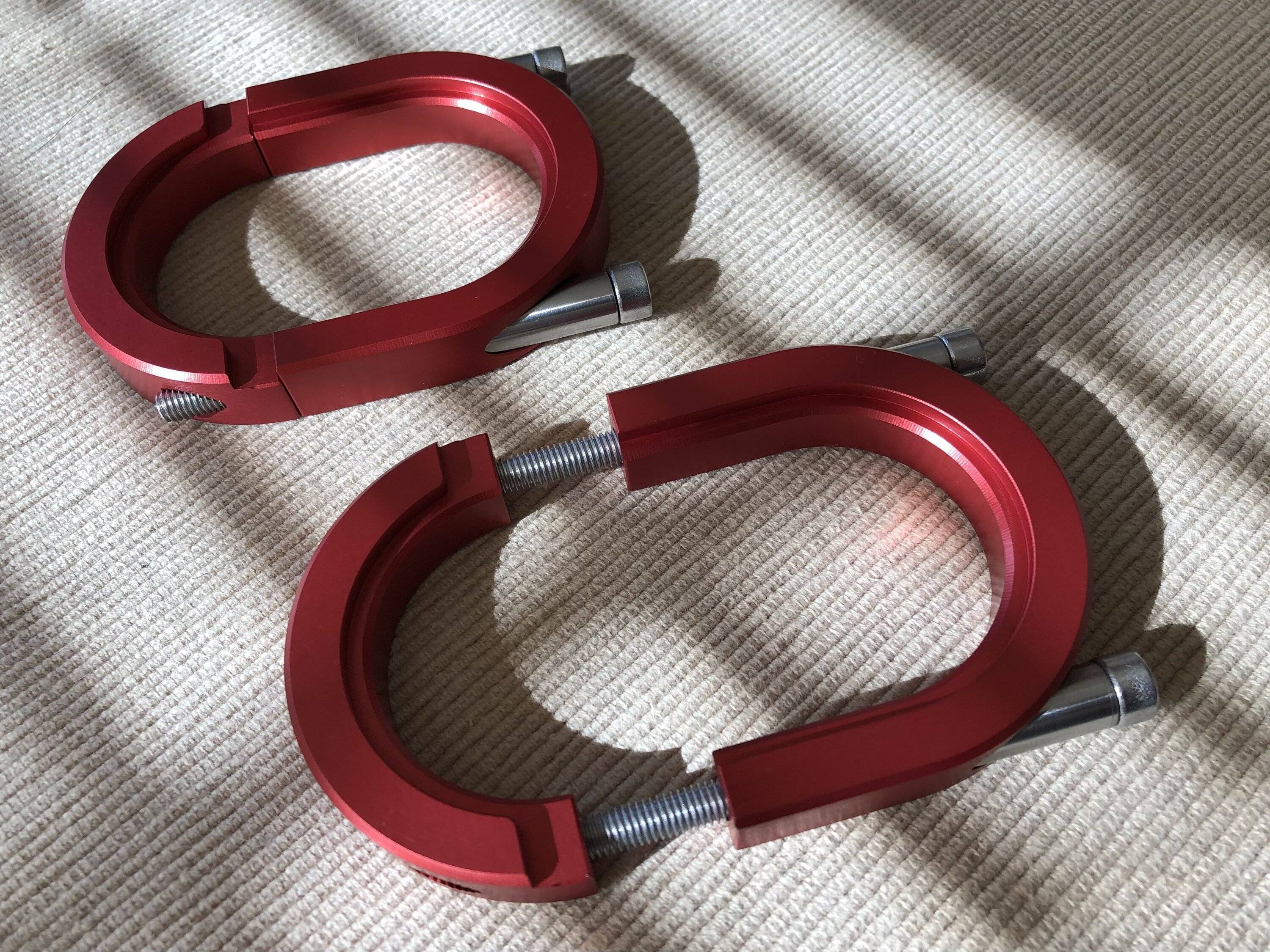

How hard were the bushing supports and delrin alignment? Fairly quick install time wise?
First side obviously took longer just figuring out what went where but overall not bad. The only part that was sort of a pain was the bushing support clamp which is two pieces. I had to drive the larger U shaped piece in most of the way first to expand the metal part of the bushing for the rear smaller piece of the clamp. There's not a lot of room for that piece to be inserted between the subframe and rubber bushing. Took a bit of prying and squeezing with channel locks before it lined up enough to get the cap screws started. Everything else was pretty easy. You have to make sure the front subframe bolt is torqued prior to installing the IRS brace. It's in the way which is odd because the end of the instructions specifically say to retorque that bolt if it was loosened to install the brace.

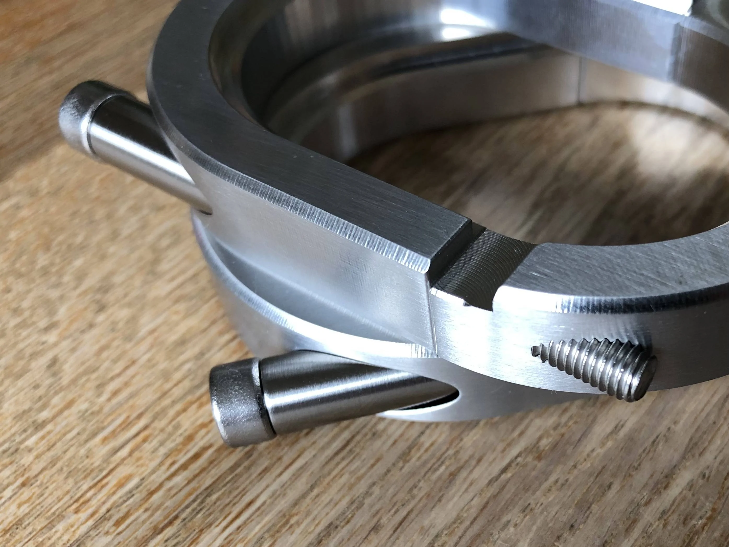

Technically, I don’t think the two piece clamp is designed to work with a Mach or 350, which may explain why you found them to be very tight / difficult to fit ?
I tapped mine right through, and went with longer bolts to help fitment without marking the finish :

Entirely possible. I could have likely put them on the belt sander and taken just a touch off to solve the tightness issue. However, didn't take too much percussive maintenance to get them into place.
I like the red!
