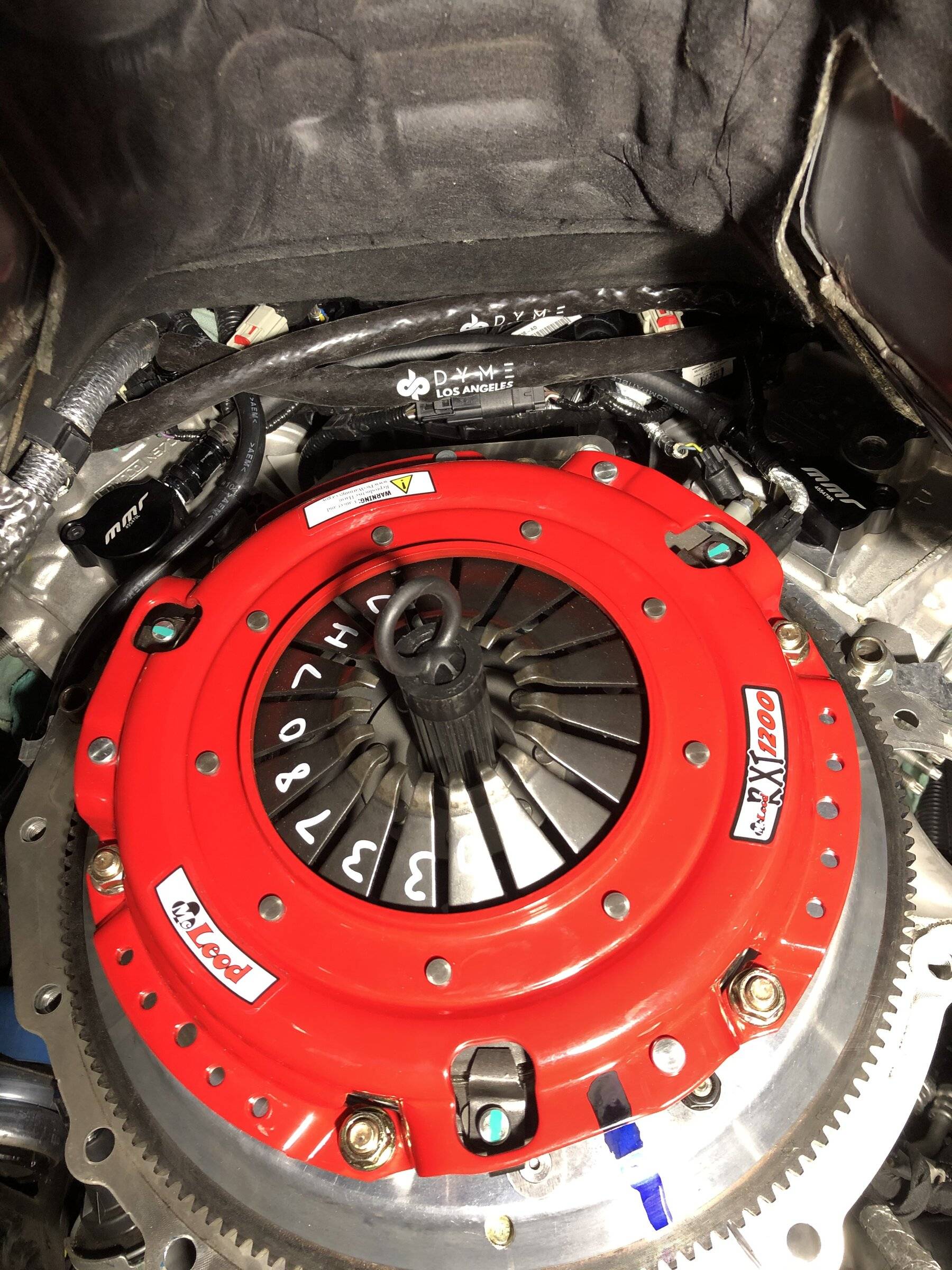

Slowly getting there. Turbos coming soon.
Did you install the MMR cylinder head cooling mods yourself?
Can this be done from the bottom if the transmission is removed?

It’s not difficult with the tranny out. It would be a serious pain in the arse from above.

Yes. Also installed AR oil balancing lines

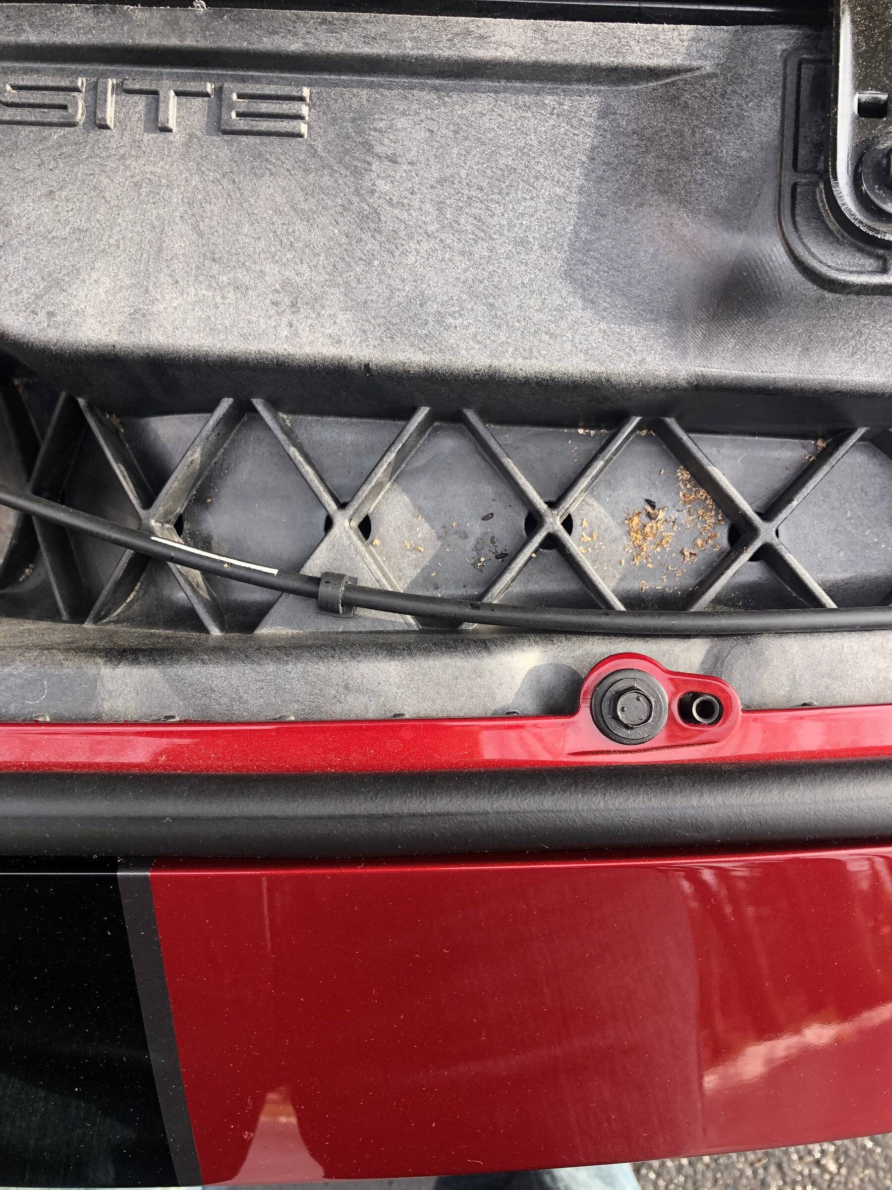

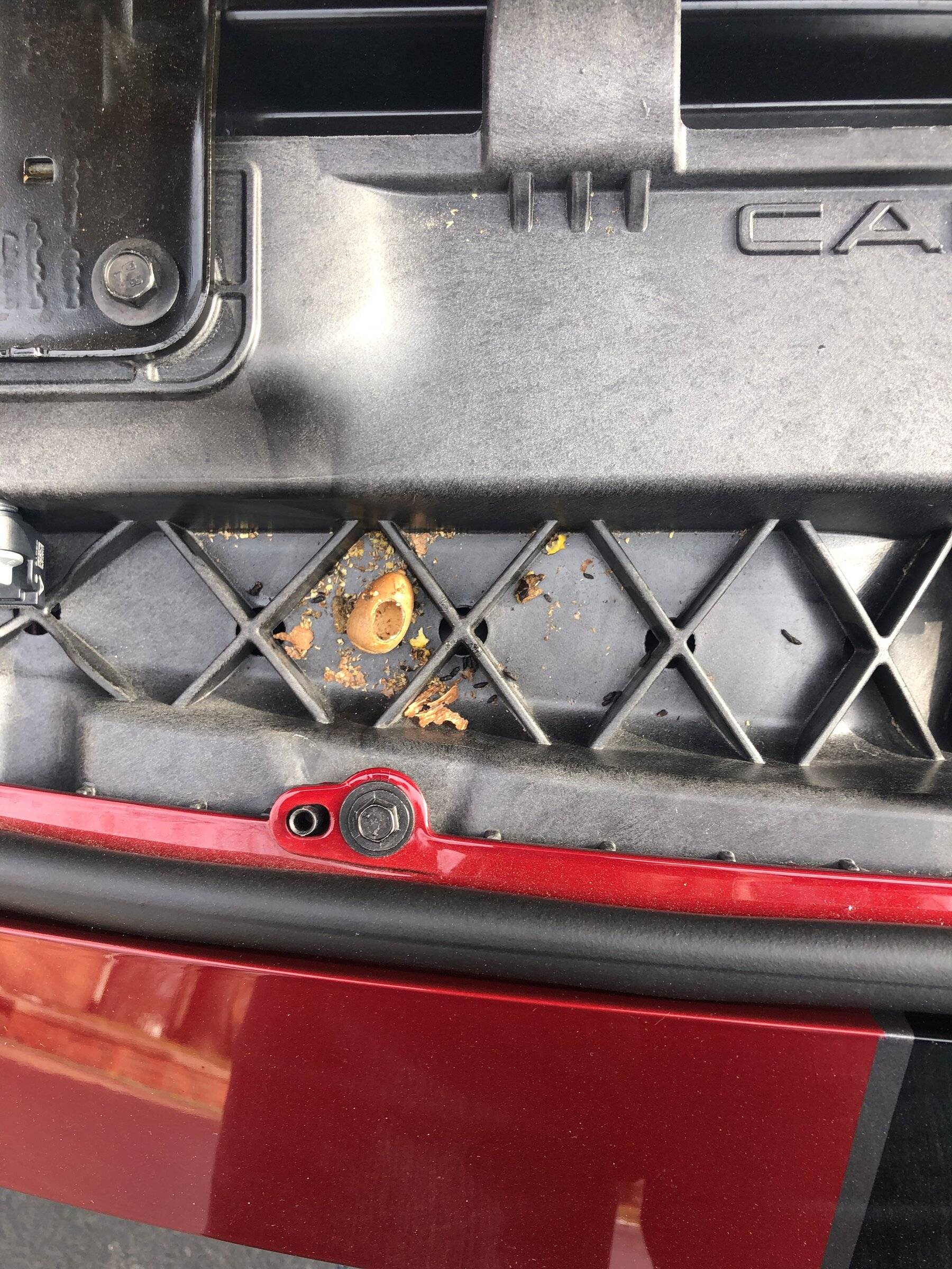

Just for grins (I really wanted to look at her), I removed the care cover and did a visual inspection. Popped the hood also and was then shocked at what I found….

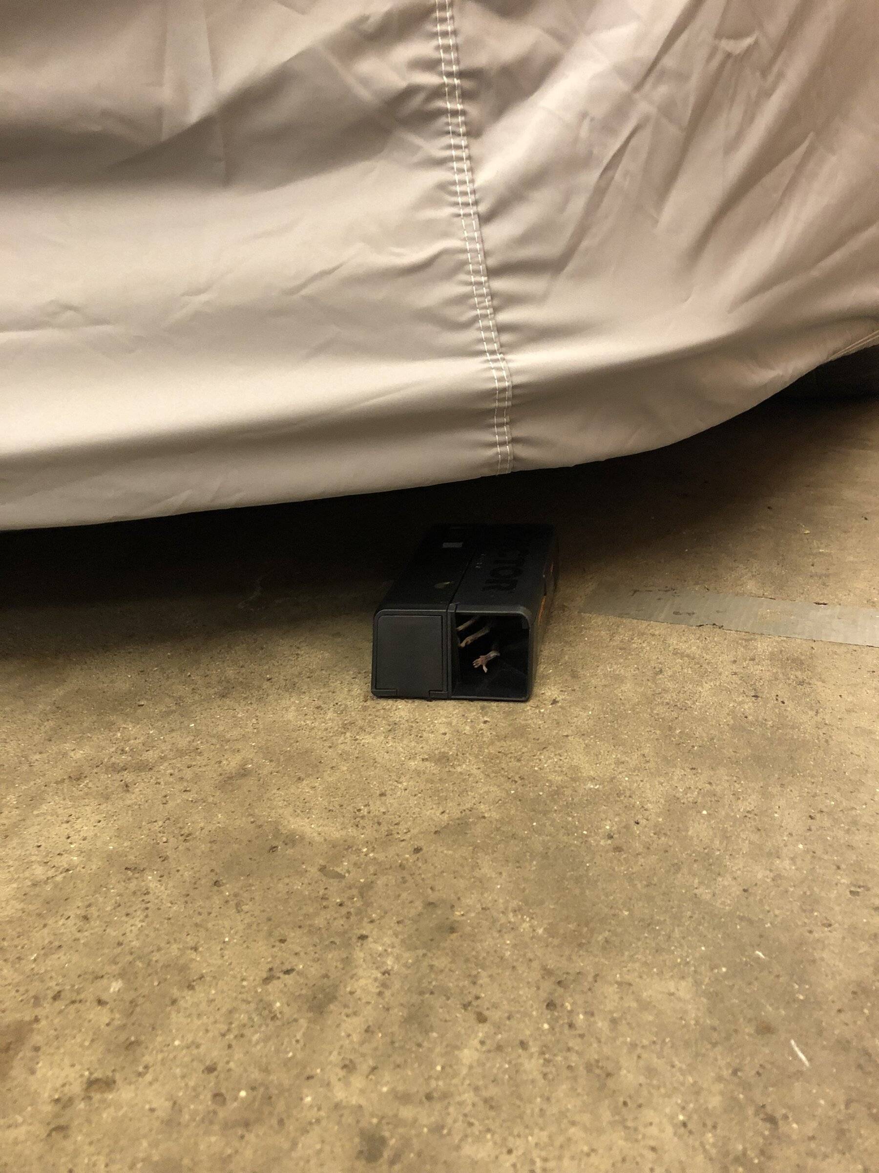

Those little f%ckers, this is WAR. Got me some new electrocution traps and sticky pads.....Going to see how they like it....
1/13 Hahaaa, I electrocuted one of those who violated my baby....
1/14 Got his accomplice this morning....:)
1/15 Junior received his electrocution this morning....:beer:

You got lucky. Over Christmas those little bastards did $19K worth of damage to my wife's Cayenne, fortunately covered by insurance.

You may still have to loosen the mount nuts and tip the motor forward a bit, but that can be done if the trans is removed. Without creating additional space between the firewall and the heads, there's just no room to get any leverage or swing on a tool and getting the plugs out can range from fairly easy to difficult and even if you freeze the new fitting, you probably still have to tap them with a rubber mallet to get them to seat. I wouldn't have been able to just push them all the way seated with my bare hand squeezed between the firewall and the motor.
