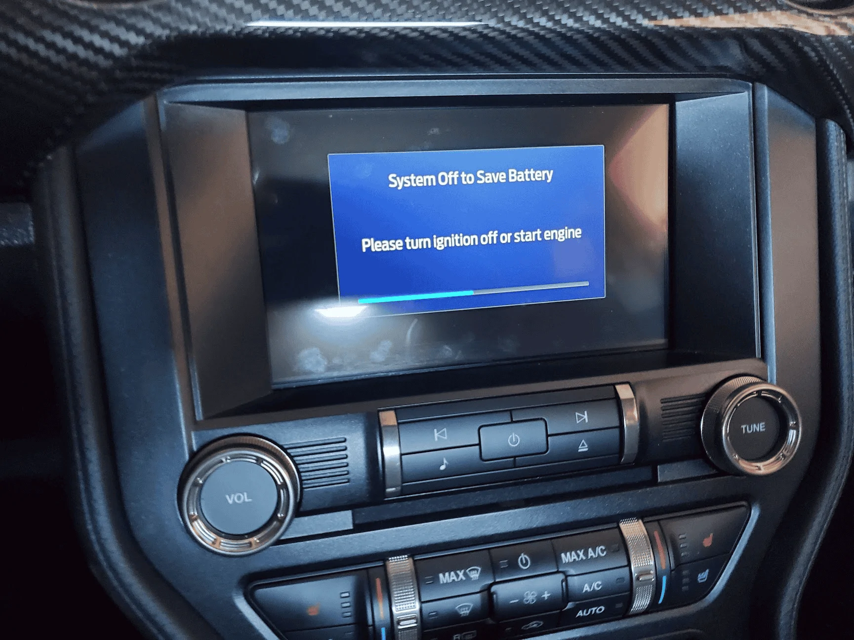

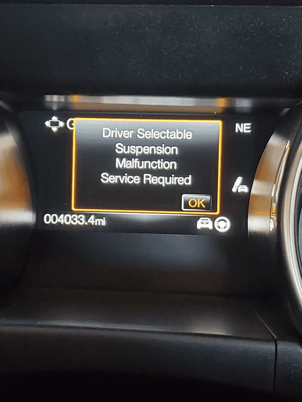

My 350 has developed a slightly different set of symptoms that seem alternator/battery related. It began with intermittent display of a ā€œCharging System Service Nowā€ message but no other symptoms. Both the battery and the alternator got a clean bill of health from a Parts Store check. My Indie mechanic examined it and couldn’t replicate the problem.
It was good for several days. But then it returned and got much worse. The message became much more frequent, the volt meter was all over the map on the high side (14-15-16 volt readings).
Thinking that the battery on my 2019 with 11K miles was the likely culprit and being on the road 4 hours from home on a Sunday afternoon we threw a new battery on it. And we reset BMS. No change. Eventually it started shutting down systems (interior lighting, infotainment, climate control, power steering). Volt meter still jumpy and showing lots of high readings.
One quirk is that the symptoms are dramatically reduced at super slow/parking lot/stop&go speeds.
I have a Ford dealer service appointment for next week, but I’m curious if anyone here has seen this before.
At this point my thinking is either bad alternator or a bad/loose ground wire somewhere.
