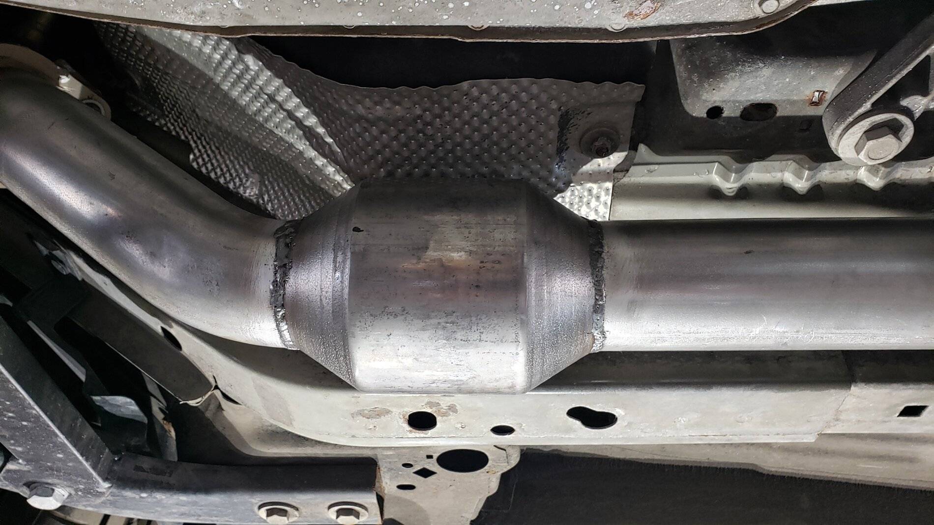

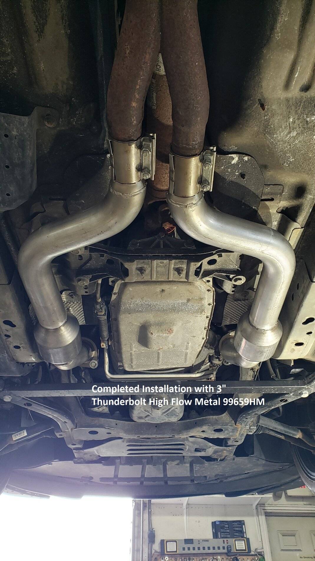

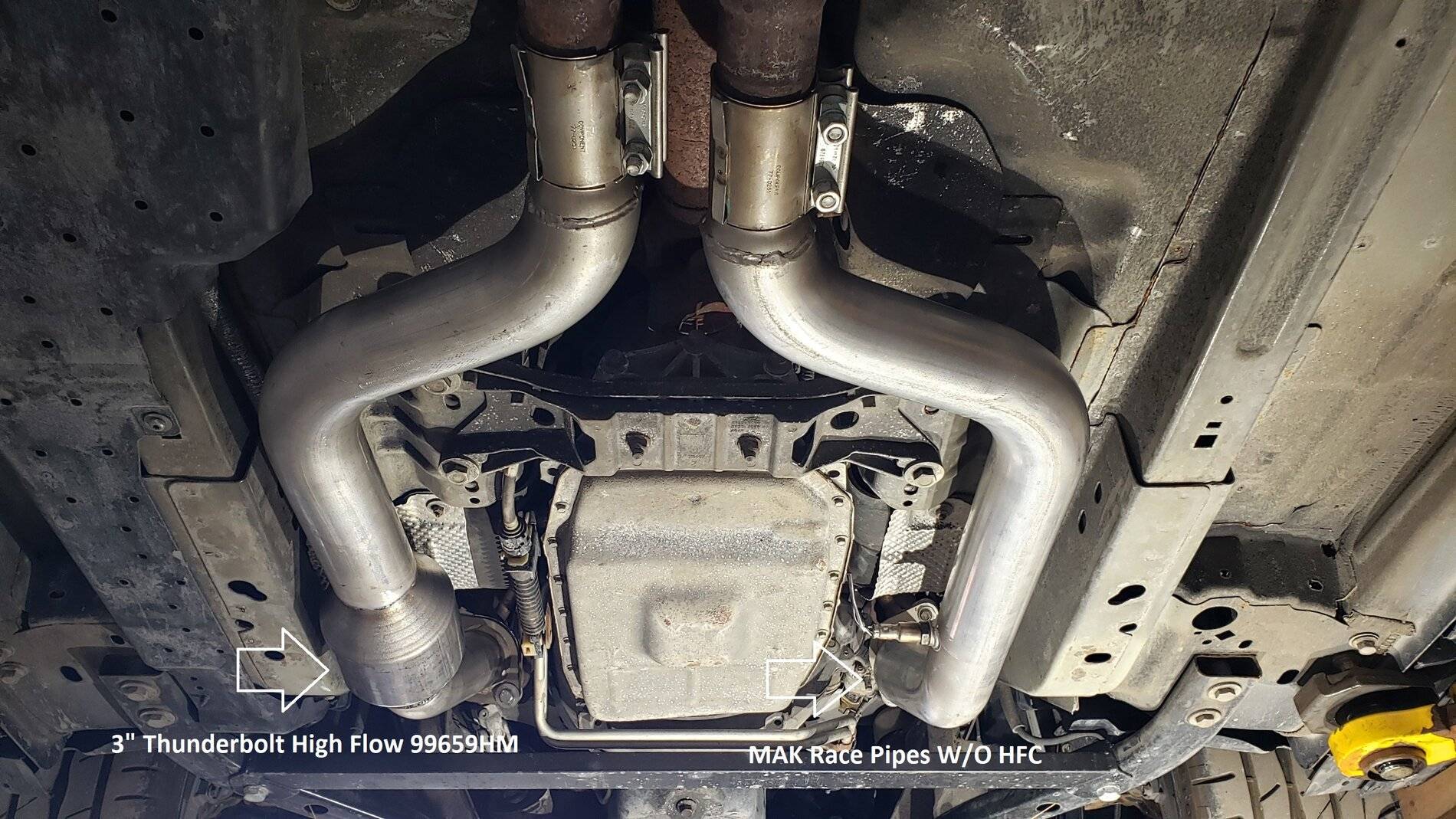

Original Setup: Borla S-Type Axel back with SR X pipe. Added the MAK race pipes and it was wayyyyyyyyy too loud for my taste so today I went back to my welder to have the 3" I/O Thunderbolt 99659HM 400CEL which are identical to the Magnaflow 99659HM but at half of the price! The sound notes have increased approx. 25% from the current setup which sounds better but nowhere to being obnoxiously loud when I had the MAK race pipes on with the CAT deletes! I totally forgot to add a sound clip but will get a hold of the welder as his assistance had recorded the new setup with his cell phone and will add it another time. I was playing safe with this 400CEL but "if" I knew it was going to sound like this I think I would've gone 300CEL HFC's instead of these 400CEL HFC's. He did an awesome job welding and 100% no leaks and the souind is awesome but wish it was another 25% louder but this I could live with no complaints! I've added some pics for reference. I also had the 2 X Bung's removed and will have them installed another time and not in a rush as my current tune already setup for them to be removed for the secondary O2 sensors.

Are you able to pass inspection with your current set up?
In Canada YES and these HFC's are good in the US except for NY & California due to stiffer EPA regulations, pretty sure anything 300CEL or lower isn't legal in the US. Got them from ZZ Performance on Ebay and shipping to Canada was 3 business days from the time it left the US to Canada which is amazingly fast!
Amazing thing is with my Borla S-Type with SR X pipe and MAK race pipes with these Thunderbolt's HFC's with 400CEL there's absolutely no drone, tone at low RPM's is non existent but when you put the foot down on it sounds freaking awesome! I just got back giving my son some driving time with the windows rolled down and he was like "This car sounds sick!"...............BUT not obnoxious!
Link: https://www.ebay.ca/itm/130951227137?_trkparms=aid=111001&algo=REC.SEED&ao=1&asc=20160908105057&meid=4694380955c74eef80f169b59d69b4cb&pid=100675&rk=3&rkt=15&sd=224271461909&itm=130951227137&pmt=0&noa=1&pg=2380057&_trksid=p2380057.c100675.m4236&_trkparms=pageci:a909e034-ba62-11eb-984f-b24a02e3db0c|parentrq:9031b3c31790a4e842342d2dfffaaef0|iid:1

How much louder is this compared to stock cats
The new Thunderbolt 99659HM HFC's have now settled and sound is approx. 50% louder than my original Borla S-Type with X pipe setup. The great thing is as mentioned above is that in lower RPM's it's quiet as my original setup, no drone and you go WOT it just sounds amazing! Now my son is like "Dad, can I drive to work and are you picking me up and can I drive back home too?"
Being that I am in Canada and it was so hard to find anyone with a S550 running HFC's with their setup there was no idea of what tone it was so knowing that the OEM CAT's were around 700CEL I played safe with the 400CEL HFC's to pass EPA restrictions in Canada if need be in the future and going 200-300CEL I knew it would be close to having no CAT's at all! I had some retard told me the 400CEL's won't mask any noise and for him to even say that it was just ludicrous! When I measured the stock S550 CAT's to the Thunderbolts the center core was approx. 50% smaller so I had a good feeling the noise increase would be somewhere near the 40-50% range so it was a good guess and it was!
It doesn't matter if you have a Roush, Corsa, AWE, or other exhaust setup and want that extra 50% increase in loudness but not obnoxious and legal in most states but 2 this is the safest and legal way to go, don't think a Corsa Extreme Double catback would need to go this far IMO but to each their own! I will try to put up some sound clips later this evening after I pick up my son from work for you guys to hear.
