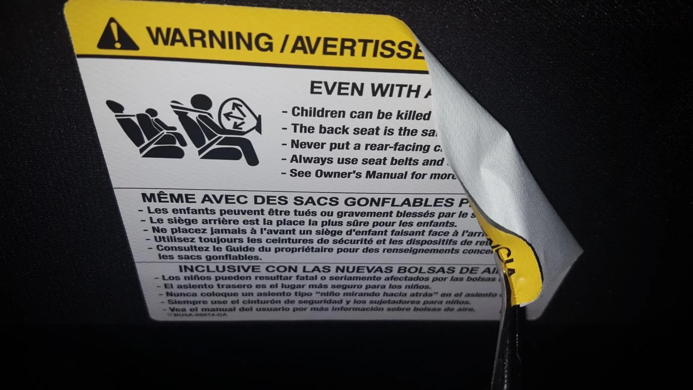

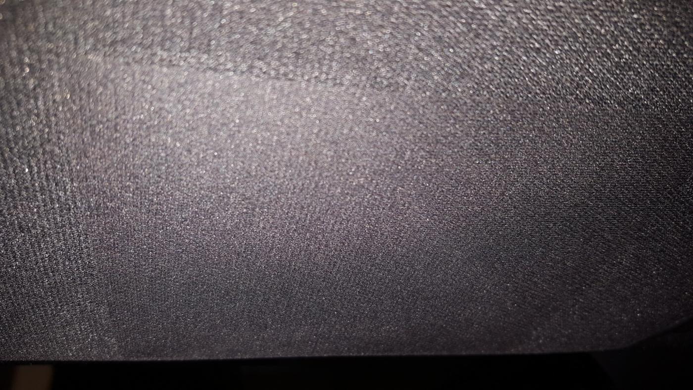

As a perfectionist the huge visor stickers in several languages have always driven me crazy. I have removed them from all my vehicles, and the GT350 has actually been the easiest. Heated a corner of sticker for about 30 seconds with a hair dryer, then used my fingernail to get a very small piece loose (this is the hardest part). Then grasped that small piece with a hemostat and heated entire sticker with hairdryer as I slowly removed it (fingers get too hot if try and hold it with fingers while removing). Very slight marking is left behind from initial install process by Ford, but looks much better than sticker did (the third pic is the finished visor with a blinding Surefire flashlight on the visor, not very noticeable in normal lighting conditions).
On another vehicle the visor material itself became a little loose afterwards, wax paper and an iron fixed it perfectly, but didn't have any problems on the GT350.
