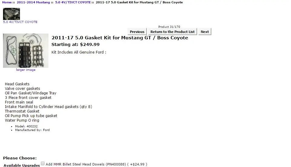

If you go look on MMR, LMR, AM - you will see this kit being sold as 11-17 5.0..

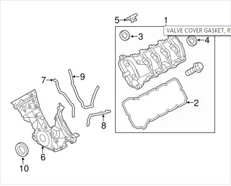

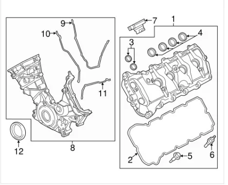

I've provided some pictures.. The ER gaskets look a little different near the front/exhaust side of the head.. And the bolts illistrated look correct vs the BR numbers...
This drawing is associated with #BR3Z6584D,#BR3Z6584A

Now THIS drawing is related to ER3Z-6584-A, ER3Z-6584-B
valvecover12 by Ray Butcher, on Flickr
So - Little bit of a PSA
And has anyone else ran into this ?? The ER coded gaskets show applicable to the GT350, and every F150.. But no mustang... The BR shows mustang...
However, My vin # yielded the result of ER coded gaskets being needed...
Sorry if this is confusing.. Just thought I'd share.
