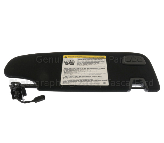

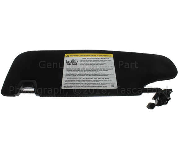

USA are a left and right side P/N
The plastic bracket may come off and be reversed as it has a half circle locator that sandwiches the inner and outer headliner and metal skin.
  • SKU: KR3Z-6304105-DA
  • Positions: Left
  • Other Names: Sun Visor
  • SKU: KR3Z-6304104-AA
  • Positions: Right

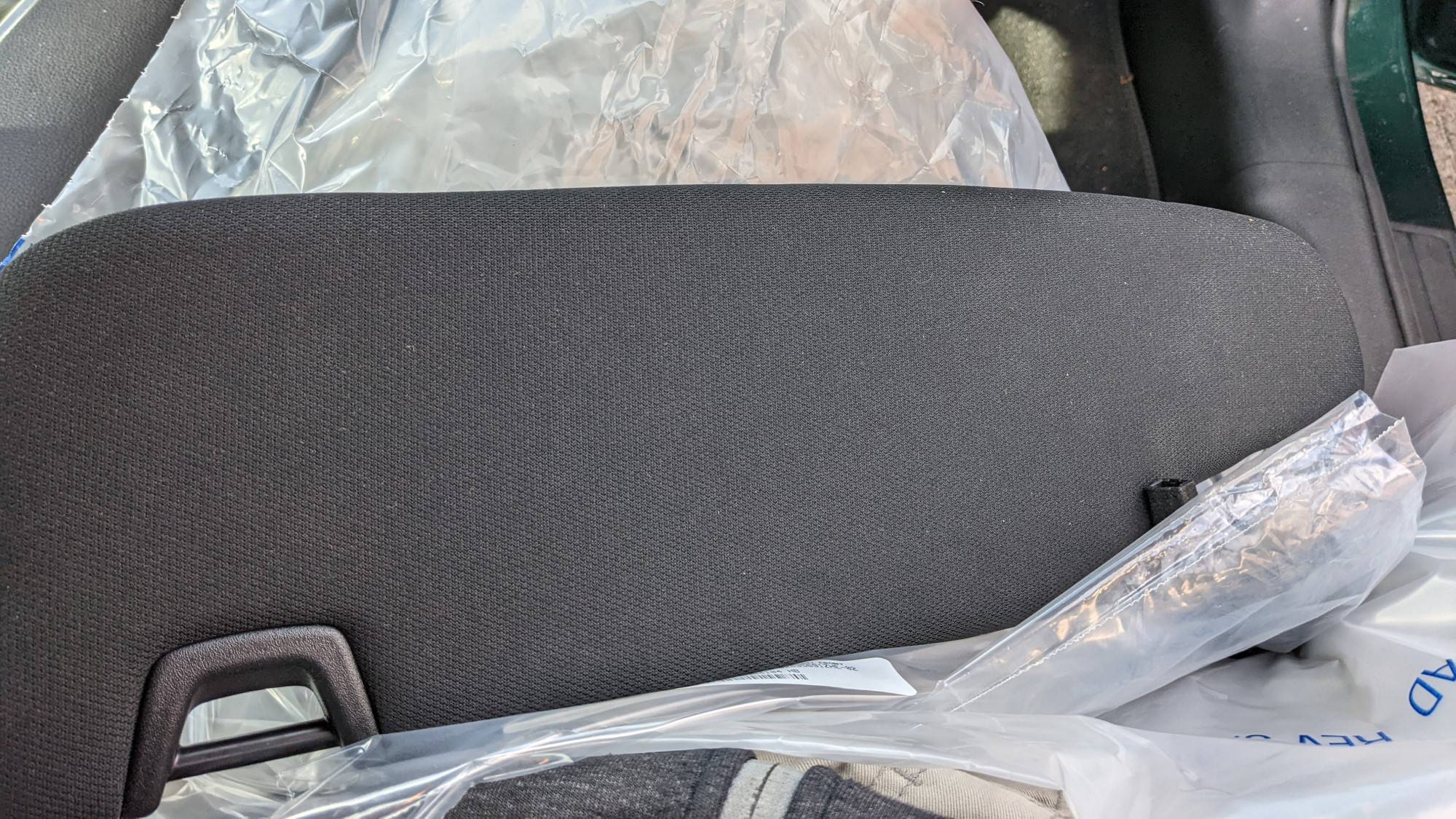

Update!
Another one will follow after installation.
Stock EU LHD right sun visor 🤬🤯🙈
Here is, what I got today with @WD Pro 's VIN 🤘😎
So called "screw cover", first impression is, should be ordered also, because of possible damage/scratching while mounting.

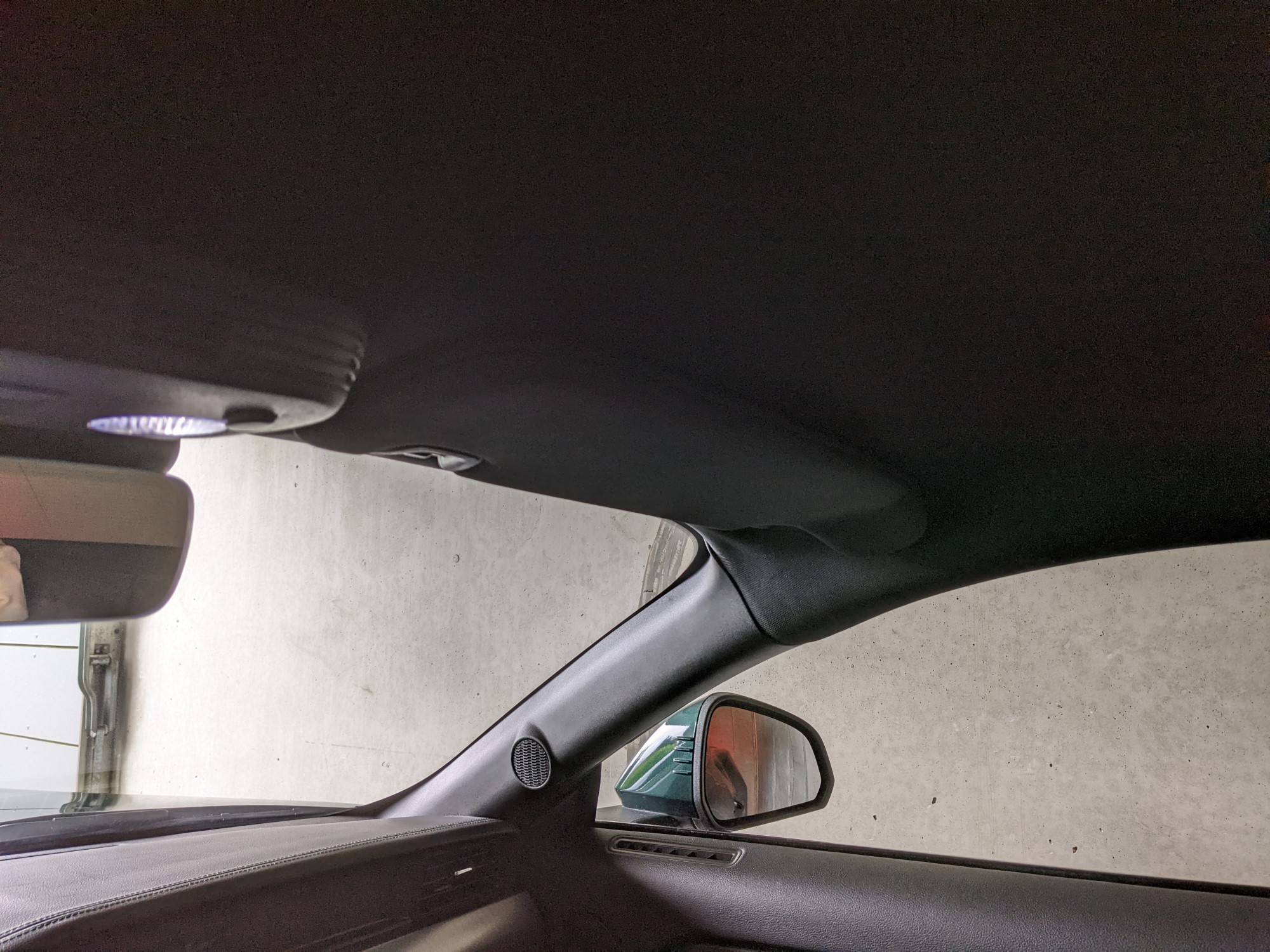

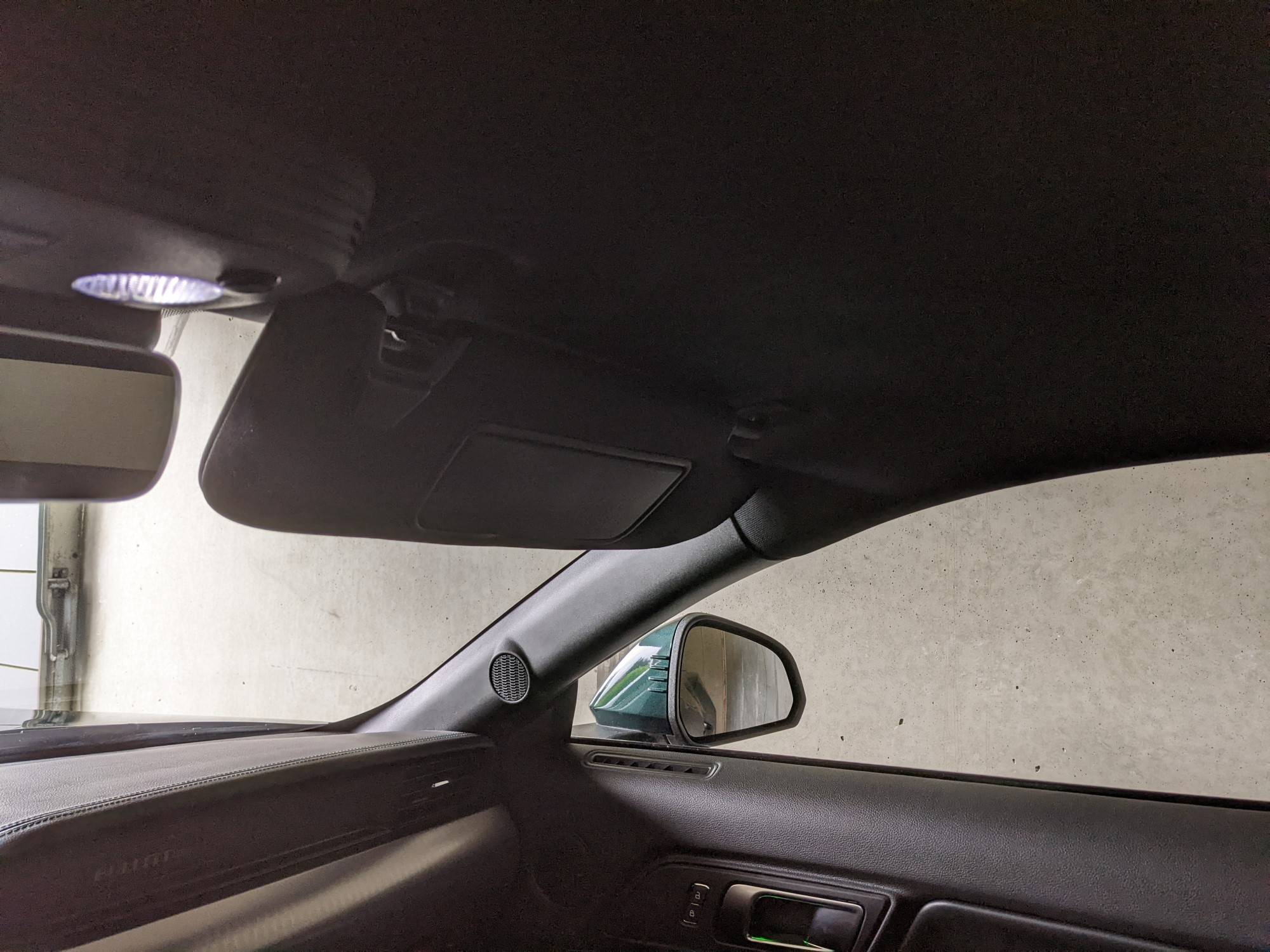

That was a match, mounted it yesterday successfully.
Pictures will follow.
Verified clean passenger sun visor for my 2020 LHD EU Bullitt:
2164070 visor assy - sun (sun visor RHD right, no stickers, no HomeLink)
2080229 cap screw (only necessary, if you damage the existing one; both sides the same)

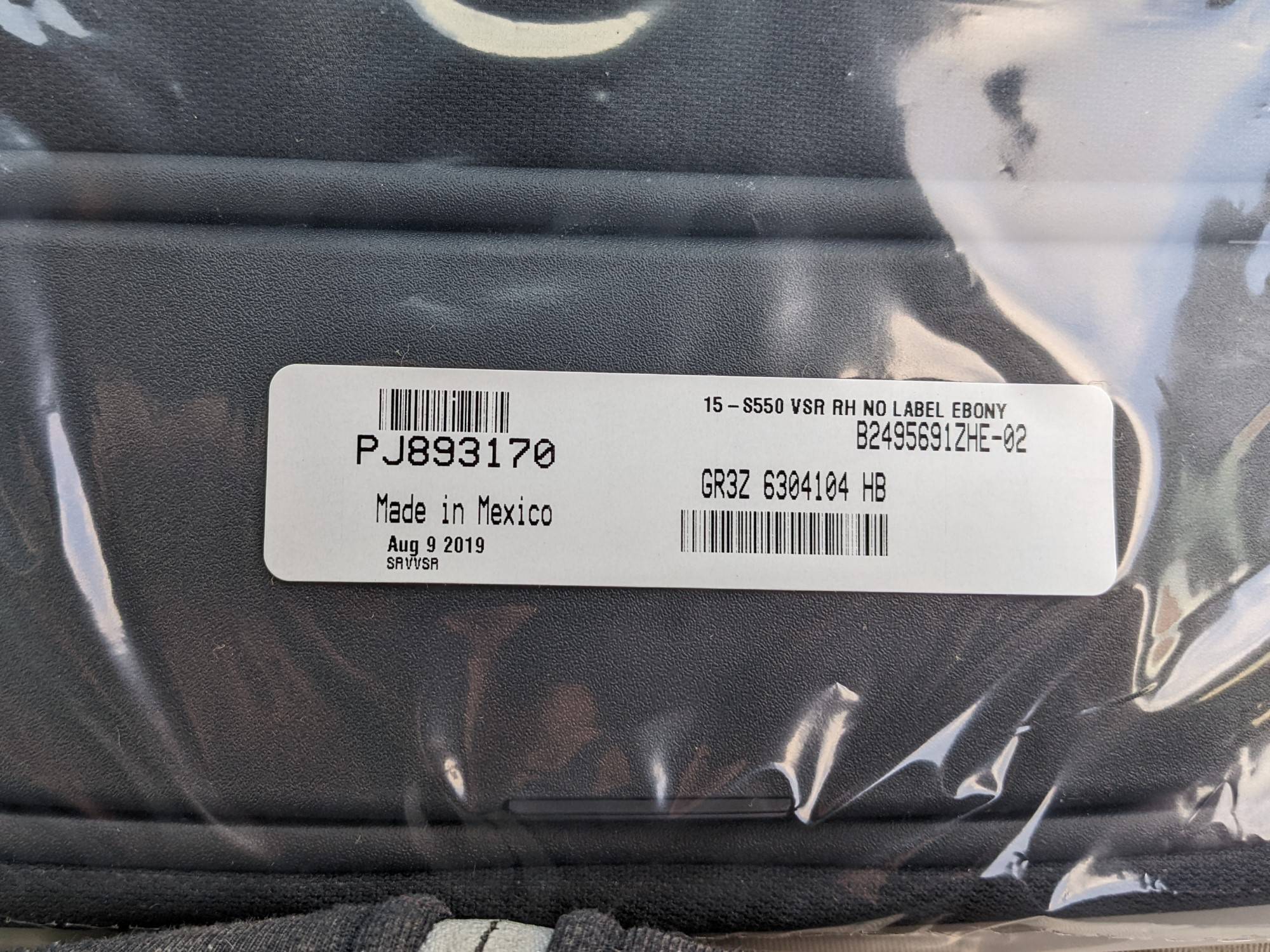

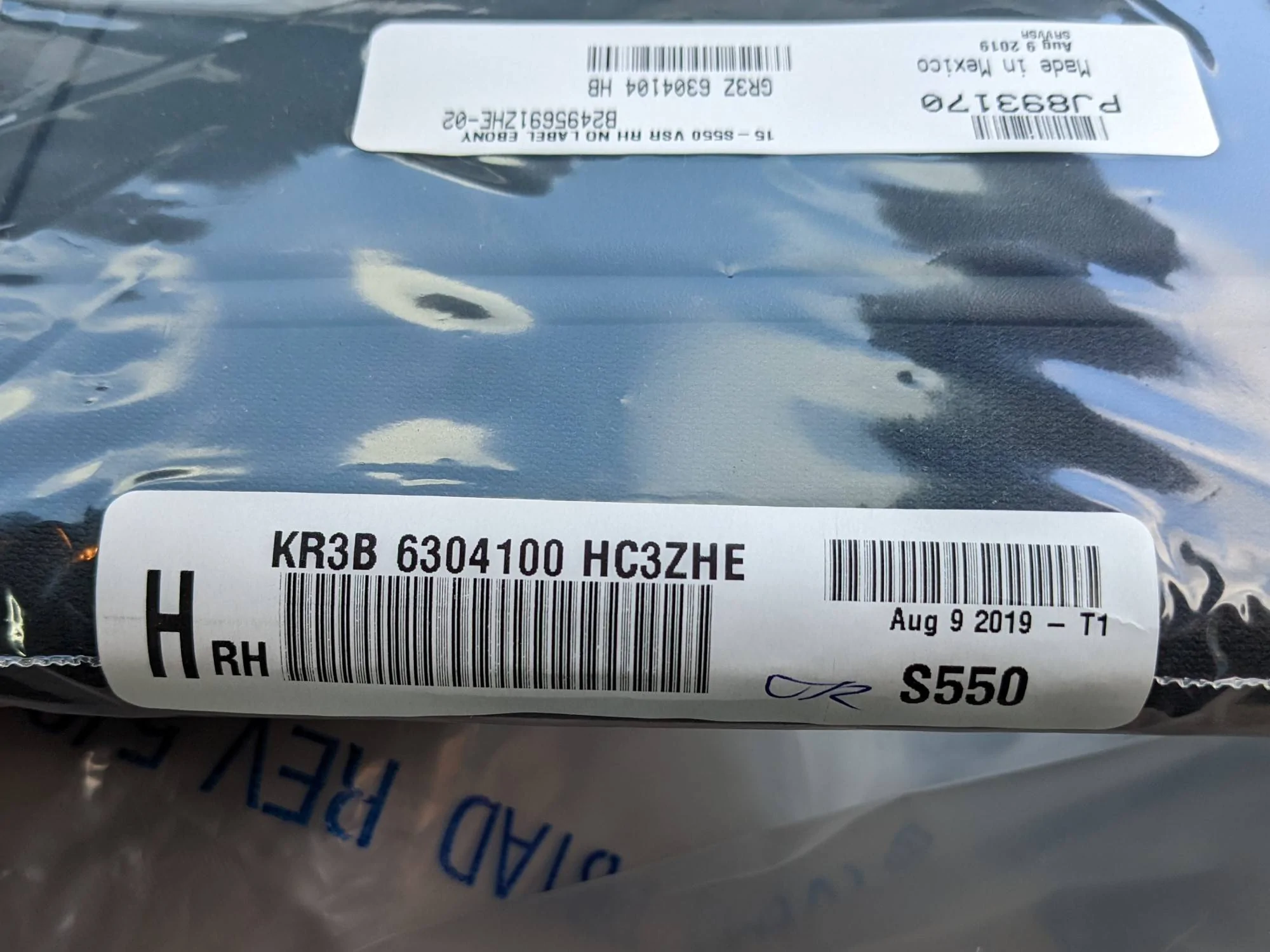

It is conceivable this should work with any 2018+ EU / US, if you want to do without HomeLink.

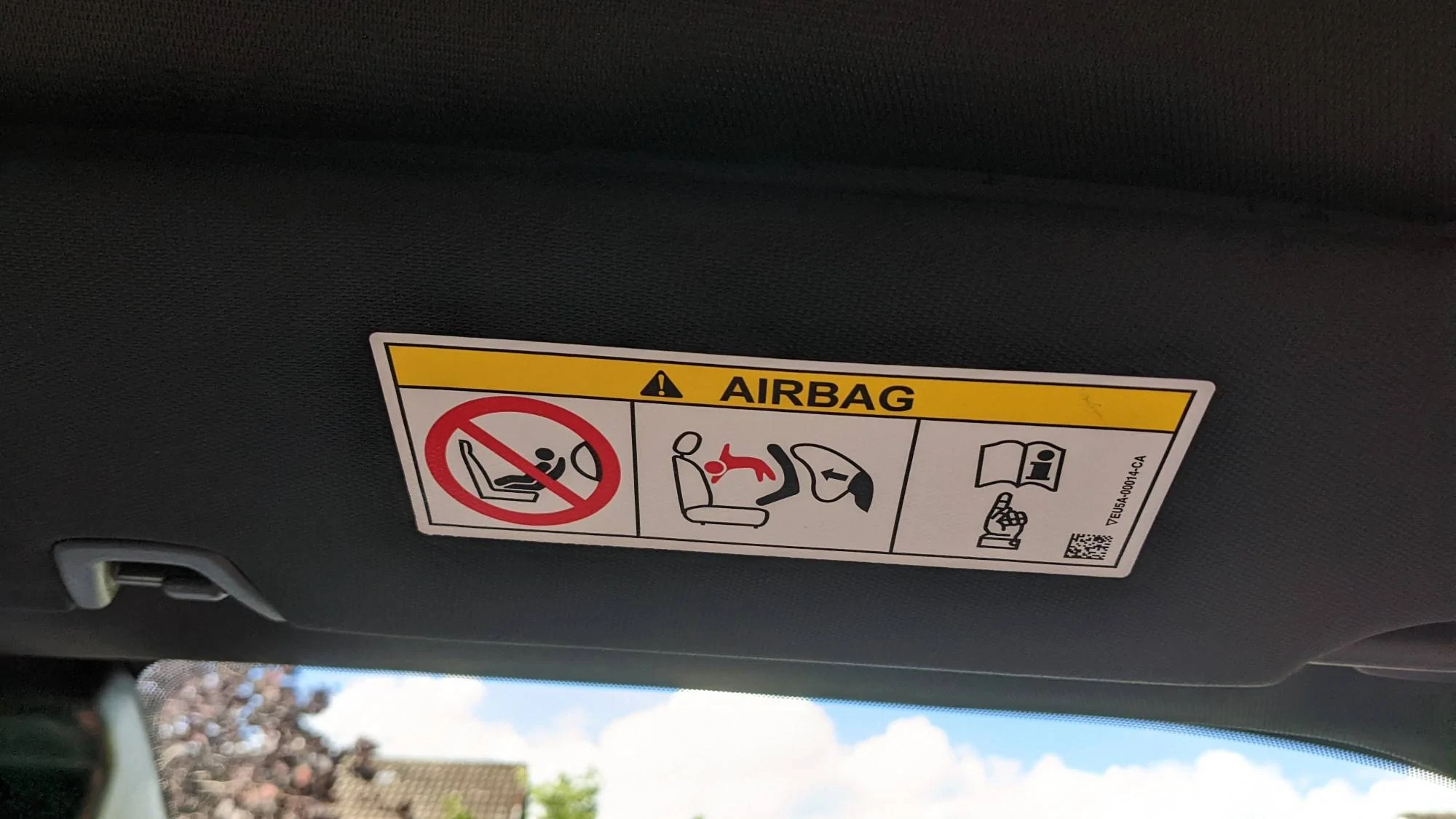

The part numbers for the US market seem to be different, please use the pictures above to determine the correct one, they are present on the stickers, probably the SN number?

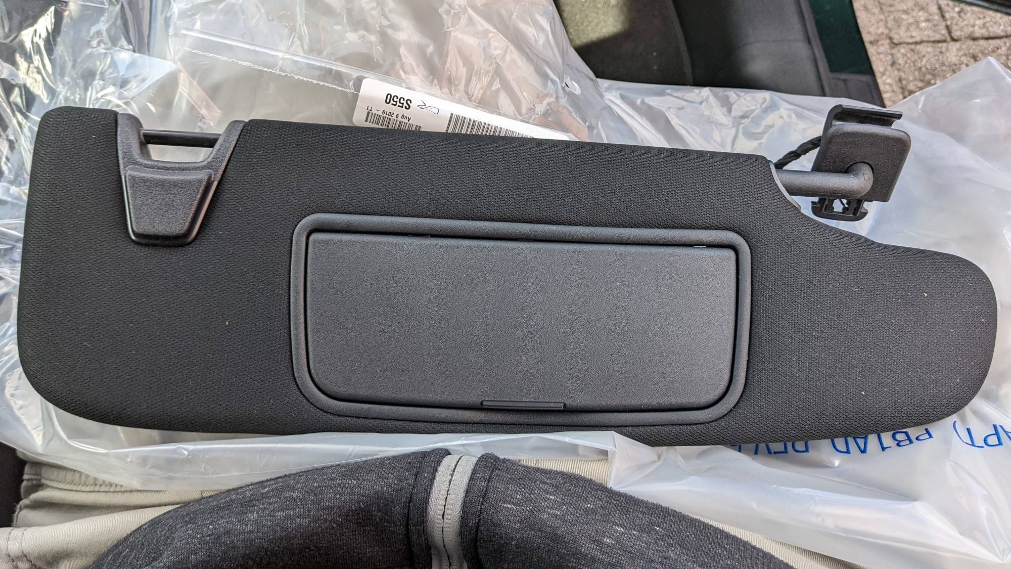

Here finally the promised pictures, almost forgotten...
2013732 / GR3Z-6304104-HB clean RHD sun visor
(The make-up mirror is of course also illuminated.)
