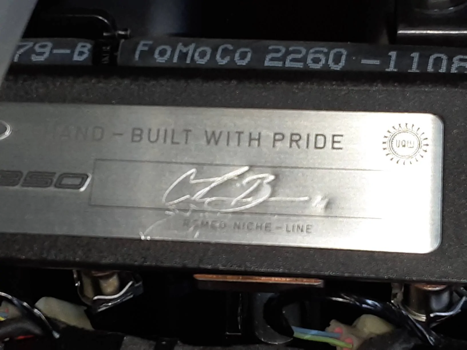

Got it. Thanks Flashstang.Curtis Brunson is the engine, he also built mine. Please see post #169 for Predator Engine builder list..

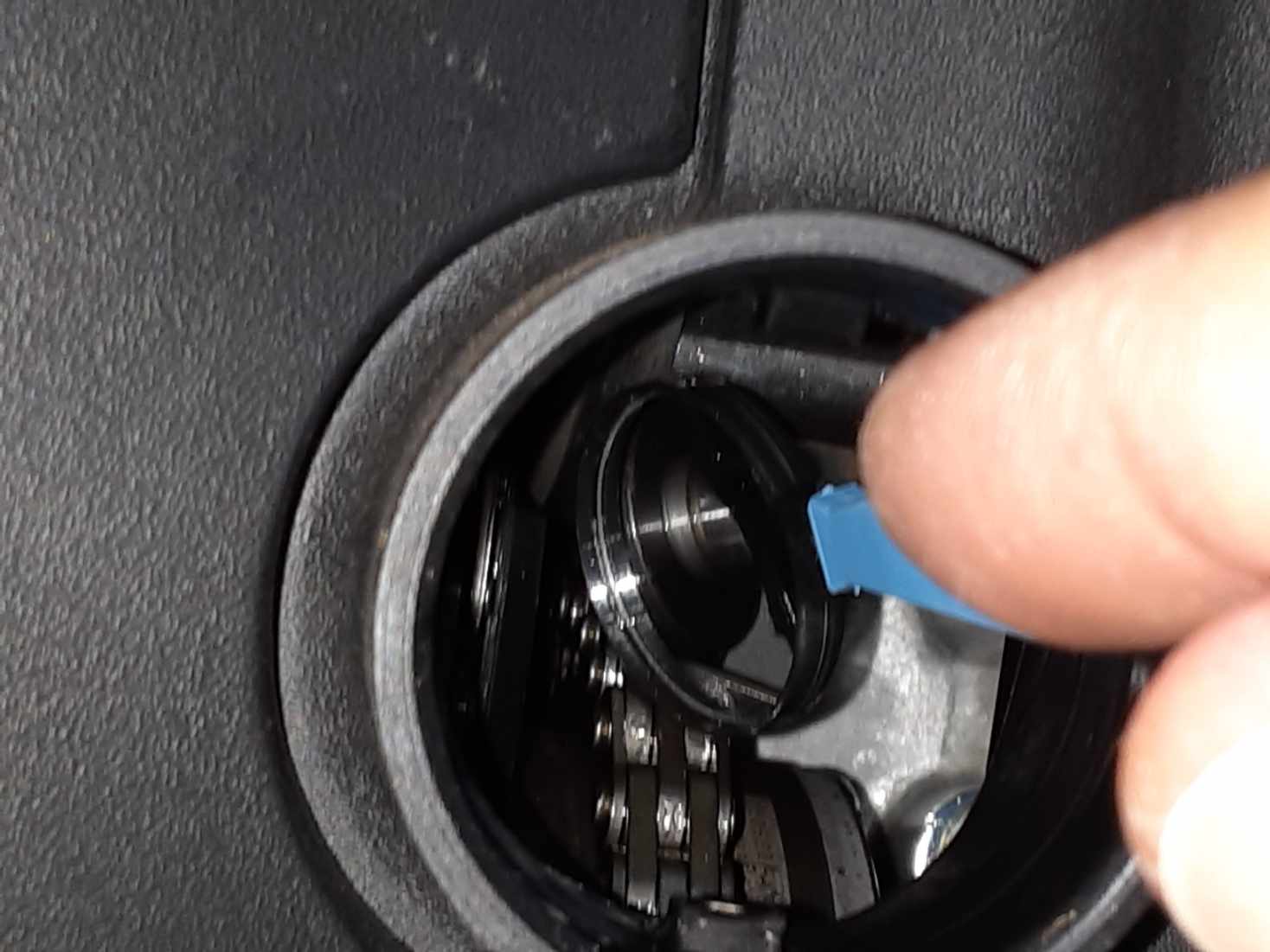

My build date fell within those December dates but I did not get a message on my Fordpass either. Anyways, I checked it myself with a small mirror and can see the groove so I'm guessing I'm ok.Neither has a lot of us. Just do the check yourself for peace of mind with a little mirror.
It's easy.
Nothing on my fordpass either and nothing when I put my vin into the link with Ford.My build date fell within those December dates but I did not get a message on my Fordpass either. Anyways, I checked it myself with a small mirror and can see the groove so I'm guessing I'm ok.
Hello; I think the answer to your question is an open one right now. I guess the thinking is if the one you see is good then the other should be also. An iffy sort of way to look at it, but apparently there is no easy way to check the other side.If you do that then don't you need to check/activate the other side?
Just passed inspection on the activation at the Ford Dealer. Once the tech found the right size mirror took less than 1 minte to check.Hello; I think the answer to your question is an open one right now. I guess the thinking is if the one you see is good then the other should be also. An iffy sort of way to look at it, but apparently there is no easy way to check the other side.
Hello everyone. I think I am good, right? Please see pic. I have an appointment for Thursday afternoon. Anyone know how long this should take for them to check? Do they look at it with a mirror like we have or are there other diagnostics that they run?
Also, anyone know who built my engine? One of those signatures that you can only make out the initials.

Article is misinterpreting the TSB. Here's the actual language:I think it's because the recall is for " improperly installed secondary timing chain tensioners." https://mustangforums.com/articles/ford-recalls-2020-shelby-gt350-gt500/
There may be one or more builders that this applies to......the recall covers the period December 2, 2019 to December 16, 2020 (over a year) but only some of us are getting notified of the recall. Again, maybe Ford has identified that one or more of the builders didn't properly activate the tensioners. This would also explain why the TSB says to check one side (the easy one) rather than both.......maybe the assumption is that if the builder did a proper install on one side they also did it on the other.
