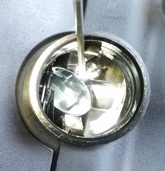

Hello everyone. I think I am good, right? Please see pic. I have an appointment for Thursday afternoon. Anyone know how long this should take for them to check? Do they look at it with a mirror like we have or are there other diagnostics that they run?

Your's is definitely good. As for how long it takes them, just as long as it took you. They check it the same way with a mirror. If they see it extended, that's it. If not, then they have to turn the crankcase some and check. Read the service bulletin in the first post explaining what they're to do. It'll take you longer waiting for them to take your car in, then it will be to check it out.

Thank you for your reply. I guess the picture kind of sucks. About 95% sure I can see the groove. Maybe I will try priming the engine to see if the tensioner sticks out further.
