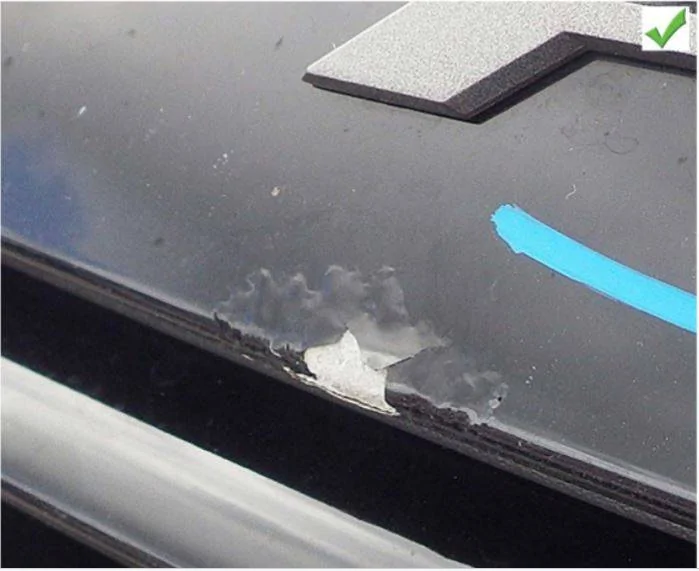

TSB 19-7033 says:
Corrosion (Warrantable) Steel and aluminum corrosion shown in Figures 23 and 24. See the Warranty and Policy Manual for extended coverages.
You have a 2016, so surface corrosion on an aluminum panel would be covered under the 5 year warranty as explained before in his thread.
Look at Figure 24 ... pretty much what the aluminum hood corrosion looks like without perforation.

I have a 2016 GT and my hood was replaced per the TSB with no hassles. This was done last month. My car has 44K miles.

My dealership told me they would have an answer to the claim they submitted by the end of the day which was a Friday. They did have an answer, but the service manager got busy and forgot to call me. He must have had confidence that Ford would honor the claim because he ordered the new hood before submitting the claim.

How bad was your bubbling? Mine is barely noticeable, but obviously there, and is underneath my PPF. It's nothing like that pic. I only have 14.5k miles on the car.

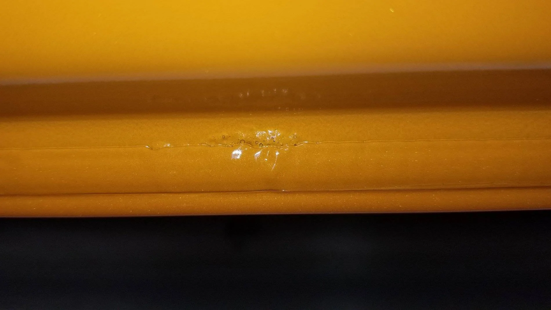

This as bad as mine got. It's a 2016. When I first saw this I was surprised to see it. I've seen this in Ohio where cars rust from road salt, not in SoCal.

It's caused by bad manufacturing process that apparently gets either moisture and/or contamination between the the two pieces of sheet metal (aluminum) at the seam. It's not caused by any kind of road salt or other environmental conditions.

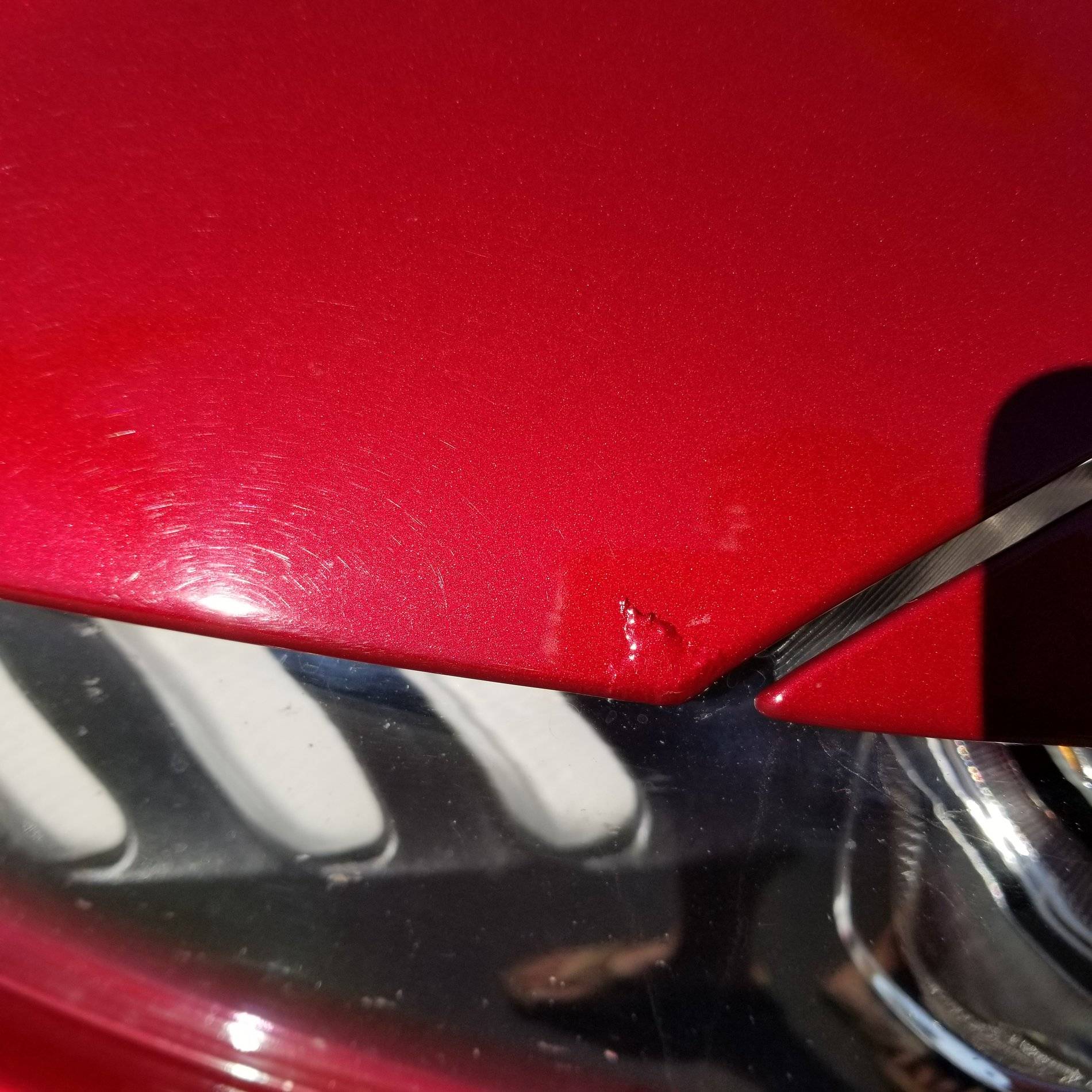

2019 Orange Fury owner here... My car was made in April 2019 so it is only 13 months old and this is what i found under the hood. This adds to my 2017 Explorer which also has the same issue. The dealership said I can get a new hood no problem but I JUST got the whole hood covered with PPF for like $1000. What the hell for? I'm so frustrated. 19 years and millions of cars and ford can't figure out how to keep the panelscpanels when painting? I almost don't want to get it fixed and just buy an aftermarket hood, and what makes this worse is, orange Fury is a triple layer paint and I have over the top racing stripes.... FML
