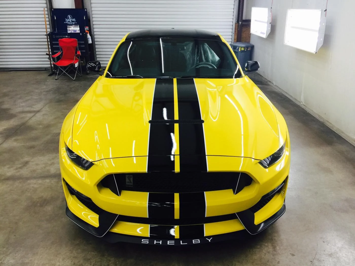

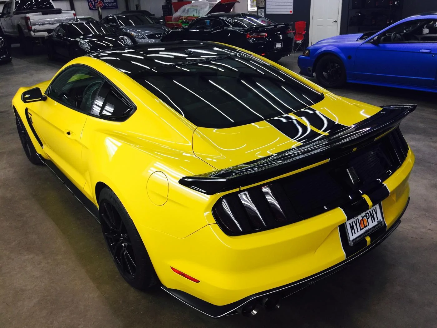

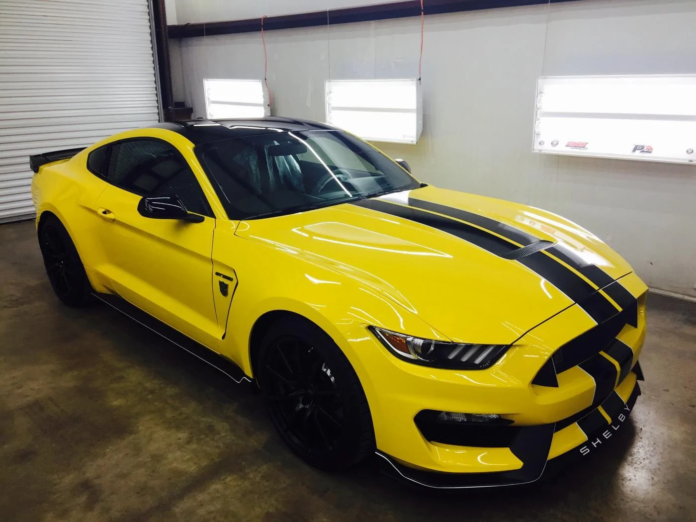

What did it cost you to have the whole car done? and how long did it take?

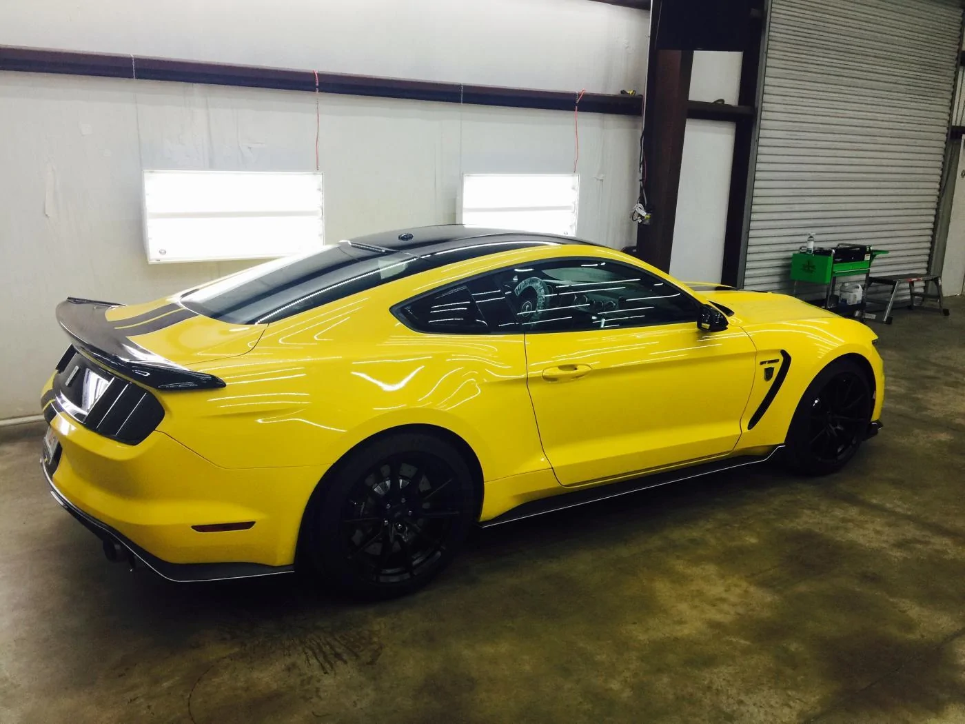

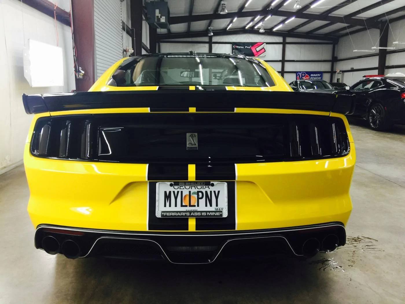

There's 20-30 hrs of work with the paint correction and all. They usually want the car for a week. Shop pricing usually ranges from $1000-$2000 depending on the brand and warranty. I went for the lifetime warranty and was somewhere in between.

Never had any issues with it staying on the rear or front pieces, washing, driving etc...The only issue with the side rocker striping is hitting it with your foot getting in and out...after having to redo them a couple of times you train yourself to be careful.
The nice thing now, is the Ceramic is over the top and adds more protection. I will still be careful, but I think if I did scuff it with my shoe the Ceramic would protect it.

Yes...mine are textured the same as yours. It's a '16 tech pack. Can't use the cheap Autozone crap.
I ordered the 1/8" 3M pinstripe. Sticks fine. It's soft enough, that when you rub your finger over it when applying it conforms to the texture.
You need to apply it before the Ceramic, vinyl won't stick to the 9H. Ceramic Pro makes a formula that they use on drag and race cars that still allows for vinyl stickers to work, but it's not the lifetime 9H.
I'm surprised I haven't seen more people pinstripe. I think it looks awesome. I had yellow at first. But after I scuffed the rocker, I tried the white and thought it complimented the white on the main stripe and it popped a lot more.
