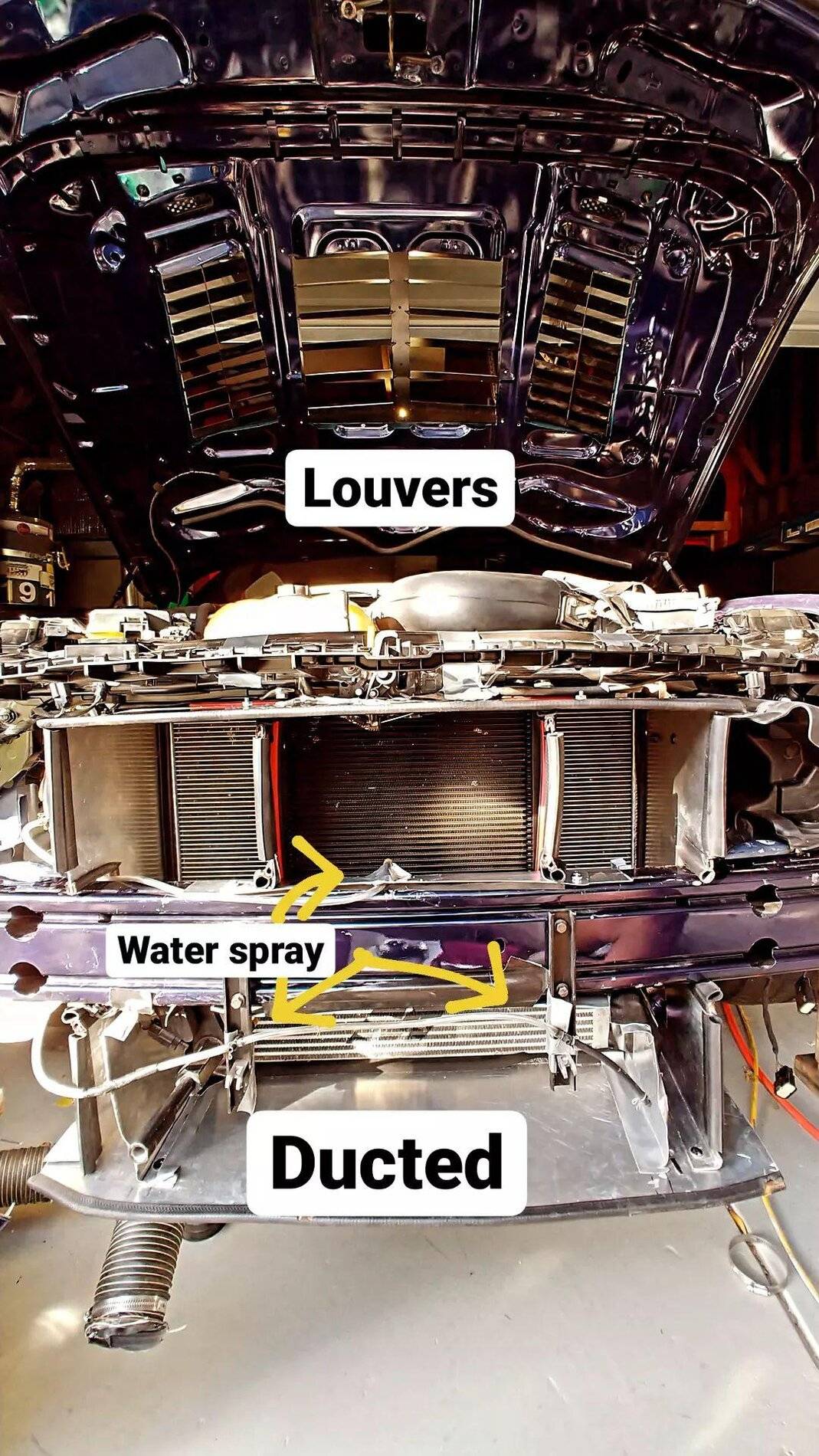

Alessandro,Oil cooler is a must. Also remove heat from the little boiler of your OEM system.
Use water watter too dont forget.
Oil. I did nonissue 5w50 in summer (in california woth 110f) i do feel 0w40 is a better combo also to reduce drag. I also use MOTORKOTE as friction reducer \protection. Go 0w40. Pressure should be around 80psi or moe on WOT. it is normal.
