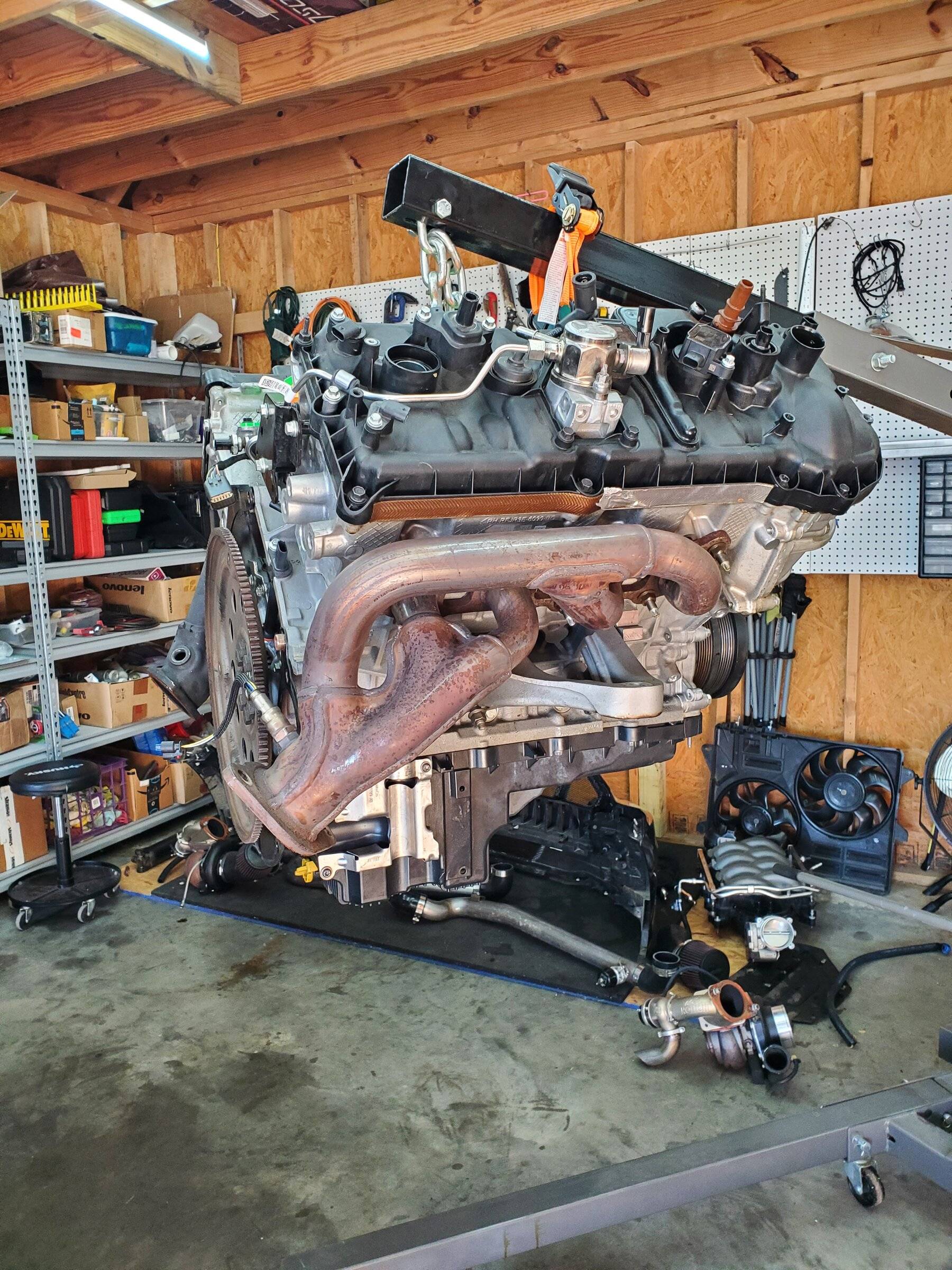

Well here is my progress.
Cylinder 7 and 8 were like 140psi and have some marks on the Cylinder wall. Getting a lvl3 rebuild from RPG. Hopefully will be back together in 2 months.
Went ahead a got a boost controller, fuel pump and boost a pump
Hopefully, Will has all the parts. My Lvl3 took closer to 5 months. Waiting for the MLX head gaskets & studs. I’m not sure I’d run a BAP on a 11k shortblock. Get a fuel system if you can swing it
