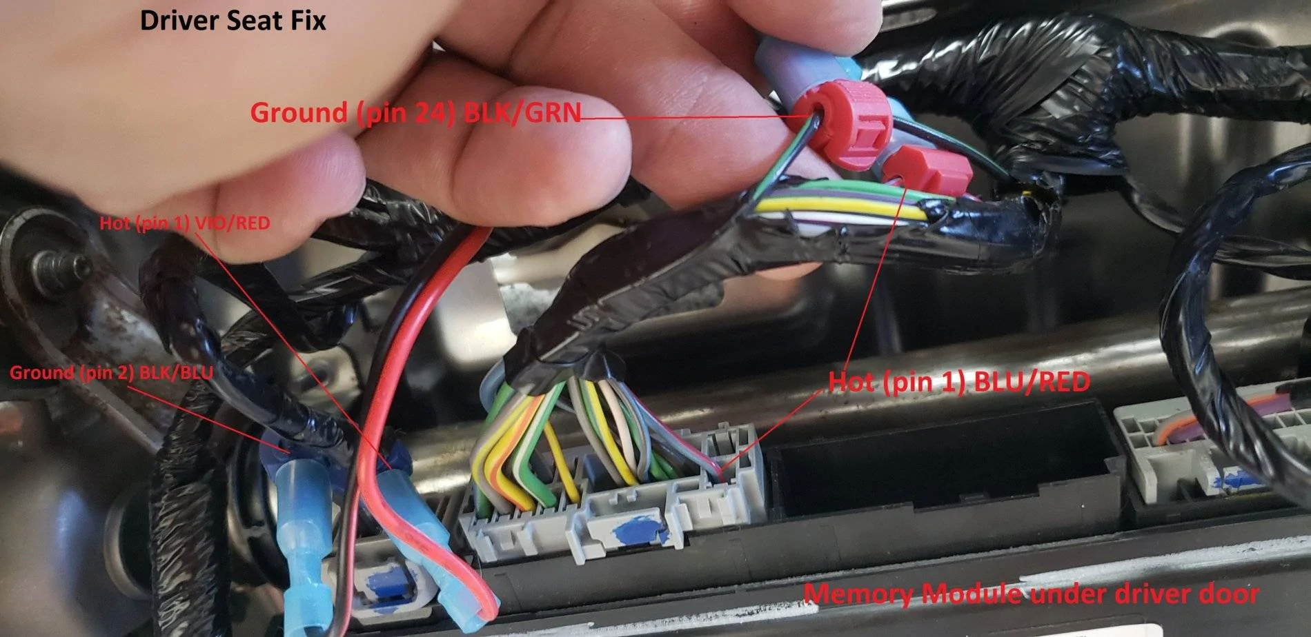

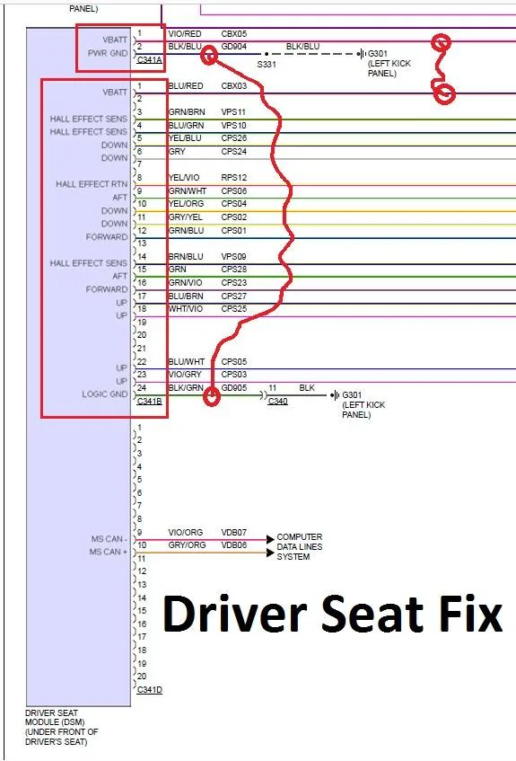

    If you swapped your base cloth seats with premium leather and have the issue with driver seat doesn't move, here is the fix.
    Power (hot/ground) for base seats goes to the POWER SWITCH directly.
    Power (hot/ground) for premium seats goes to the memory module under driver seat, then the module feeds the POWER SWITCH.
    You basically need to make that connection/tabbing, so power flows to POWER SWITCH and you would cancel the memory module.
    Here is some pics and diagrams (also in PDF) to explain. Let me know if you need more help.
    This fix will not only make the seat move, but will also make it slide back when you turn off the car, and slide forward when you turn it on. Which makes it easier to go in/out of the car.

    It is not as complicated as you might think. It will however involve some wiring with the new module and lock/unlock switch since you will be using new connectors. Still totally doable.
    If you print the wiring diagram in the PDF above and look at the wiring, you will figure out the wiring.
