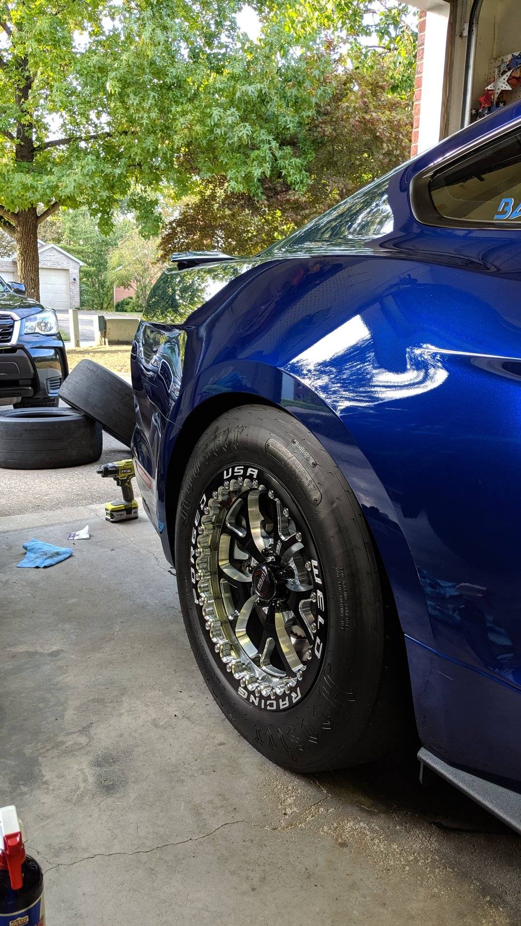

Yes all nannies off. I haven't had a chance to do a full pull with the added power and the ET Street R's yet due to the weather here. I'm hoping at 55mph and 26psi on the street that they will hook for me with my 3.73 rearTraction control and Advanced Trac off right? I have 305/45R17 ET-R's @12psi and I can't get them to hook until about 50-60mph. I'm going to a 325/50R15 ET-R now and we'll see if it helps.

Agreed. That's why I kept asking if that's with the nannies on lmao. I've ran 3 different sets of tires and settled on the ET-R's for the time being. I plan to likely go to a hoosier slick for those fun outings, but at 800+whp it's tough to get anything to dead "HOOK"People have a varying definition of "hook"....

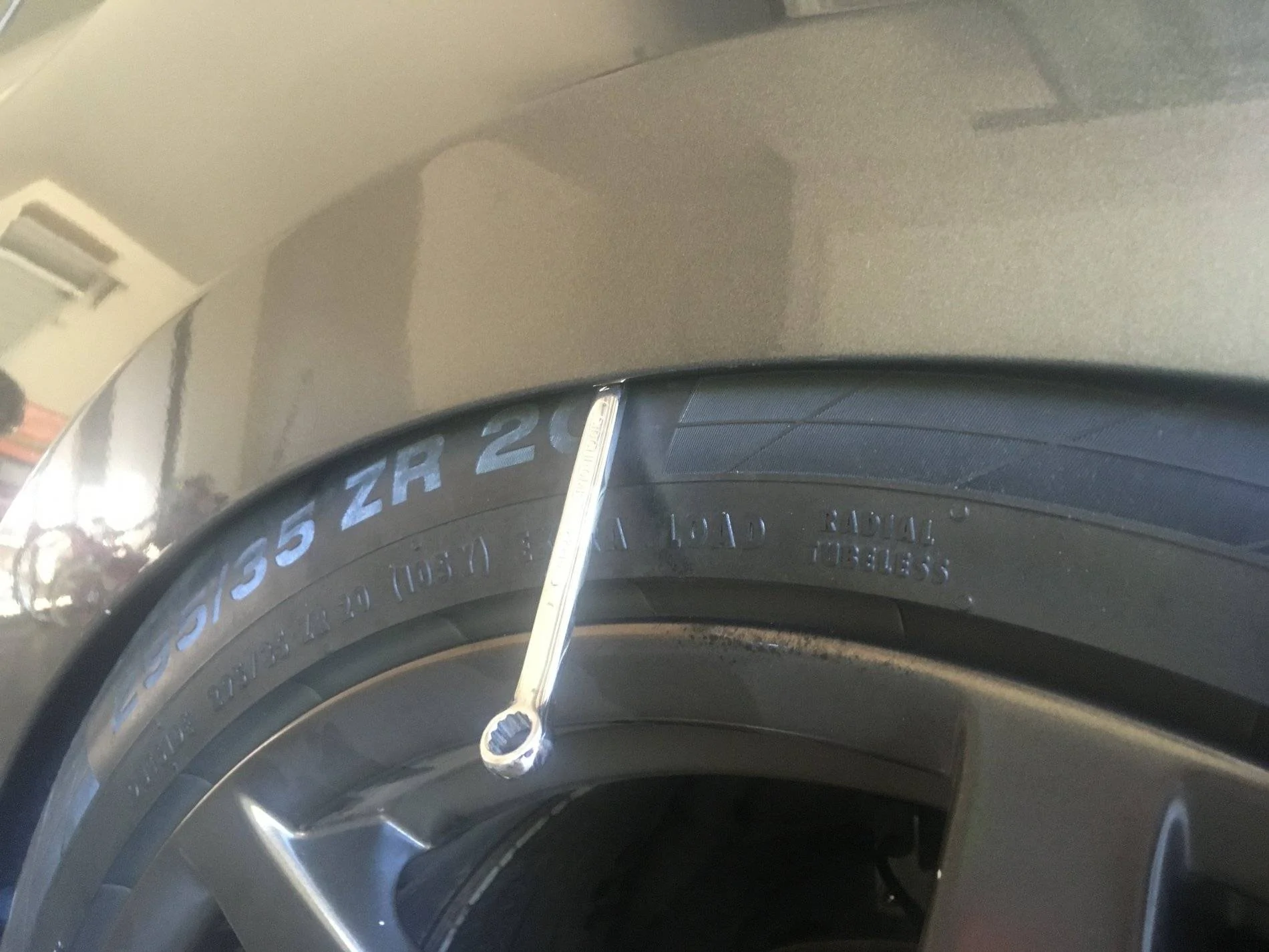

This is an 11” +50 running a 295/35/20. IRS subframe is dead centred, spherical bearings and Delrin everywhere also (no play).
-2.2* camber at ride height.
Pictured is the available clearance at the point where the bumpstops start to come into play, which happens to be about 1” of tyre travel. (It’s 3.6mm for those playing at home)
Now, I’m not saying you can’t increase the width of the tyre by 15mm (per side) but, you’re going to have to think very carefully about your selection of wheel offset or add more negative camber if your existing offset doesn’t work.
I’m fairly certain that most guys on springs haven’t actually bothered to lower the car without the springs fitted to find out exactly how much clearance they really have when the wheel goes to full travel up into the wheel arch.
Now, I could be wrong, but I’m guessing that a decent fender rub is only a decent pothole away on plenty of the setups people are using.
YMMV of course, I’m just putting it out there so people can hopefully avoid a pitfall (or pothole).
