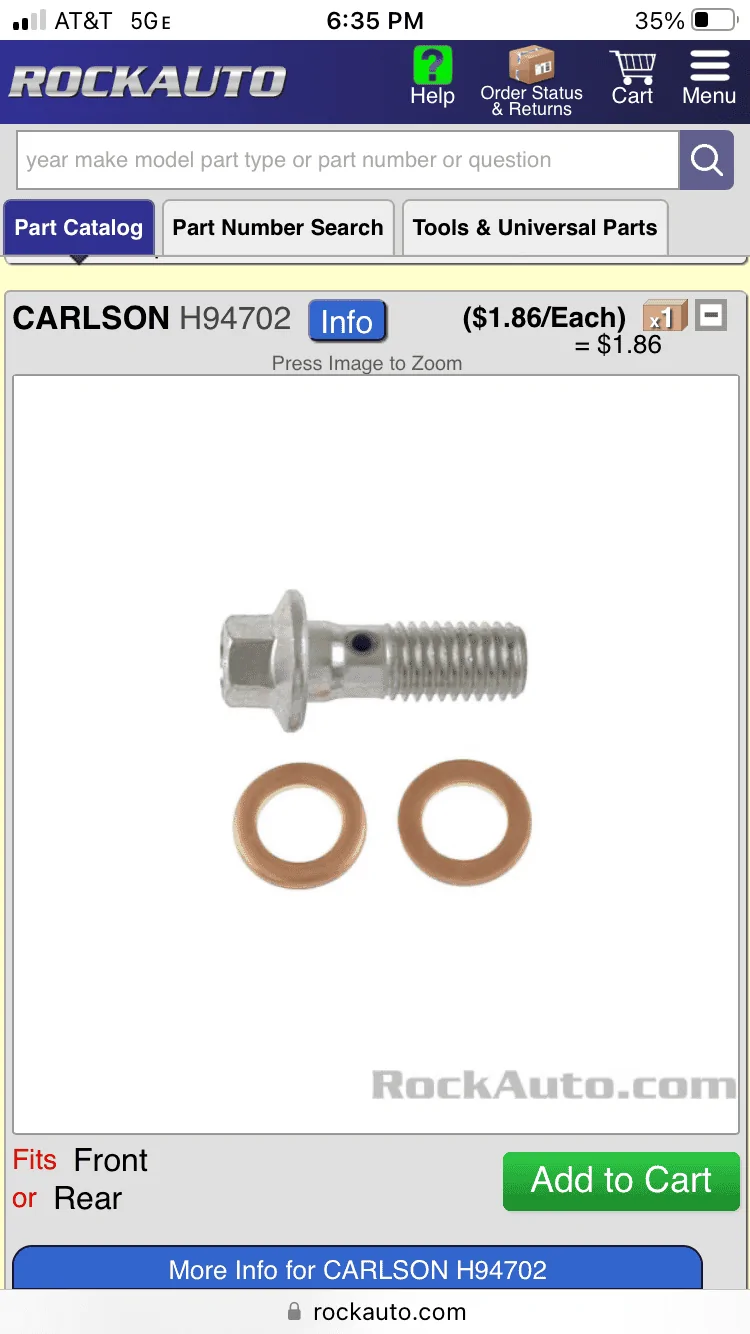

reviving this thread. Does anyone know how to stop the banjo bolt (oem pp1 brembos) from leaking? I replaced the 4 copper washers and have tightened it way beyond the 30 nm torque spec, but it’s still leaking.

CRUSH washers or copper COLORED washers that don't actually crush?
Actual copper washers. Any harm in torquing it a bit more? I am sure I have torqued it good amount.
I would examine the washers and the mating surfaces. There is something wrong that it's not sealing and cranking on the threads you're tempting stripping them, which means you'll need a new caliper.

start with a new banjo bolt and washers and see what happens.
if that doesnt work, try a new brake hose.
id avoid overtightening it

The solution was to stack the parts in the correct sequence.
Over-torquing a banjo won't make it seal. It needs to be replaced and used with new crush washers.
It’s fine bro. It was my bad. All good now
