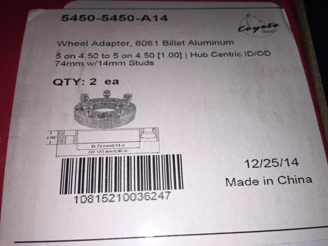

Well, they are made in China :crazy:
I'm sure that explains those screwy instructions. Now on second thought, calling them for recommendations might not be such a great idea. This can be reasoned out with common sense though.

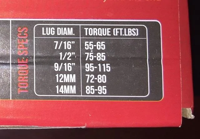

Wheel adapters are sold with low profile open ended lug nuts so they can fit under the wheels. So those nuts they provided logically hold the wheel adapter to the hub. They actually almost got mounting the adapter to the hub correct. In step 4 on the back of the box they say, "mount the Coyote Wheel Adapter onto the vehicle's studs until it sits flush with the rotor's flange. Install the factory (or aftermarket) conical seat, open end lug nuts (not included with this kit) (This is the part that is obviously incorrect). Tighten all lug nuts to 30 ft.lbs. using a star pattern tightening sequence, then torque the lugs to factory specifications (see chart, side panel) (If they left that part off, it would have been correct) using a torque wrench, following the same star pattern sequence.
Then step 5 they screw it up by saying to install the nuts provided with the adapter to install the wheel but correctly tell you to use the torque specs on the side panel (pic above) to install the wheel.
LOL, I see how it's confusing if you aren't already very familiar with wheel adapters. Lesson here, don't buy Chinese junk. The only reason I bought these is they were the only ones I could find on the market when I bought them. Now there are several to choose from.

Just took my wheels off again this afternoon with no problems, adapters were still solid at 120 (no movement on the nuts at all) and I put the wheels back on at a much more conservative ~110. I figured since I already did 150 a few times that I'd go a little higher than spec in case I stretched them at all. Still went on snug, went for a drive, still tight.

That said, I don't know off the top of my head what kind of lug nuts they are. From the pictures, they look like M14x1.5 cone seat open lugnuts. I can't recommend any in particular, as I have no experience there.
