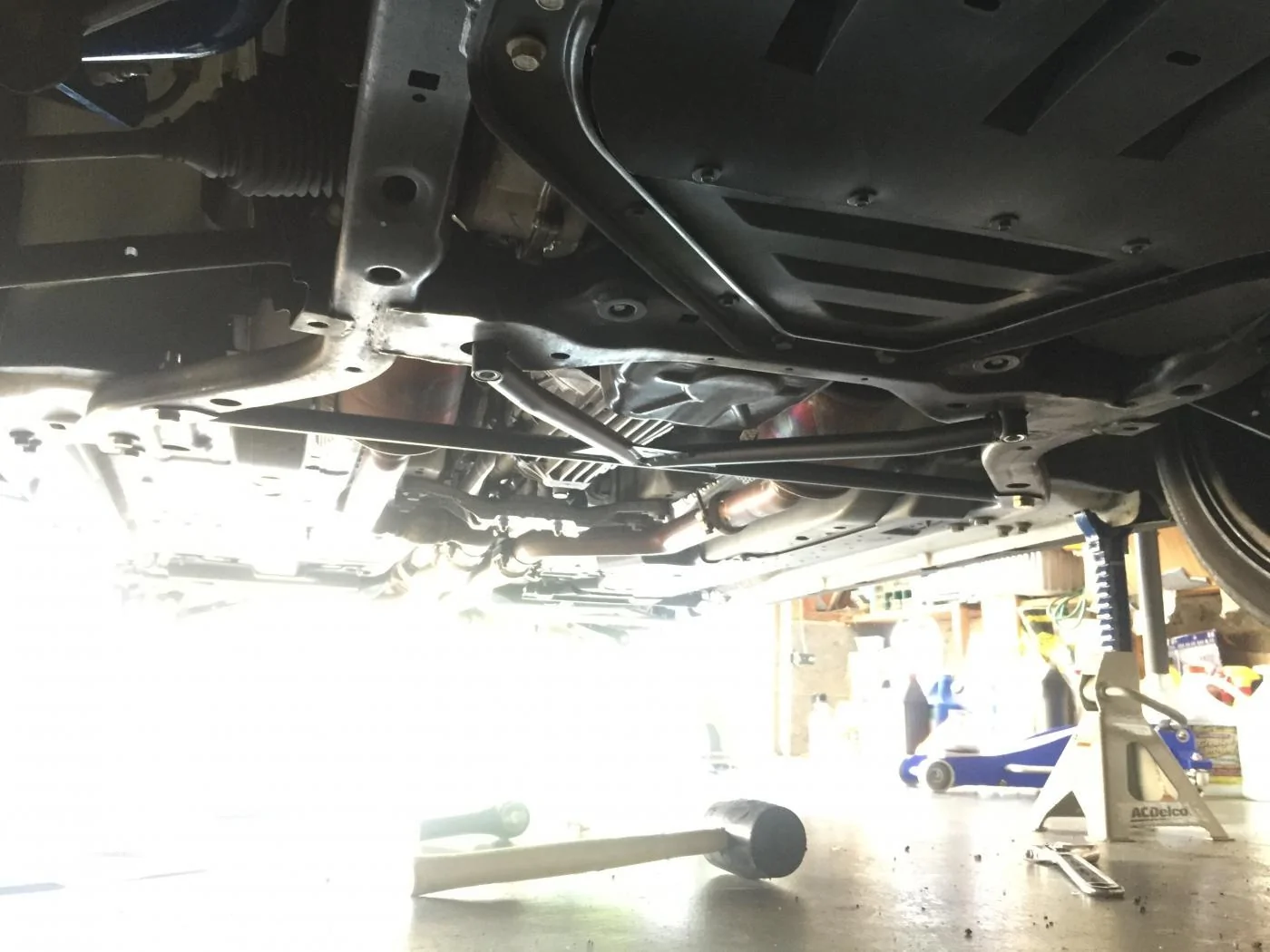

Steeda then came out with the game changer, Differential bushings. Three different types and all reversible and interchangeable.
The install was kind of a b#$%. Had to take down the exhaust and subframe braces for clearance and the fuel tank was in the way. With out those complications the install is absolutely straight forward. Im currently running the black bushings which is the performance ones. This change the overall feel of traction. I was able to catch easily and just gave me a much more settled feeling. the car did gain a tiny bit of NVH but you won't find any setup for differential bushings with less NVH than these.

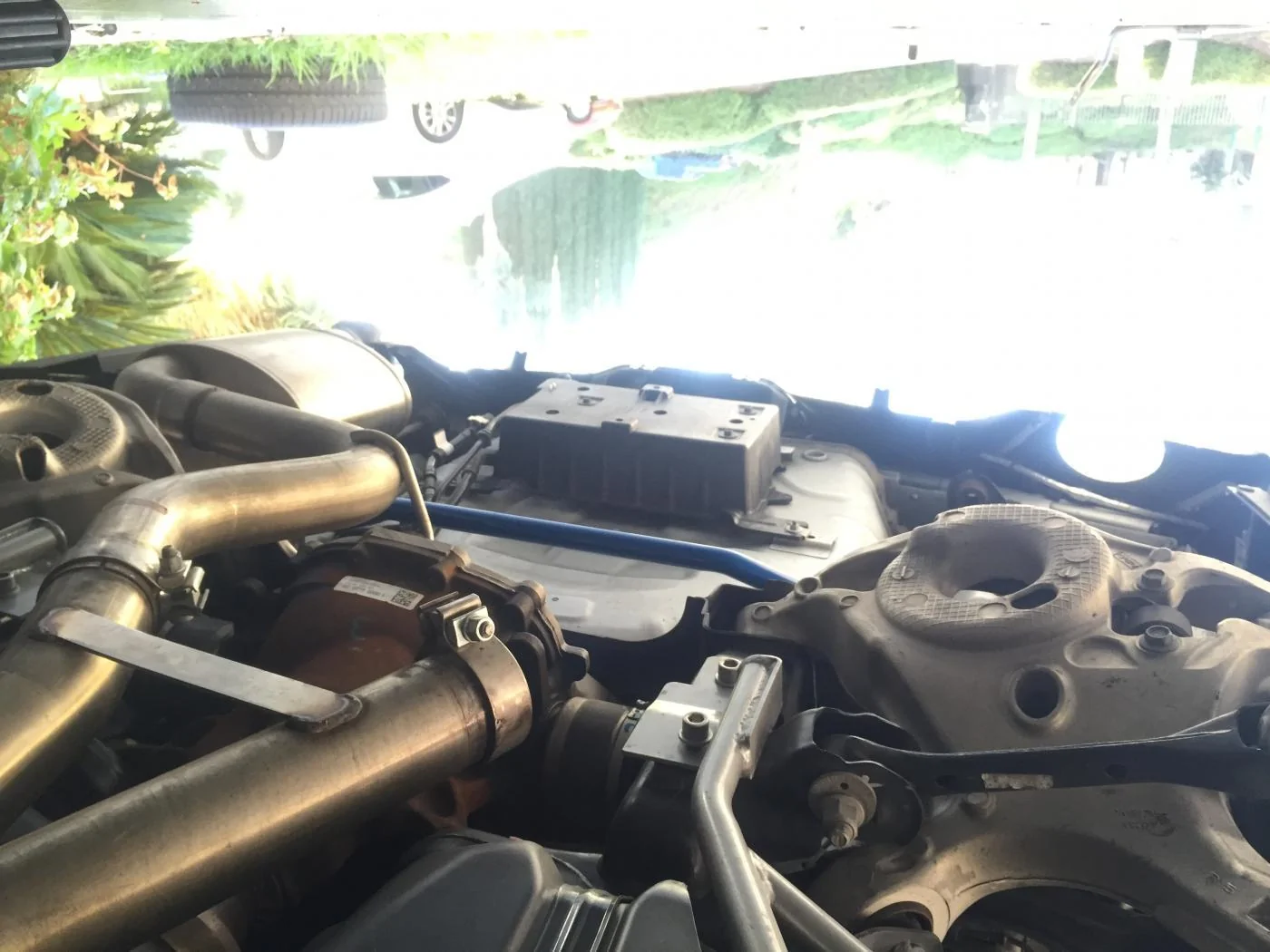

G-Trac K member, unfortunately I did not get to test this on its own. I installed a bunch of stuff at once. I did however install this first on 1g4my2g and he definitely enjoyed the extra rigidity from the brace. One thing you can consider about this is the stock perf. pack comes with its own brace. One you have to eliminate if you ever get a Roush Blower of some sort. Like i said before having all the components together has created a solid feel in the corners.

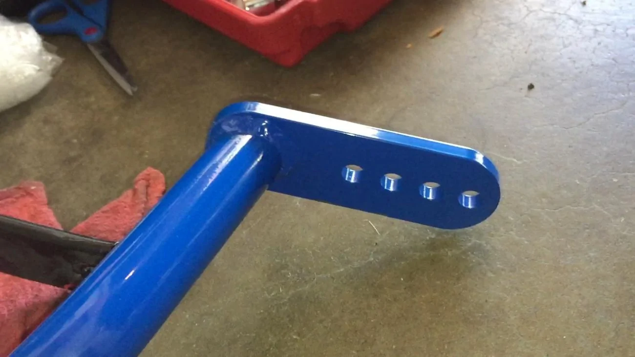

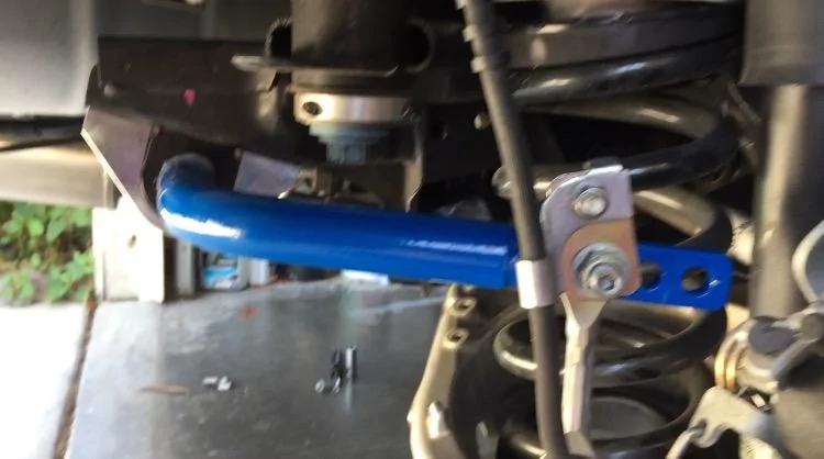

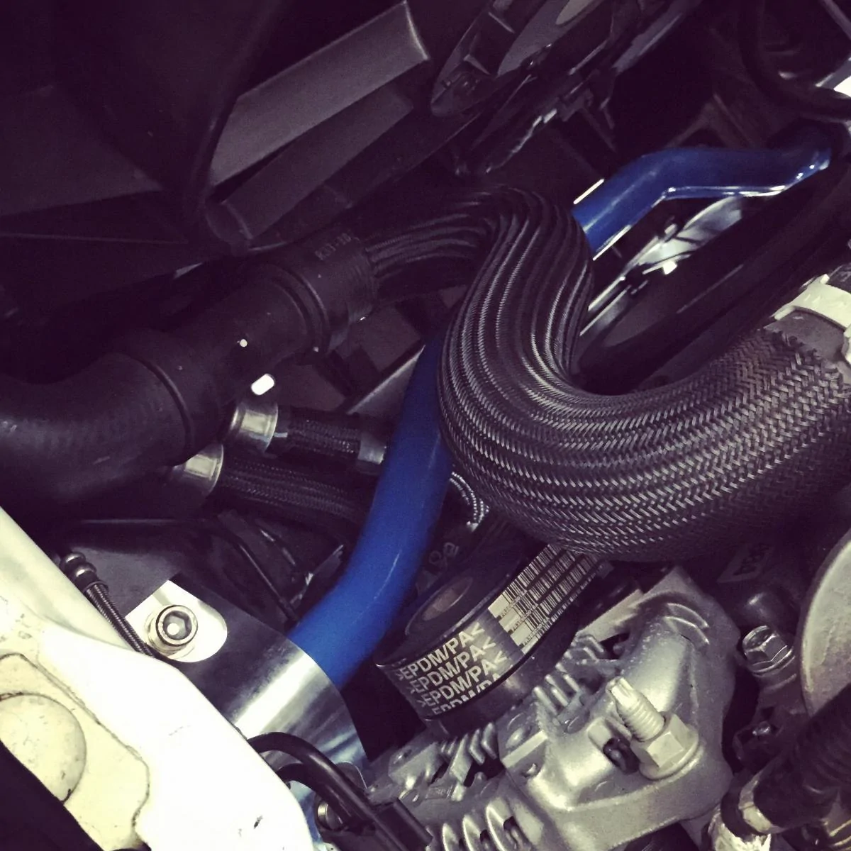

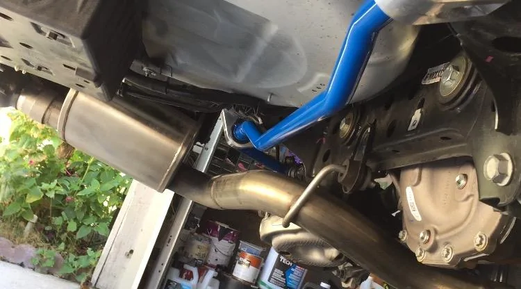

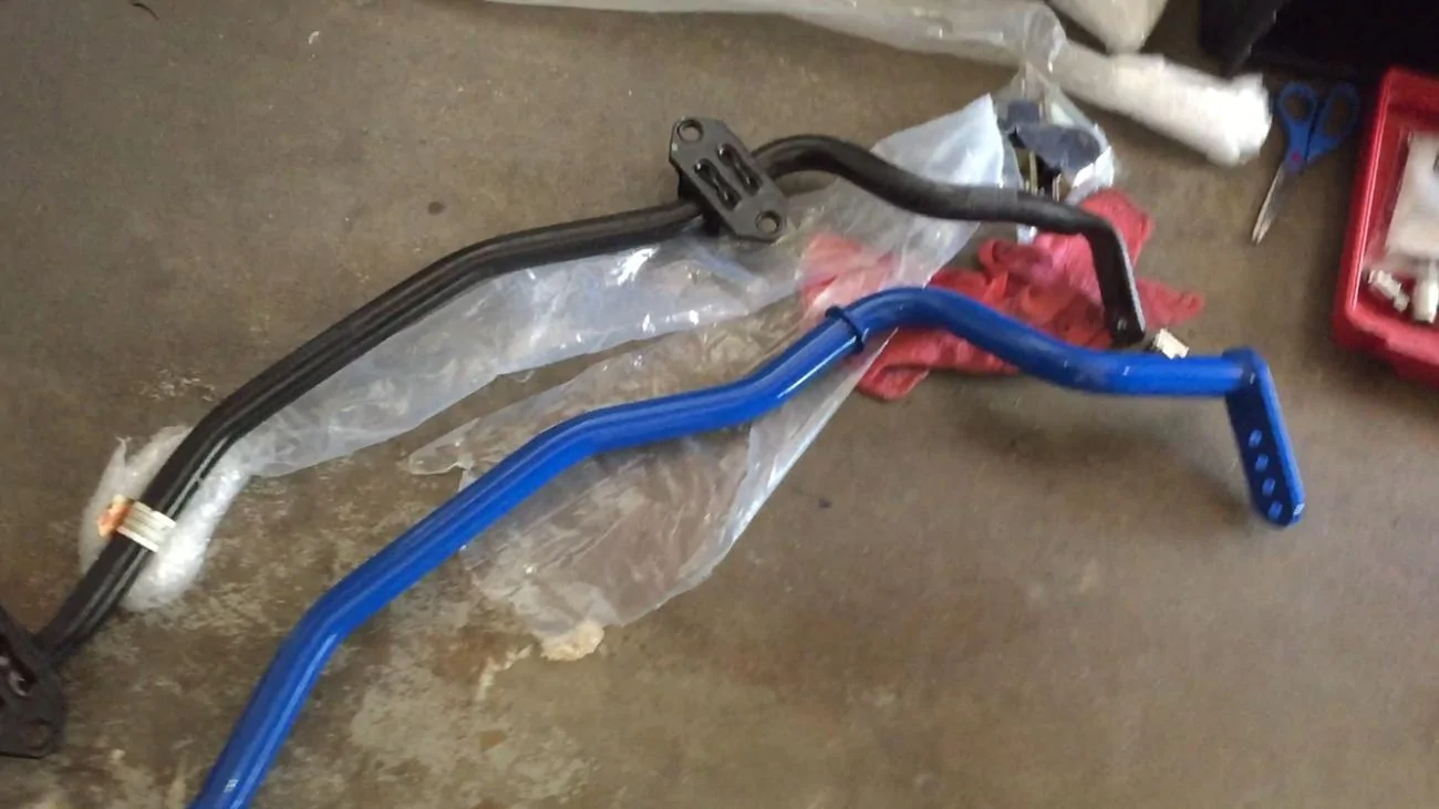

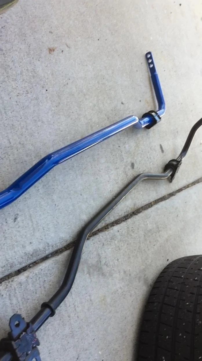

Front and rear Sway Bars with billet mounts. These sucker are HUGE. The fedex guy was pissed... I live on a hill where its hard for delivery guys to do there job. he only made it halfway up the driveway before he needed a break. For those of you who bought the performance pack and are wondering... " does aftermarket have advantage over the perf. pack sways" YES! absolutely
here are the specs on STEEDA vs PERF. Pack:
GT Performance Pack Sway Bars:
Front: 1.25"
Rear: .875"
Steeda Adjustable Sway Bars:
Front: 1.375"
Rear: 1.125"
Install is what is expected. Worming that front sway bar is a PITA but thats the same on any car. Steeda allows you to adjust its stiffness from OEM feel to an insane Stiff and rigid setup for track. I did some hard corning at 100 mph where i usually do 80 and its sure as hell because of these bad boys. Mine came with an extra stiff setting as well... Fluke? The billet mounts themselves are sturdy and built beautifully as well. Better to look at them some flimsy brackets. If your brackets are flimsy, whats the point of a sway bar right?

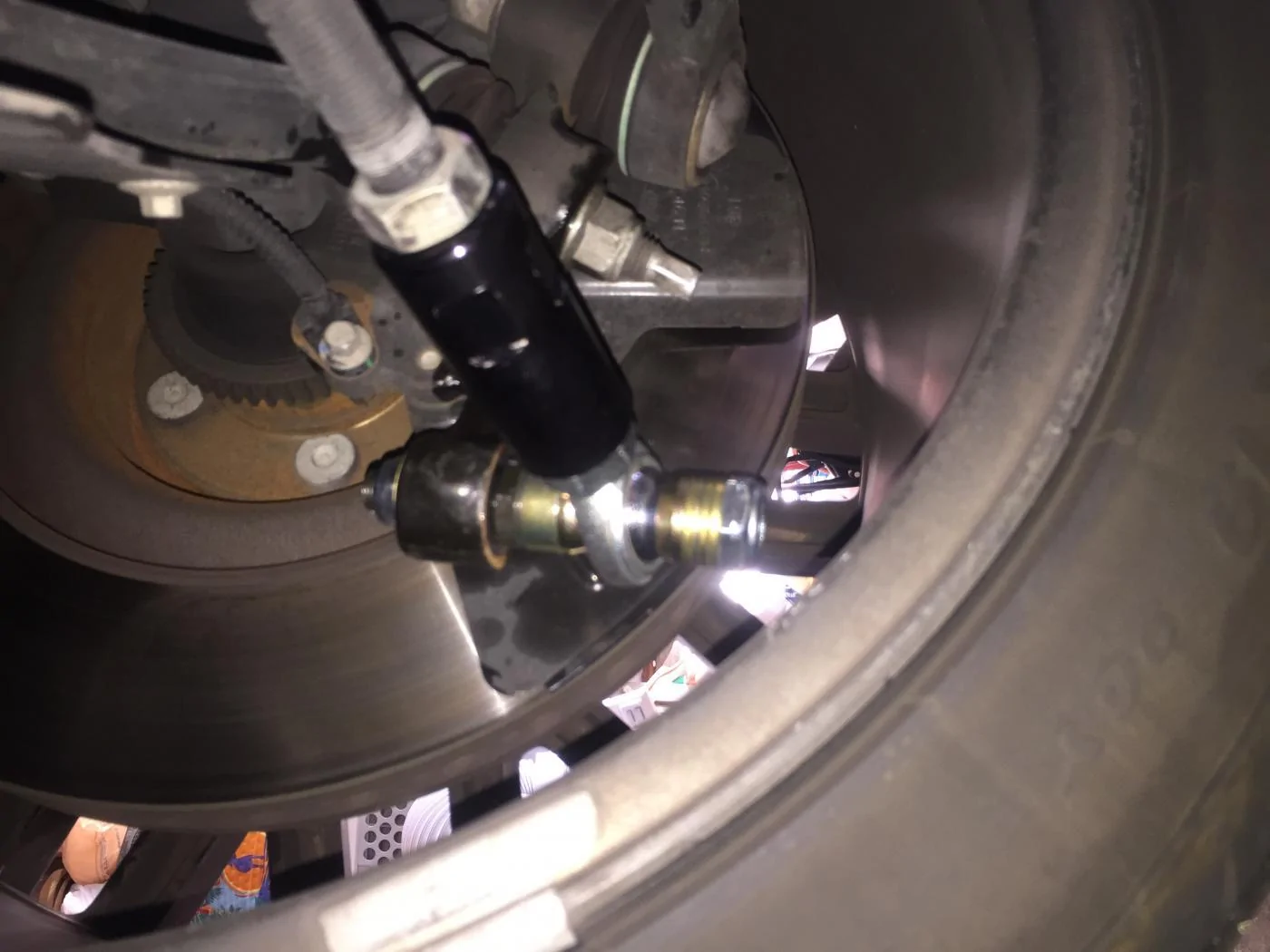

Bumpsteer Adding these to the car has made a world of difference. I hadn't thought much of the piece just looking at it. It's beautifully built don't get me wrong. But its so small and seems irrelevant. Before installing, driving a lowered car had its cons. Every bump in the road seemed to have wanted to pull my car in either direction. Adding the bumpsteer has made the car feel more solid and smooth. I can't tell you if that was the bump steer alone, but in addition to all the other steeda components it feels fantastic driving on bumpy roads.
Front: 1.25"
Rear: .875"
Front: 1.375"
Rear: 1.125"
