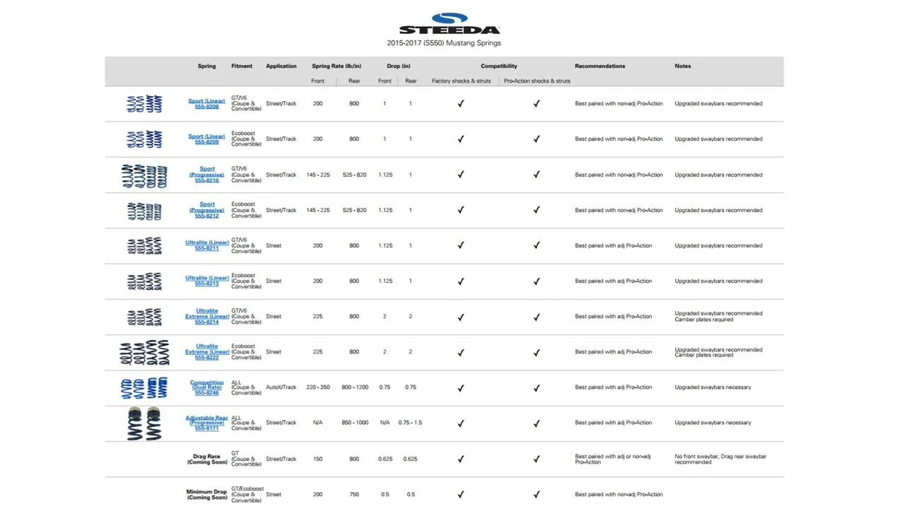

Need help selecting the right spring for your vehicle? Looking for data on rates, drop, compatibility and recommendations from our Performance Experts on Shocks & Struts, Sway Bars, Camber Plates and more?
Check out the Steeda S550 Spring Guide, it's based on real world data and feedback from thousands of Steeda equipped street, race and drag Mustangs!
https://www.steeda.com/2015-2017-mustang-springs

ETA on the Minimum Drop springs?

We are still a couple weeks out - I will update you when they are available!

Could you elaborate on the "upgraded sway bars necessary" part? Some guys are looking at doing GT350/GT350R sway bars, wondering if those are within the range you recommend for your springs.
