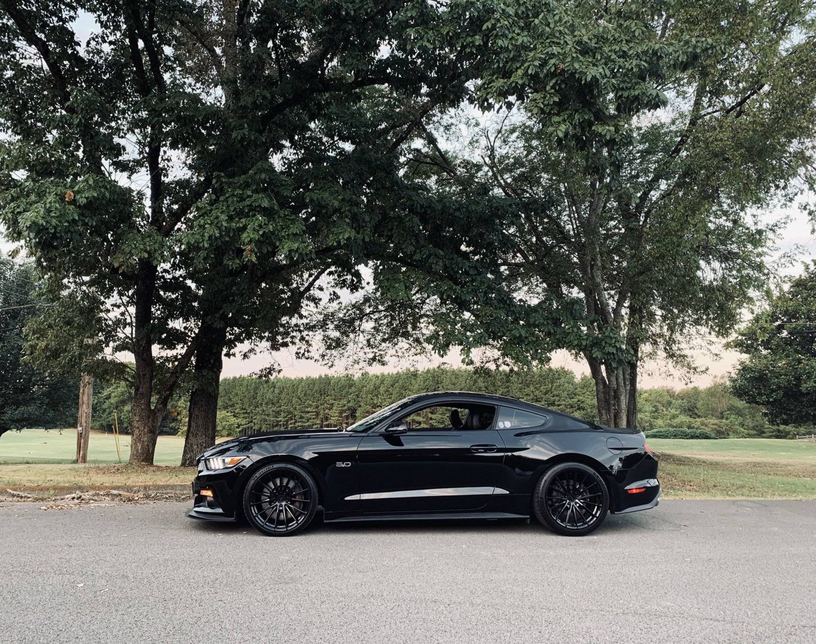

Hi, can anyone share a before and after picture of the result with this install? I've put progressive lowering springs but now car is sitting too low with the 18" wheels and tires...

I don't have a "before" pic, but I've used the spacer on the front and the rear after my coil-over install. It's a 1:1 increase for the front I think and a 1:2 for the rear. So just eyeball approximately how much you want to increase the height and go from there to select the right height spacer.

Thank you so much for your response. About half of an inch would do it...
Wait so you can put these on all 4 corners?!
Yes, there are special spacers for the rear and for the front. The front spacers are here:
Steeda 555 8254 Mustang Front Ride Height Spacer Kit (15-21)
The rears are here:
Steeda 555 8251 Mustang Billet Rear Spring Spacer 1/4" (15-21)
You'd need the 1/4" inch for the rear to increase the height by 1/2". For the front it's a 1:1 so 1/2" to increase by 1/2".

I had to add the 1/4" spacers to mine, because after lowering with the SVE progessive springs, the front only dropped 1/2", and the rear dropped 1". So, I had to lift the rear back up 1/2" to level the car.
