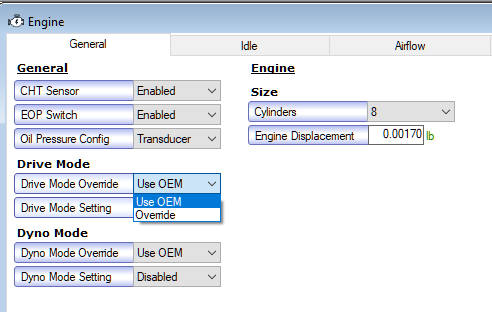

I contacted HP Tuners authroised distributor in Australia. They advised me with their product I will access to change the drive mode settings so that the default can be updated to Sports +.
Well, yes and no.
Here's what you can do in the editor.
First, you can override the default strategy.
You've got two options:
1. Use OEM - means that the car uses its original strategy, i.e. it allows you to change the mode using the flip button and defaults to Normal upon each start.
2. Override - means the car will always be in whatever mode you select from the next list.

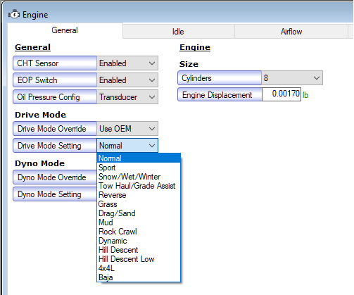

Now, if you've selected "Override" in the above box, then you can now decide which mode you want to use:
Caveats:
1. You won't be able to change the modes anymore. Whatever you select here will be active all the time. Flipping the button won't do anything from now on.
2. The modes listed in the second box do not match the available modes on a Mustang. Is the "Sport" here equivalent to Sport+? Maybe, maybe not. And where's Track? Such inconsistencies make me a bit wary.
Personally, I favour Mike's approach in post #27. Leave the general mode selection alone, but change the various characteristics of Normal to match whatever mode you like.
Also, be aware that not everything that works for US vehicles in HPTuners works for export ones. For instance, changes to the active exhaust strategy don't work for me (2020 Euro-spec), and HPTuners is unable/unwilling to help.

Thanks Vlad Soare for that detailed explanation.
I will do some more researching. If it just remains on one setting than that's no good for me.
I can live with access to only two settings, being:
- Sports + when i shift to D in my A10, and
- S mode or normal mode when i shift to S in my A10.
I will come back to you when i find out.
