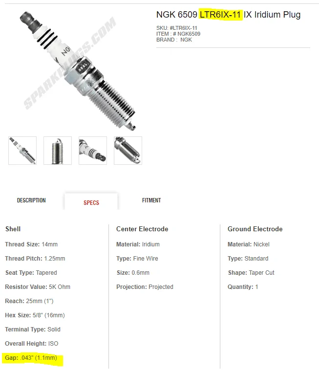

Hey man! Can I ask where you found the .043 gap info? My factory plugs were @.050 and owners manual states .049-.053They all have the same heat range.

NGK LTR6IX-11 GAP - .043"

It's all from NGK.comHey man! Can I ask where you found the .043 gap info? My factory plugs were @.050 and owners manual states .049-.053
Thanks
Cool thanksIt's all from NGK.com

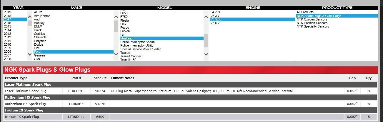

NGK site shows LTR6IX-11 gap .052. Checked cause I thought I was crazyIt's all from NGK.com
Sure you're looking at the right number?NGK site shows LTR6IX-11 gap .052. Checked cause I thought I was crazy
Yep. That’s why I checked by application. Also didn’t realize they call out different ones for the 18-19, but the 6509 & 6510 work fine. I ran 6509 NA and now run 6510 boostedSeems their own site conflicts lol.
