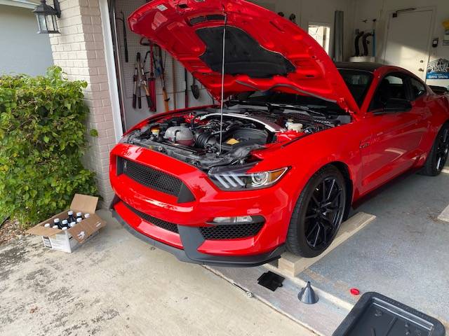

That's awesome!There's more than one way to skin a cat.. I made some low-pro wooden ramps that work just fine for getting under the car for easy maintenance like an oil change without taking the tire off. The choice is obviously up to you. As for the rez delete and the GrimmSpeed exhaust valve simulators, a MUST. I threw down a quick review on here on one of the rez delete threads. No more indecisive cold start valve movement. ALWAYS OPEN. BUT it's easy enough to put back to stock if you start finding more than usual dog poop in your lawn... Welcome to the family! This car will get under your skin..in a good way.
Rez delete outta the way. Nice. The switch will still works with the rez deletes. The switch controls the valves in the mufflers. Thats what the GrimmSpeed exhaust valve simulators take care of. Unplug the wire harness on the mufflers while the valves are open, and plug in the dummy plug. No more, 'BRAAAbrrrrrrrRAAAAAARRRR...' (loud then quiet then loud) exhaust on cold starts, which is the valves cycling. Also, you have open exhaust in 6th gear while cruising. Don't worry, no drone, even with the rez delete. I've had the back seats folded down for years, and I cannot get enough of the sound.That's awesome!
I do have some low profile Race Ramps. But ideally want to use my 4 post lift.
