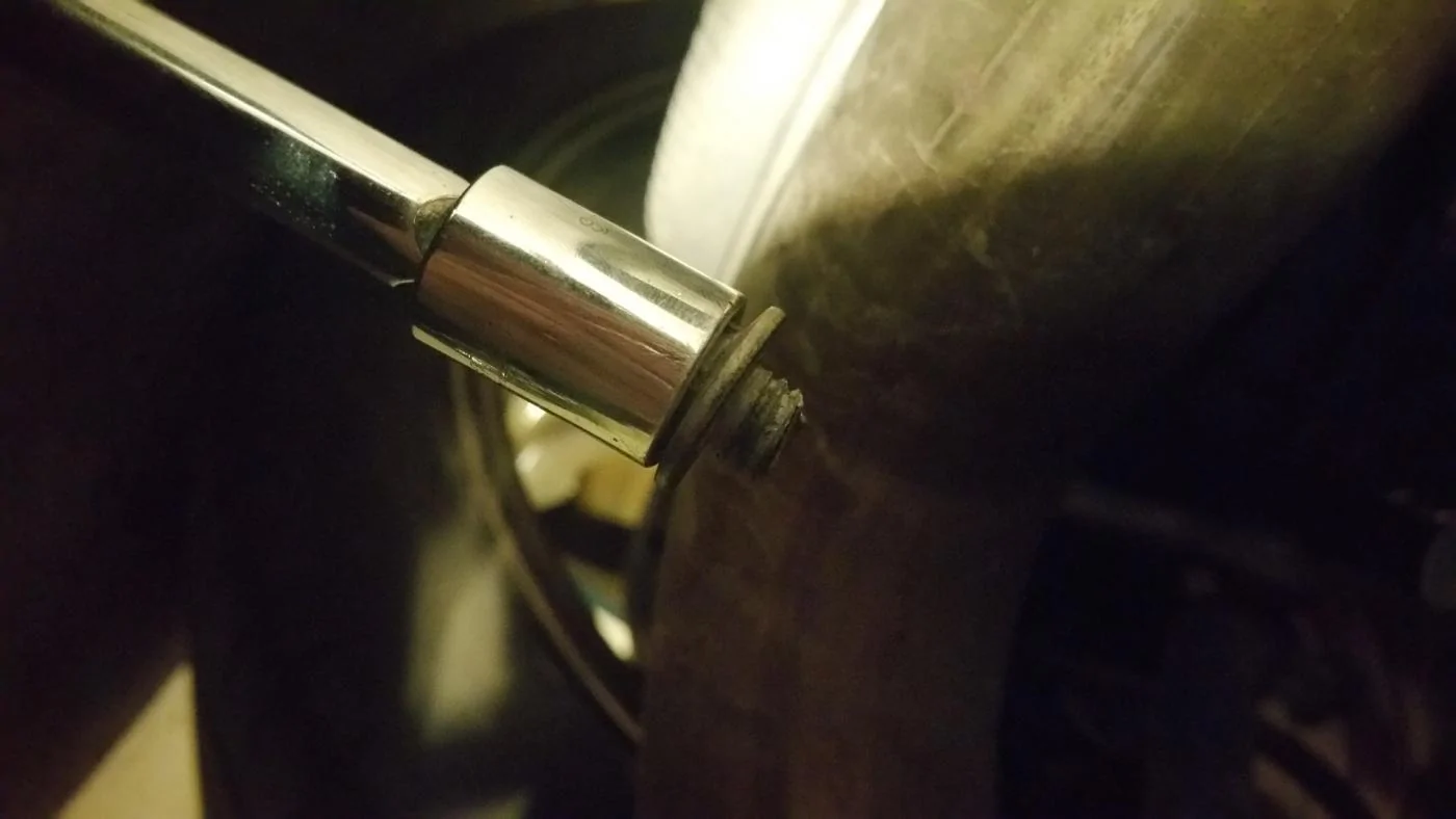

After going out in the 70+ degree and sunny day, I waited for it to start making the noise. Rushed home, jacked it up, took the wheels off and loosened the vertical links. Pushing stuff around I could faintly hear the creaking / groaning. I'm using one hand to move stuff around and the other to feel around for the vibration. Turned out to the be the damn BMR Adjustable Rear Toe Links. Specifically the open ball joint at the top connected to the subframe. (Picture should show up under here.) I had a can of white lithium grease, sprayed it all around, wiggled the joint around, sprayed some more, wiggled it around and dropped it.

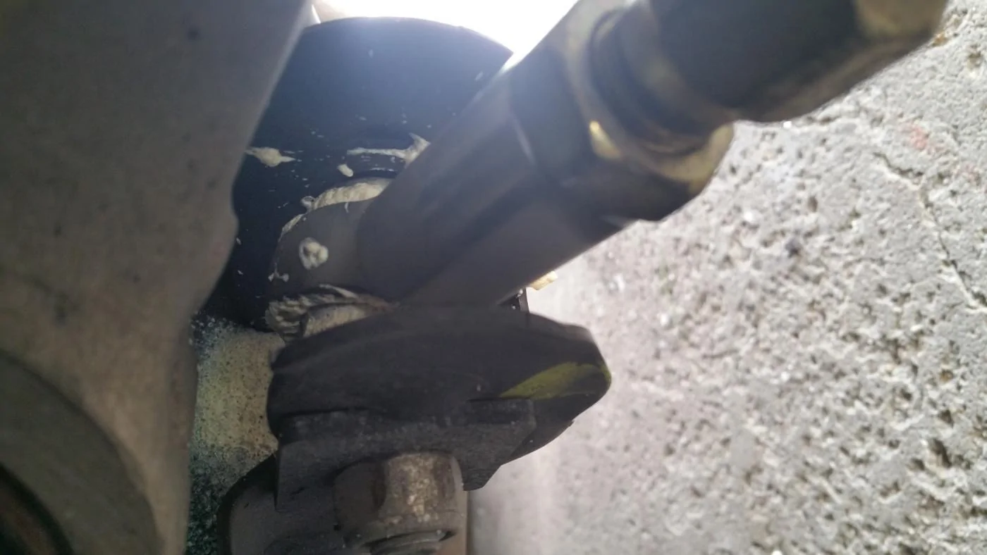

I ended up spraying the vertical links too because they're straight spherical bushings. (See 2nd picture)
