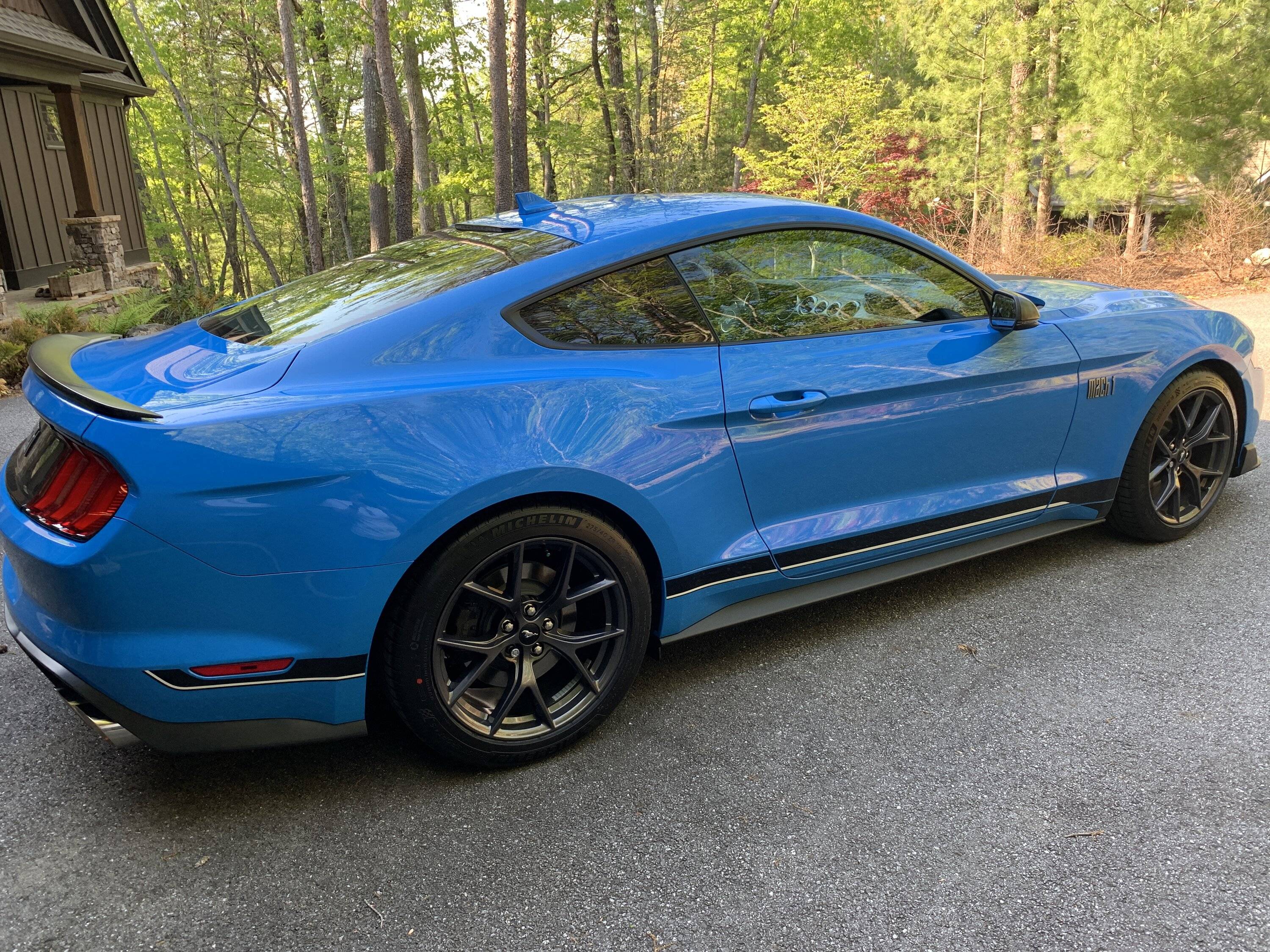

No idea about why they went staggered. I assume it's for max handling etc. as the Mustang is a performance platform! I've been dealing with staggered set-ups since 2000 when I bought my first AMG Benz. Been thru more money in tires than I can count! The first change I made to my HP MACh1 was to get rid of the Cup 2 tires. At the same time I came on here looking to see what people had done to go to a squared set-up. The OEM wheels IMHO were like wearing black socks with shorts and sandals....lol. I ended up buying a set of 19x10 HP replicas and I'm running 305/30/19 Cooper Zeons and have zero complaints! They're quiet....grip well and do well in the rain! I'm able to rotate tires for the first time in 20+ years and after 7500 miles I'm not 1/2 way thru the tread life!

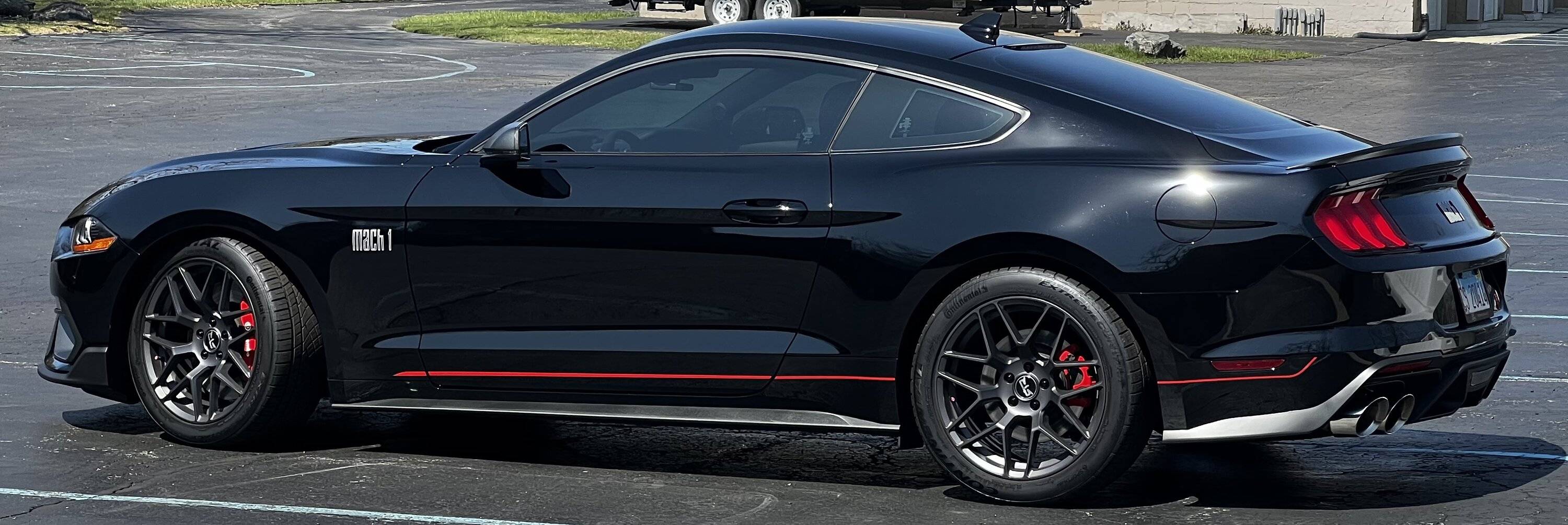

When going from 255/40/19 front, 275/40/19 rear to a 275/40/19 square, what do you do about the .63 lift in the front from the taller front tire? I wouldn't want my car to sit any higher in front because the rake would look goofy in my opinion. I like that the front would scrape less though.
Here's mine, it looks fine.
