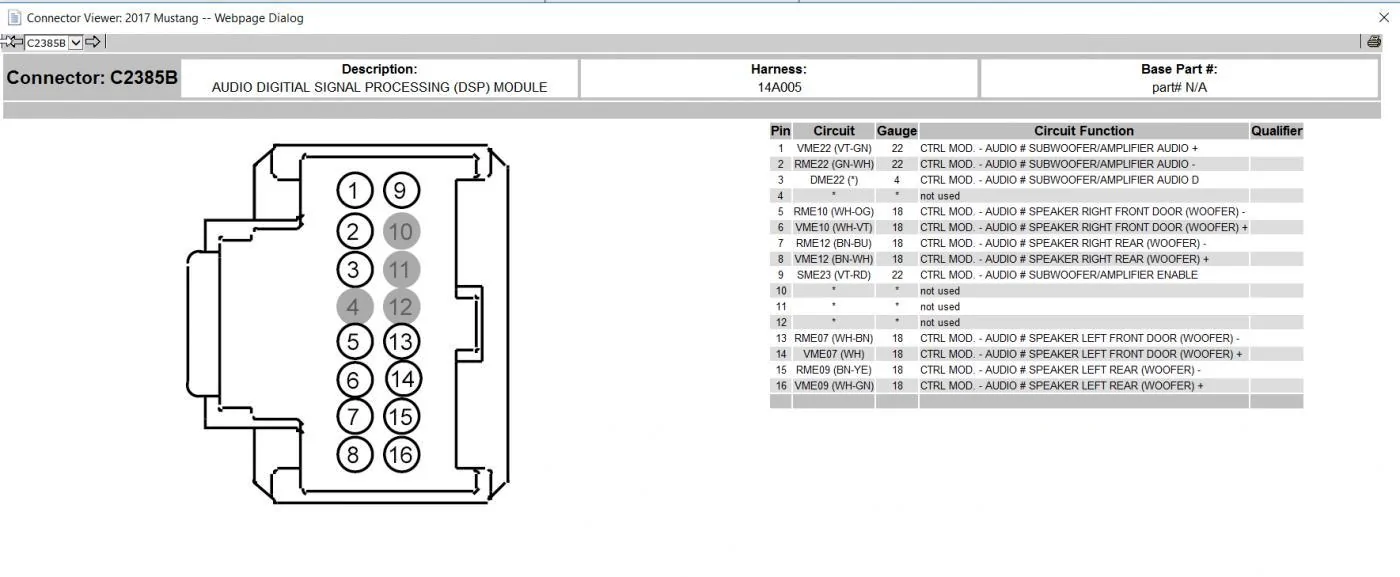

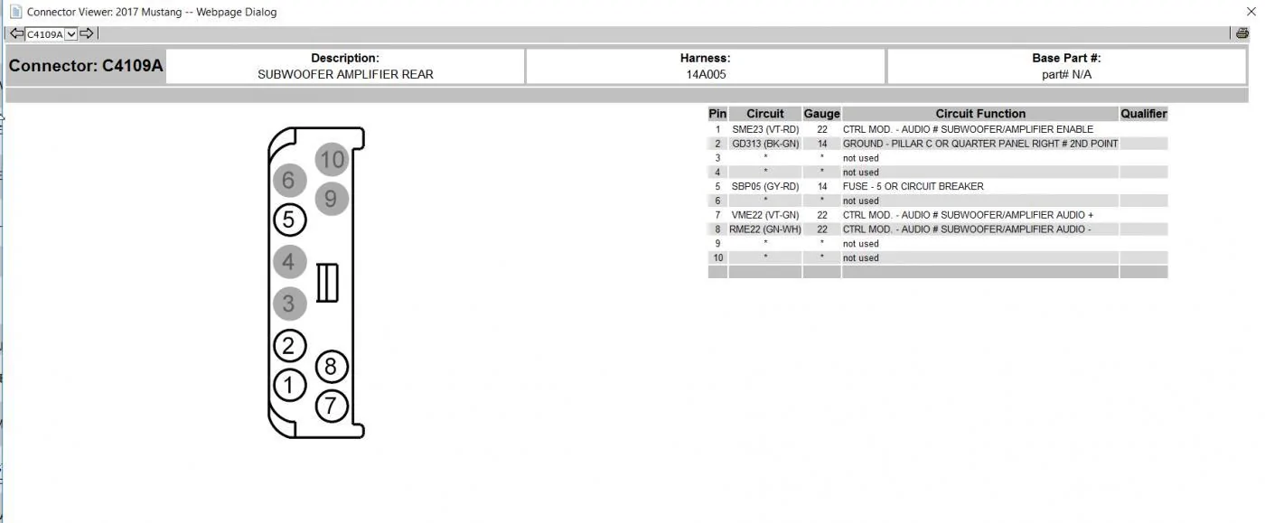

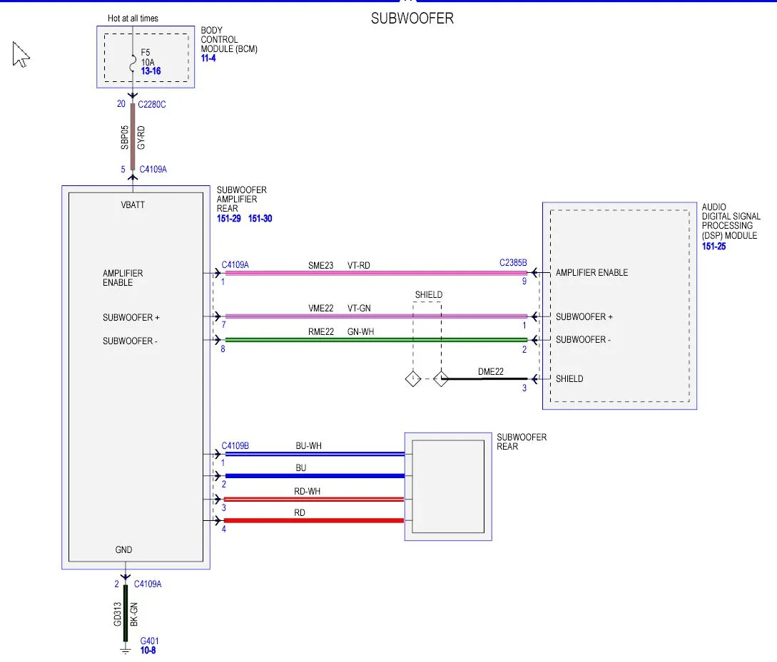

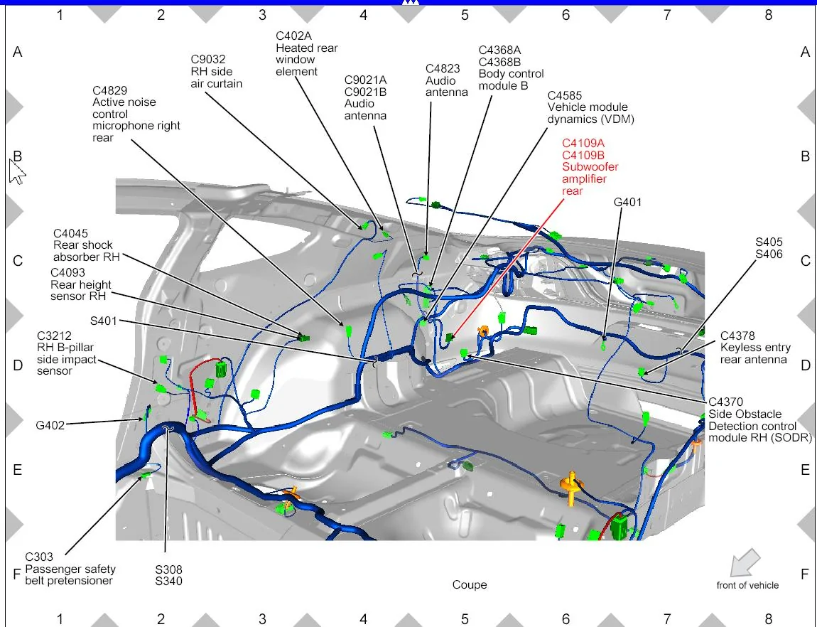

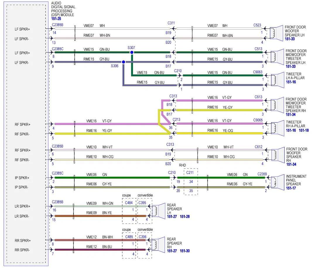

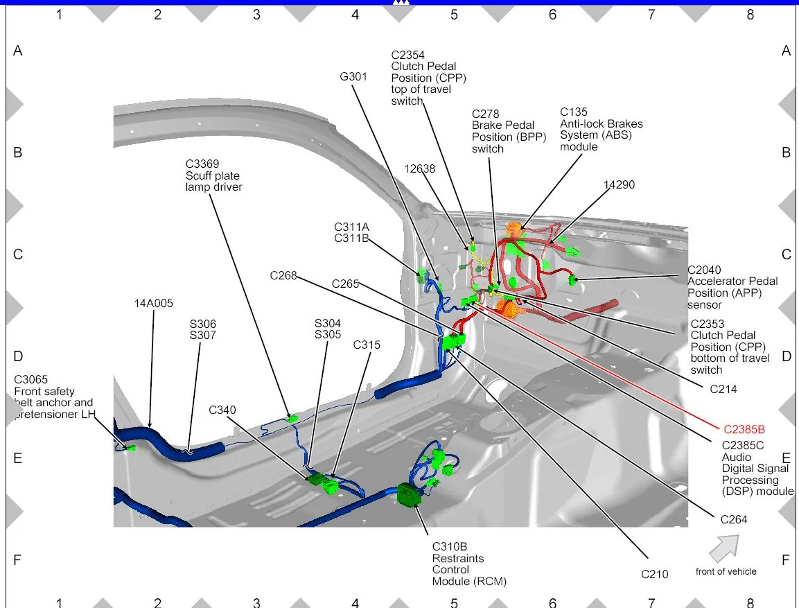

I've read many threads on GT350 premium stereo sans trunk bass speaker. From my reading a upgrade of the pillar tweeters and the addition of a bass speaker would provide a good system. Without a head change.
So I trolled the Shop manual and it seems Ford might have just left out the Trunk amp and speaker but the wiring is there for it.
So my question is has anybody looked at doing this way? I attached all the wiring pics, locations and connectors.
