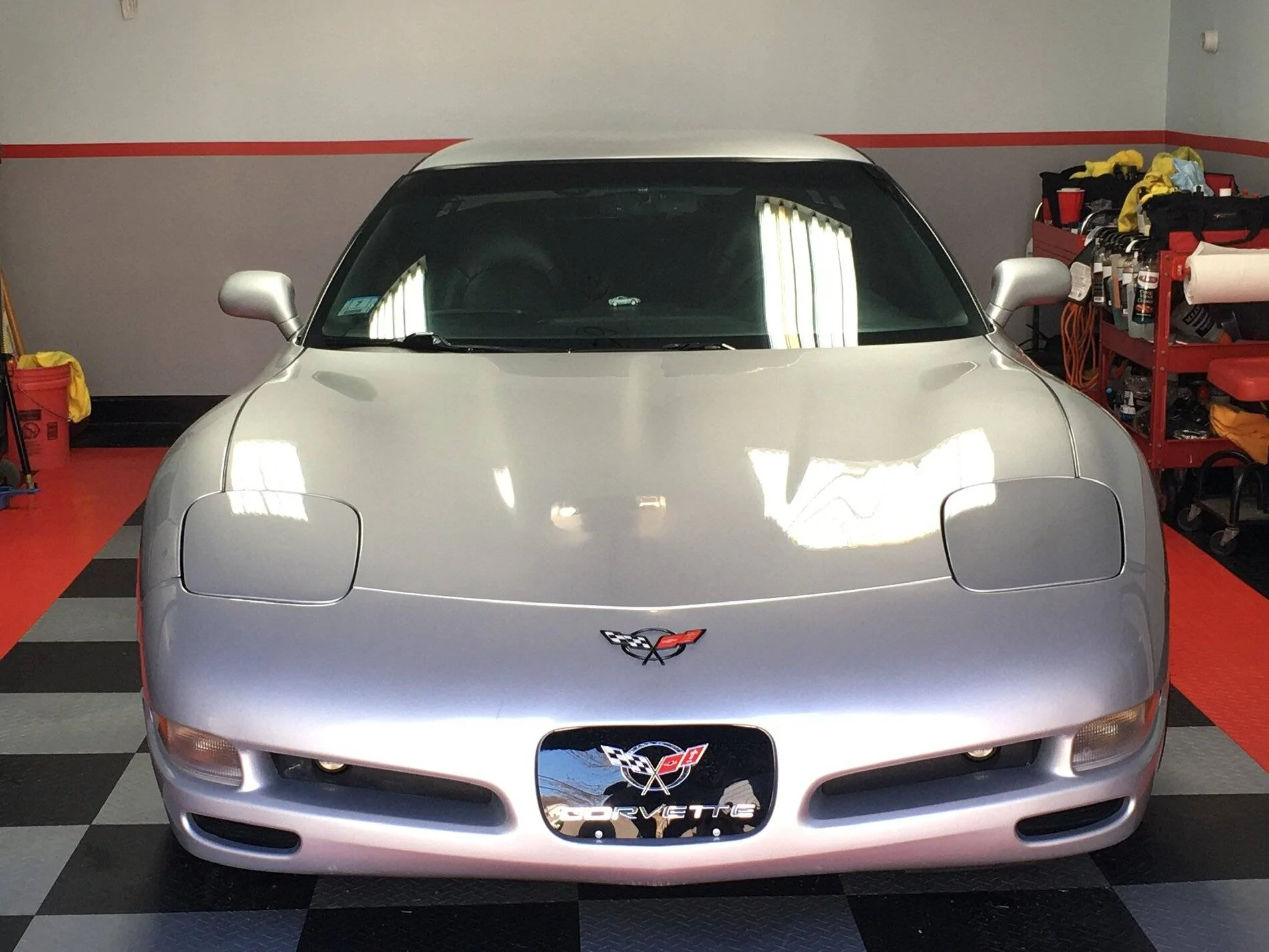

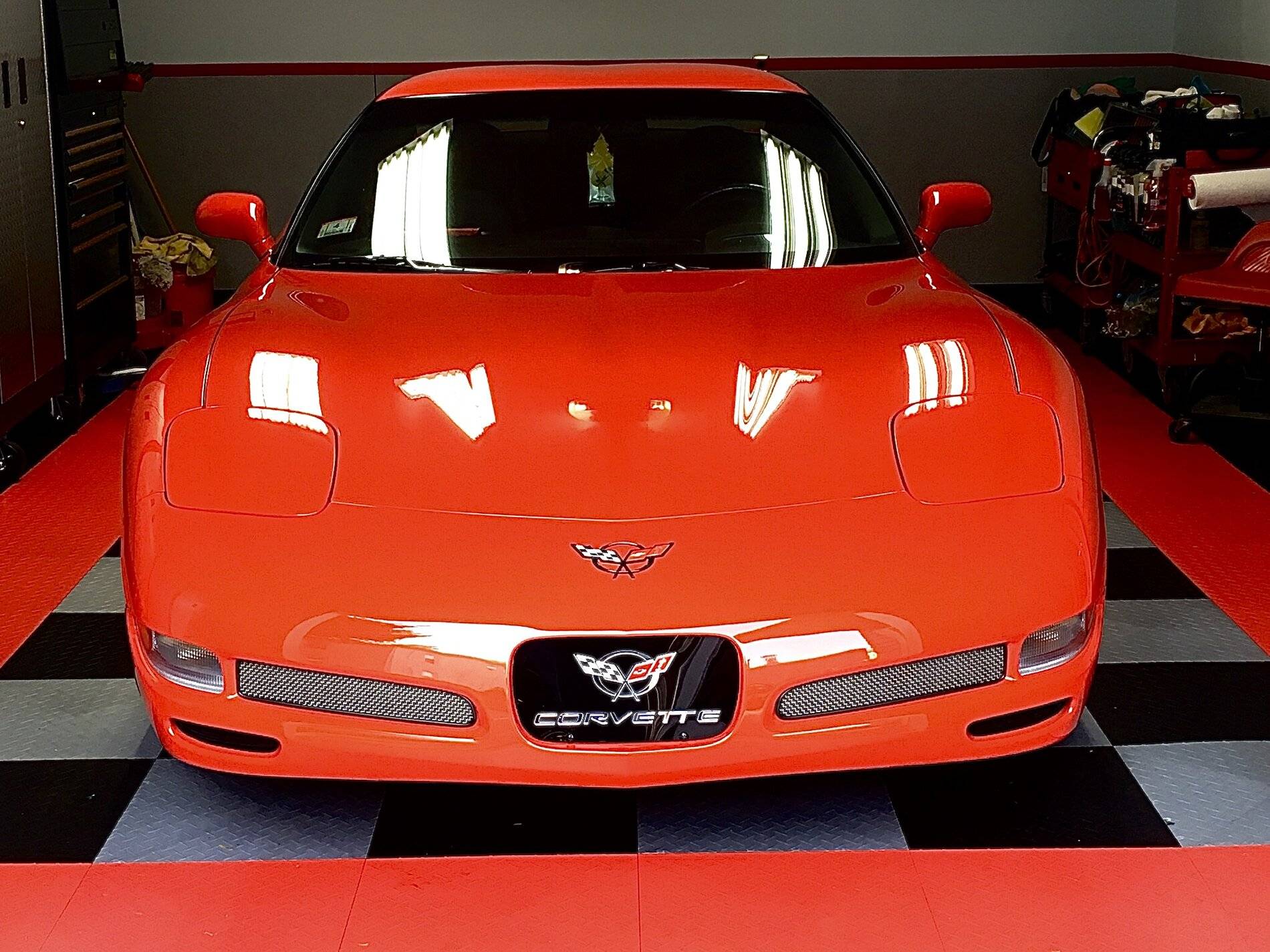

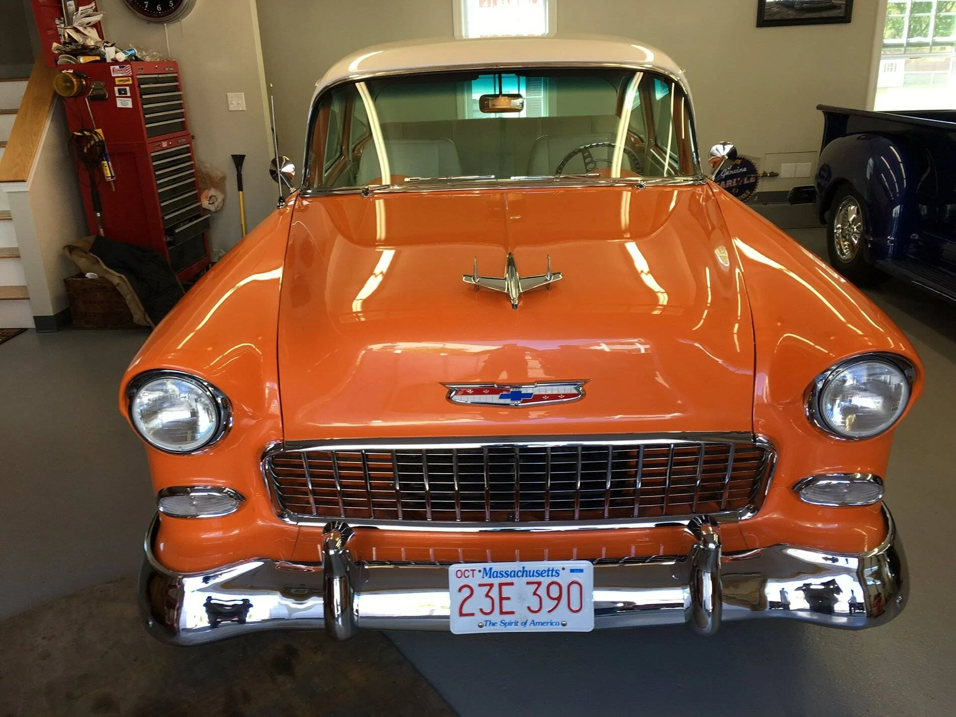

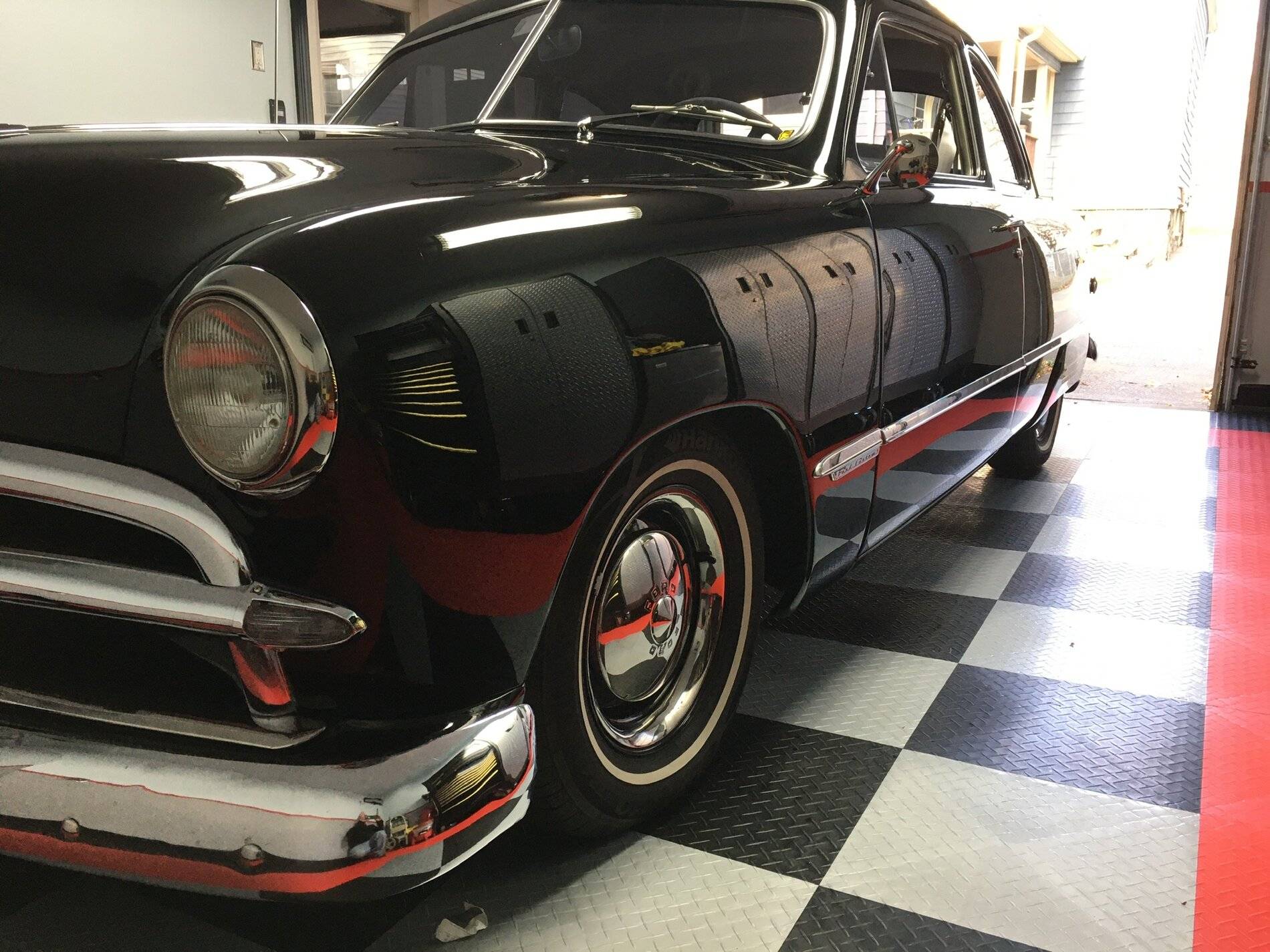

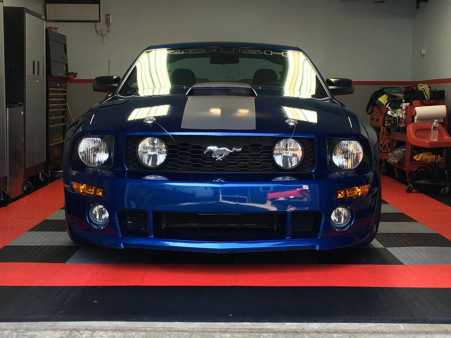

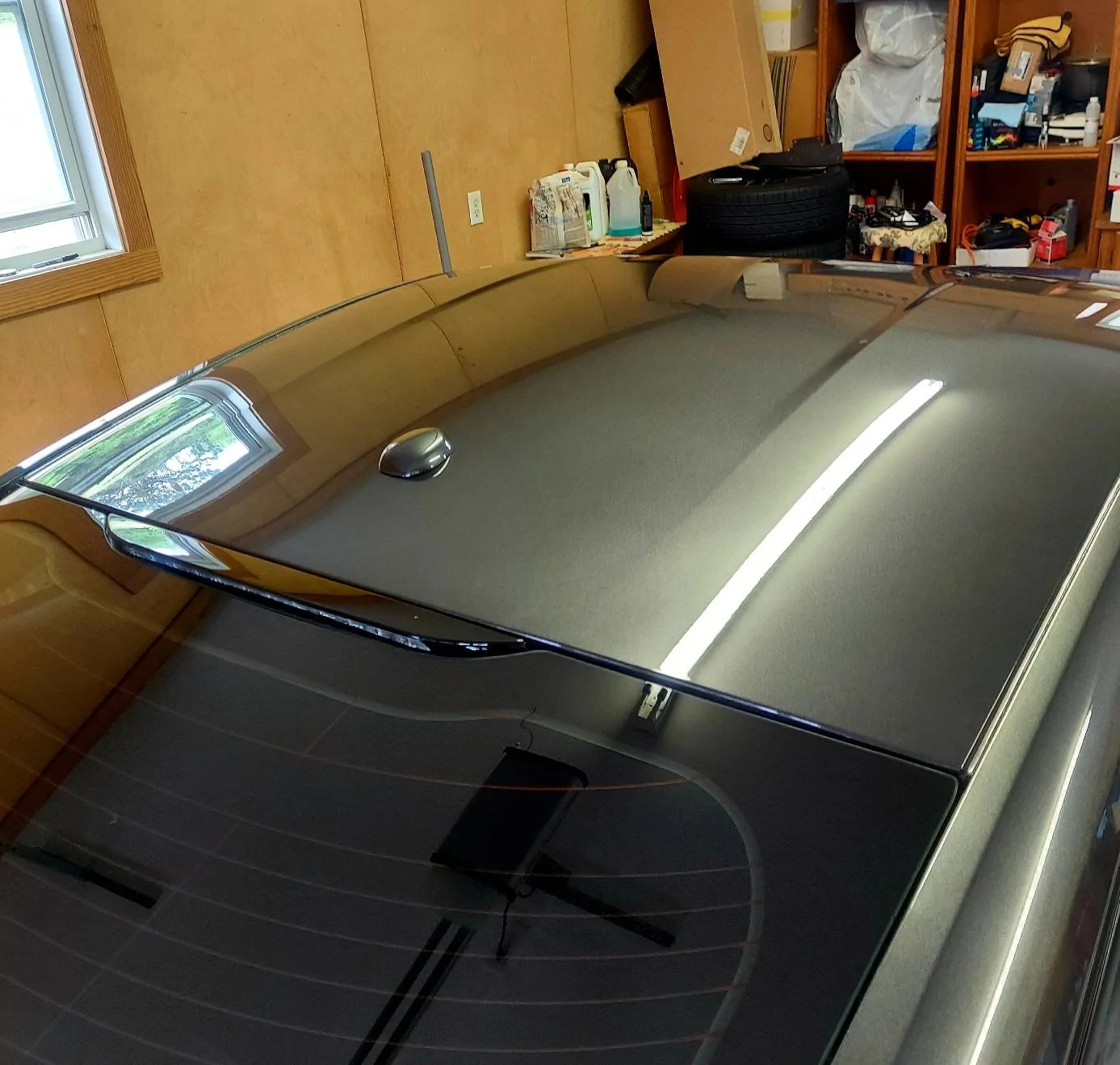

A few cars bellow using this process

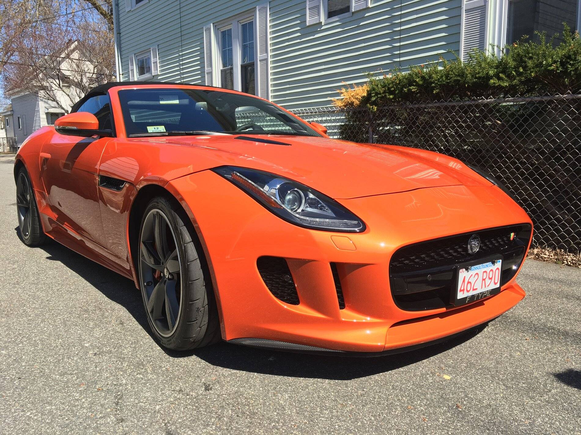

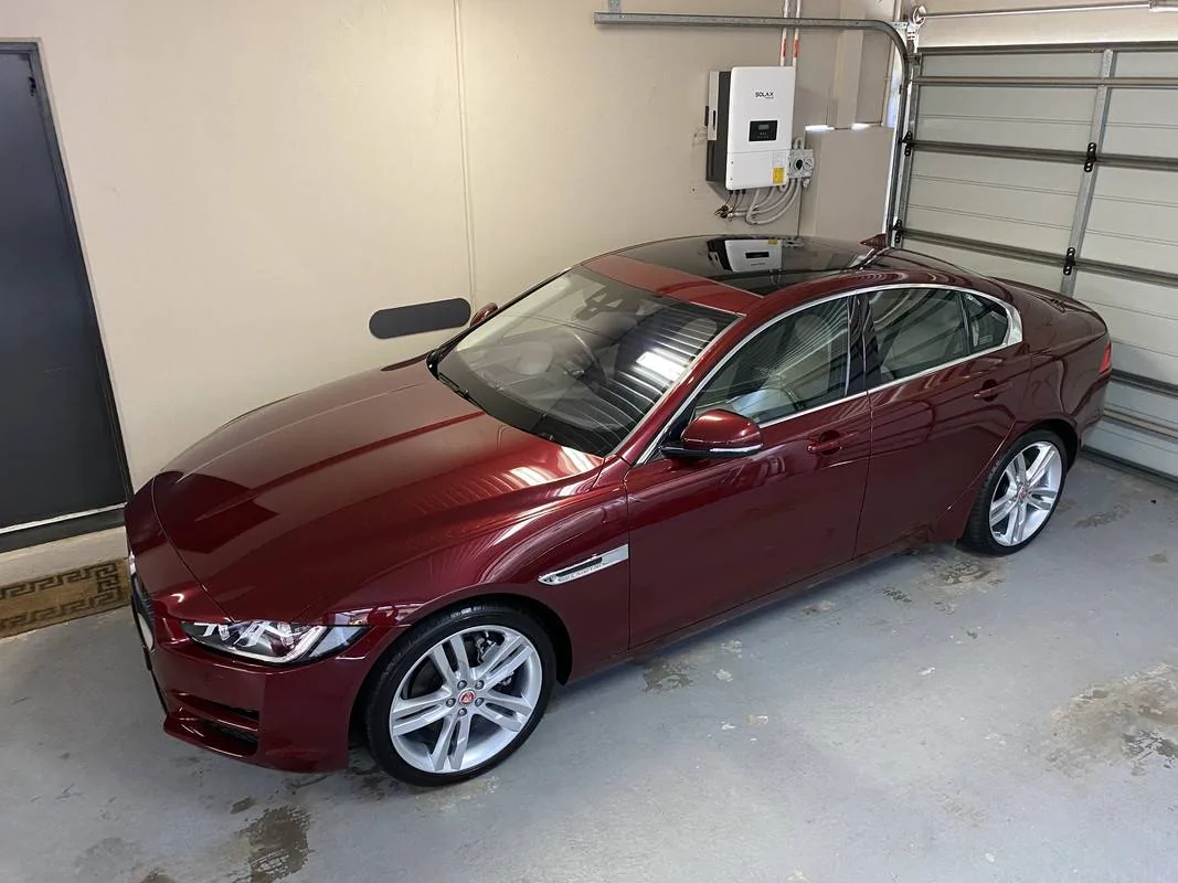

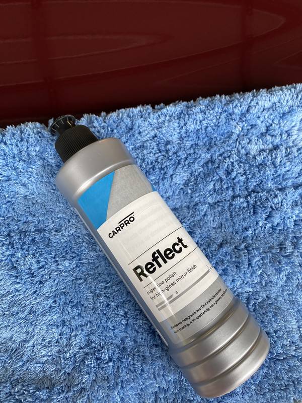

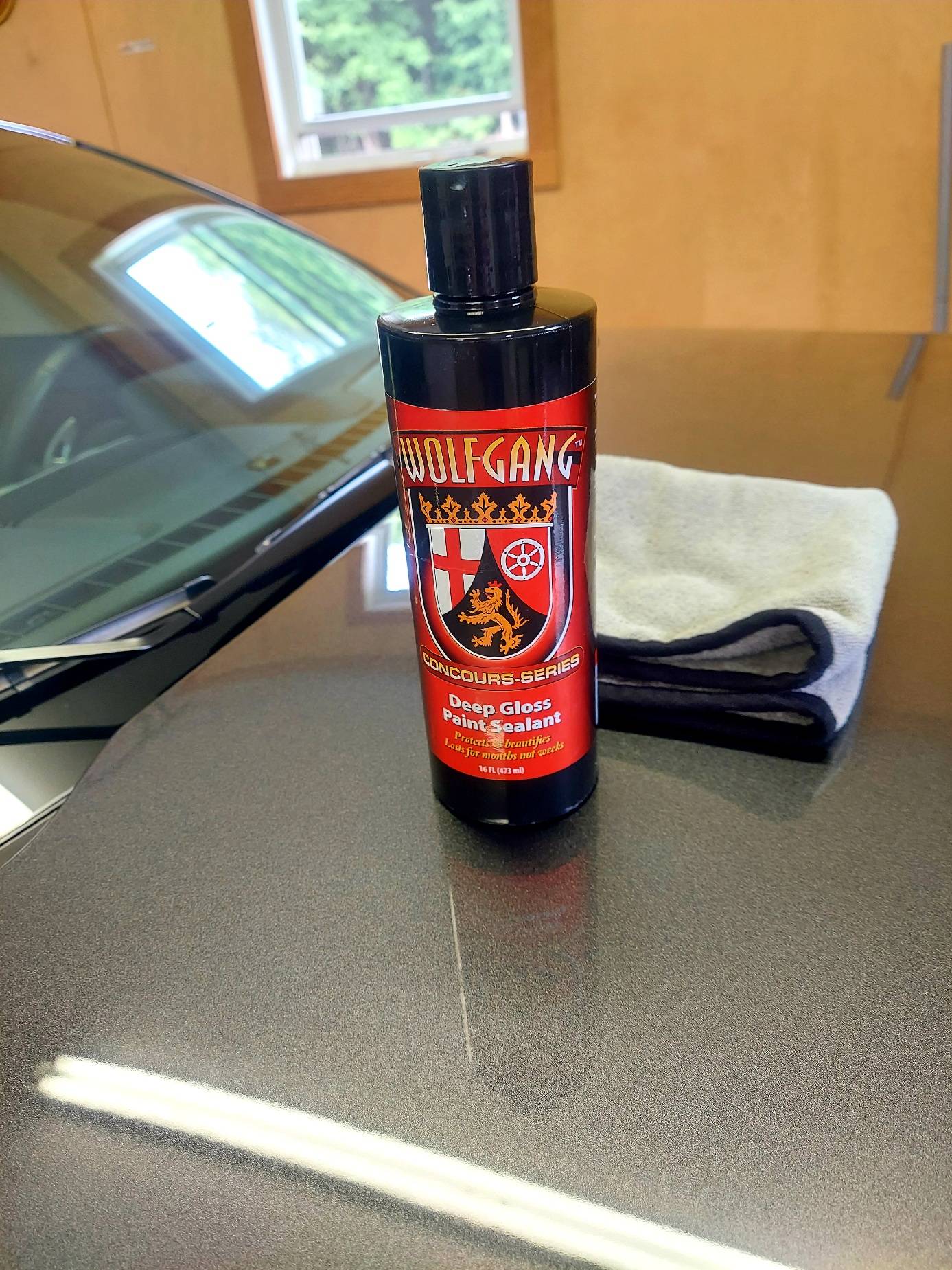

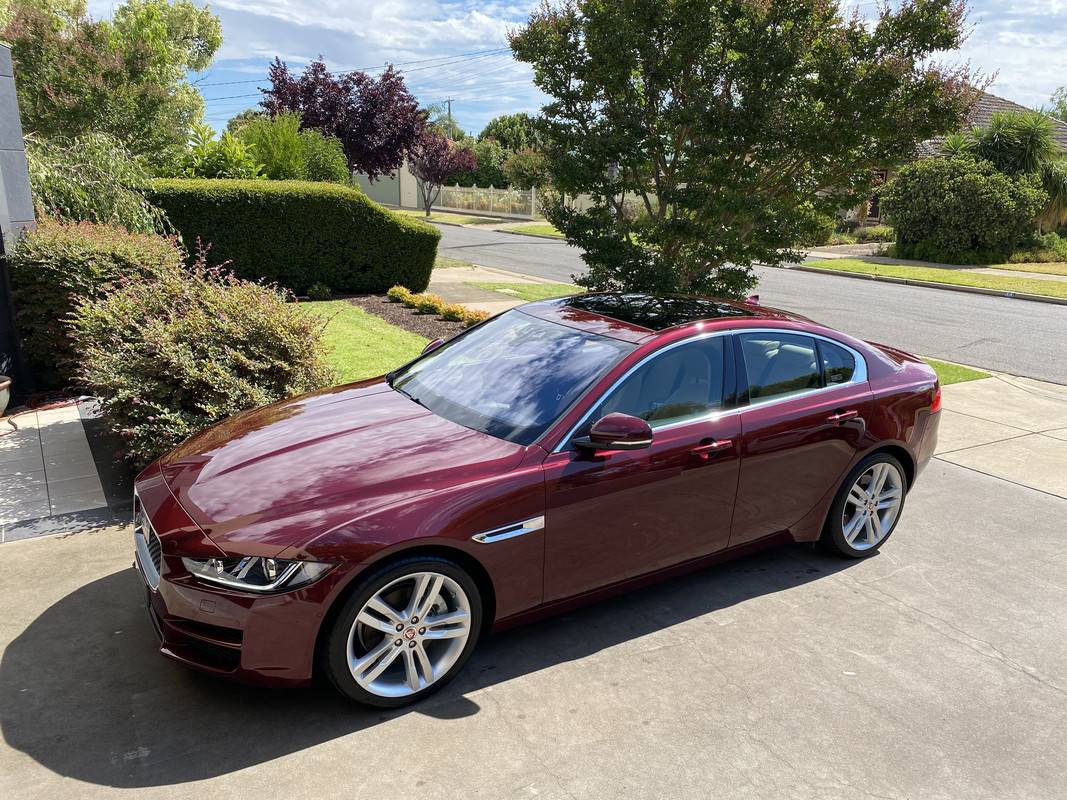

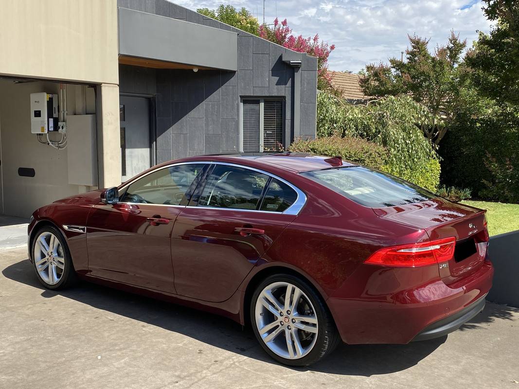

How do you like Wolfgang Deep Gloss Paint Sealant? I have used it on and off over the years and really love how it looks. Last car I used it on was the Jag, using CarPro Reflect before its application -

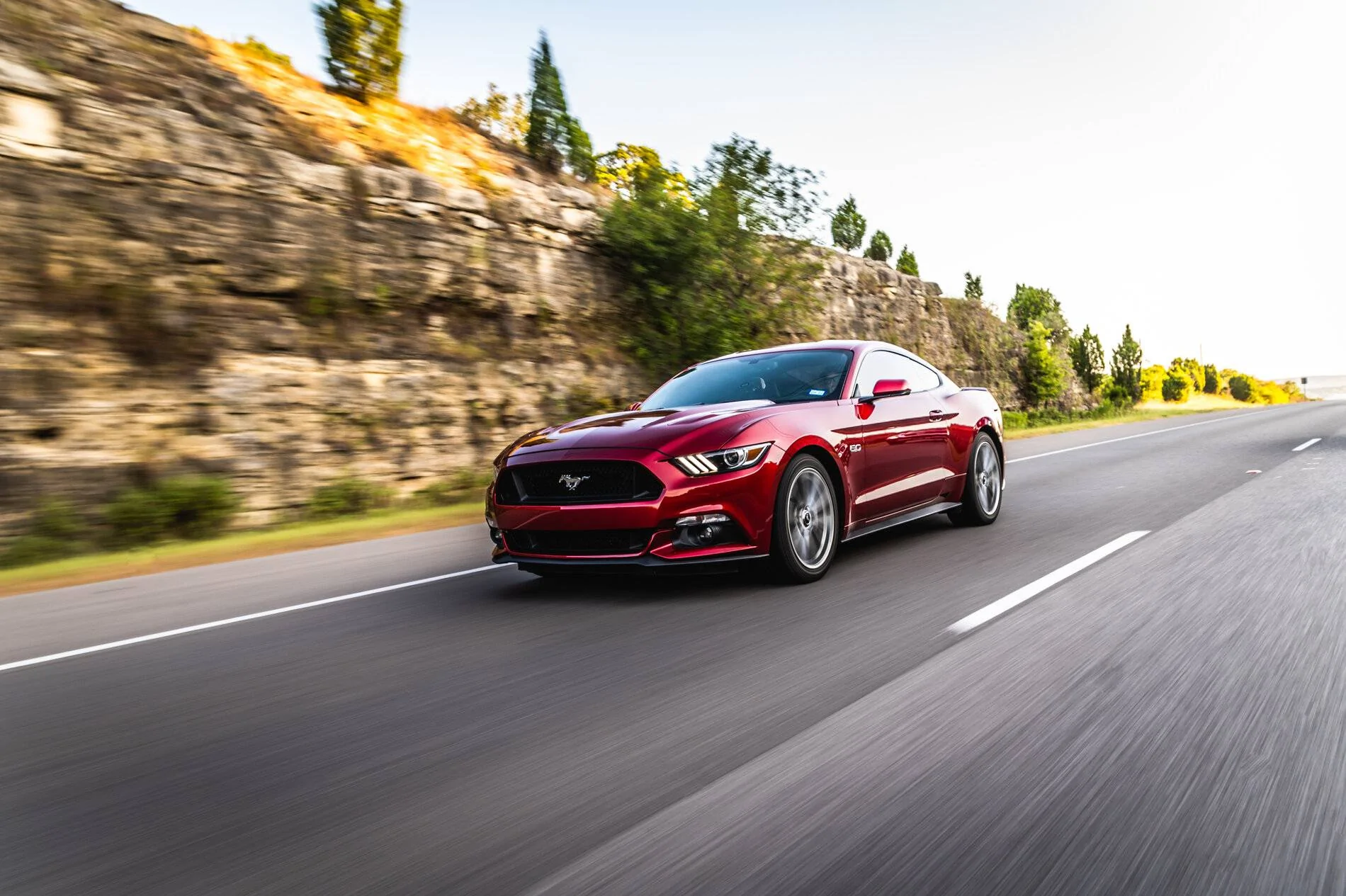

Couple shots from a recent roller session. 100% stock exterior, and I still cant stop staring at it.
Looks great! Photos by @TheVinylLens ?

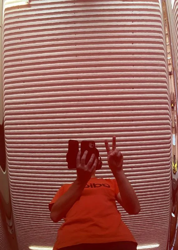

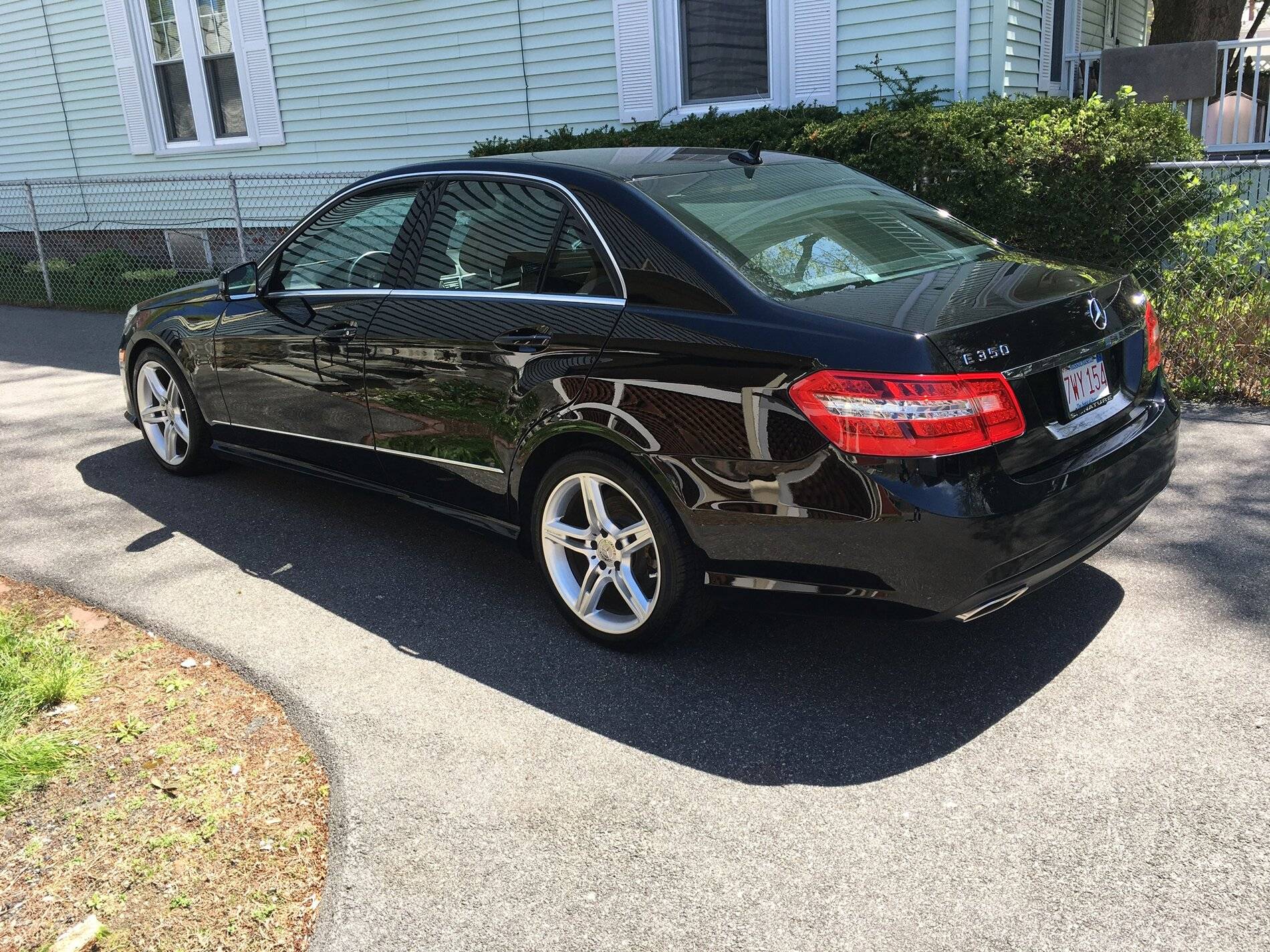

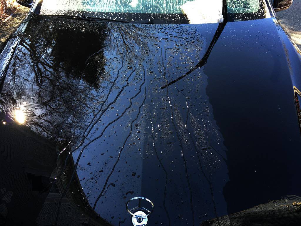

I did a test on the hood of a black Mercedes.
I did three sections, one with Wolfgang Sealant, one with Reload and the last with PolishAngel High Gloss. The gloss numbers were very close. PolishAngel got slightly higher numbers.
But going back after 3 months and 6 months and measuring again PolishAngel looked like I just did it and the other two were gone. The left side is Reload, the middle is PolishAngel and the right Wolfgang. This picture is around 6 months after applying the products. The guy that owns the car did nothing to it. The car sits outside. He didn’t wash it or use any detail sprays. I was stunned at the results.

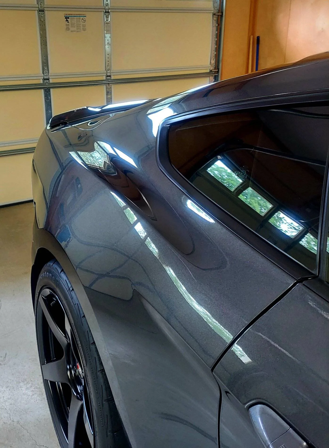

Thanks to the super annoying @DFB5.0 and @Les I was forced to go out and clean my already clean car this morning. All I wanted was an easy restful Sunday morning but these two jokers, and the rest of you ruined my plans. Thanks!! :giggle: ❤ ❤ ❤
Don’t let them bully you😂 stand your ground and leave it dirty🤣
It looks great BTW
