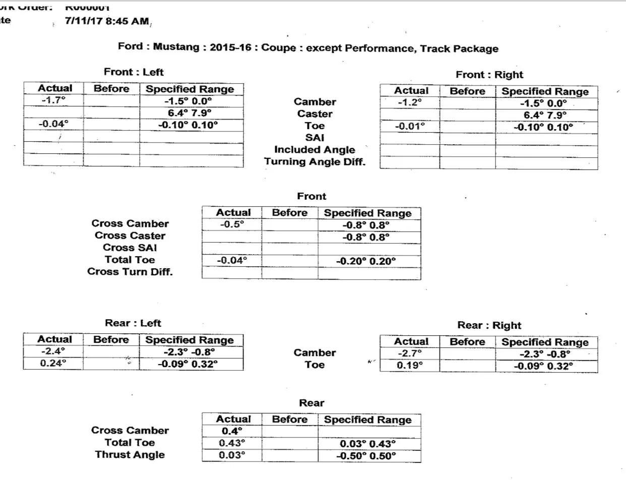

during a heavy/hard acceleration the car wants to go kind of right, then when I left off the gas it kind of pulls left.. hard to explain.. attached is my current alignment specs
noticed it after my rear was taken down for a bushing replacement, took it for an alignment and they clocked my bushings just to be sure, issue still persisted. took it to my local ford dealer and paid for an alignment, issue is still there. I don't think it would be a loose bolt/control arm bolt if I had ford look at it, right?
