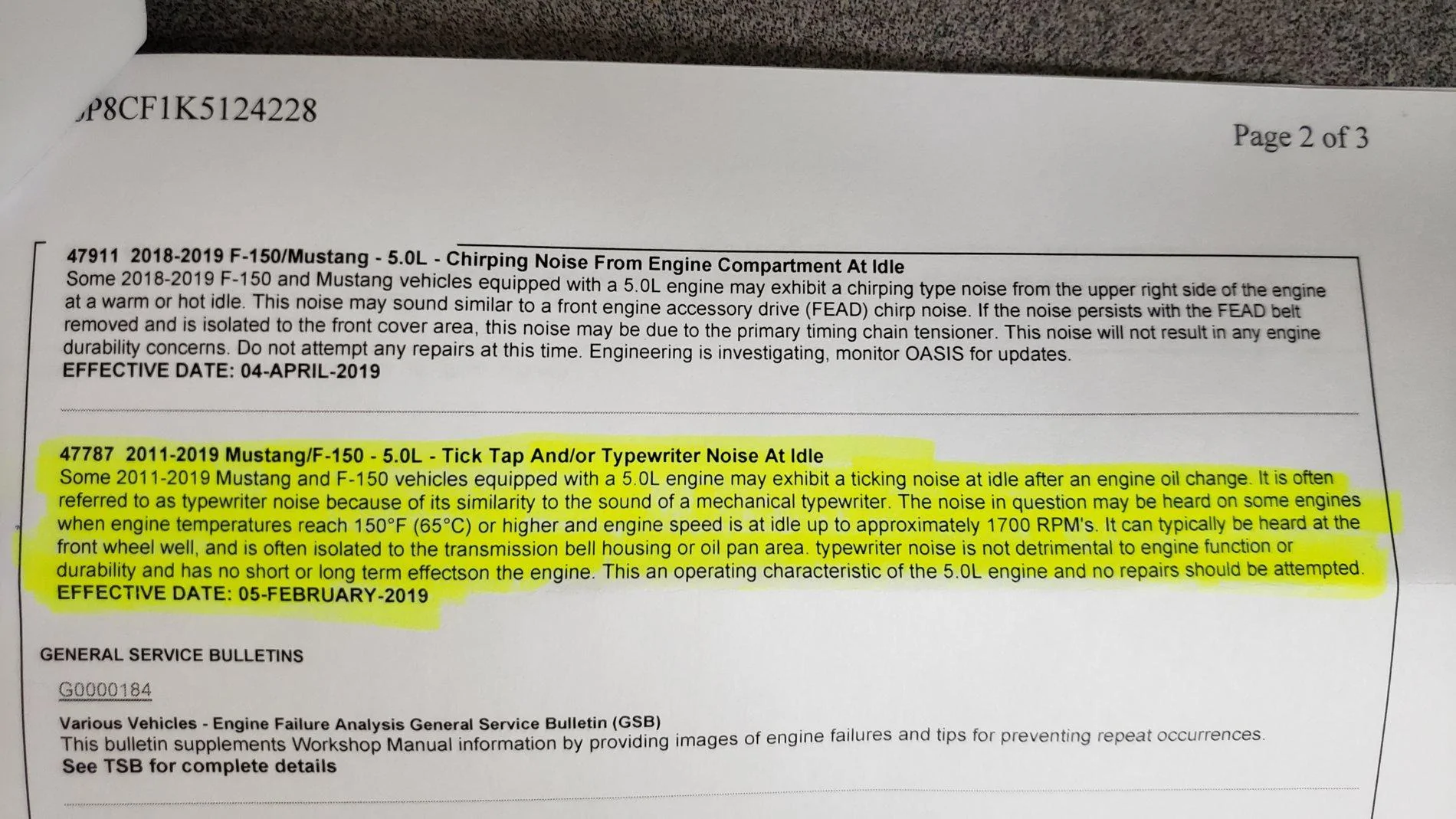

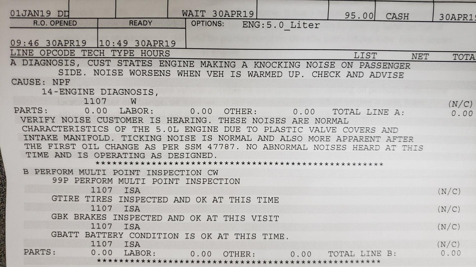

Here is what we DON'T know,how much gold is in Ft KnoxThe one video has 2 ticks... one is valve chatter which is common on the GT350s and consistent, but there's another ticking that's inconsistent and sounds just like the typewriter tick. The owner of the car even says it's inconsistent
What goes in to make coke that we all drink
What happened to flight MH370
What makes the noise TICKING,RATTLE,BUBBLES in Fords 2018/19 Coyote engines.
We can debate this forever but like all of the above, there is NO answer,only Ford knows,and it's a BIG SECRET just like the above statements.
What we do know is, the NEW Coyote engine has some serious problems.
