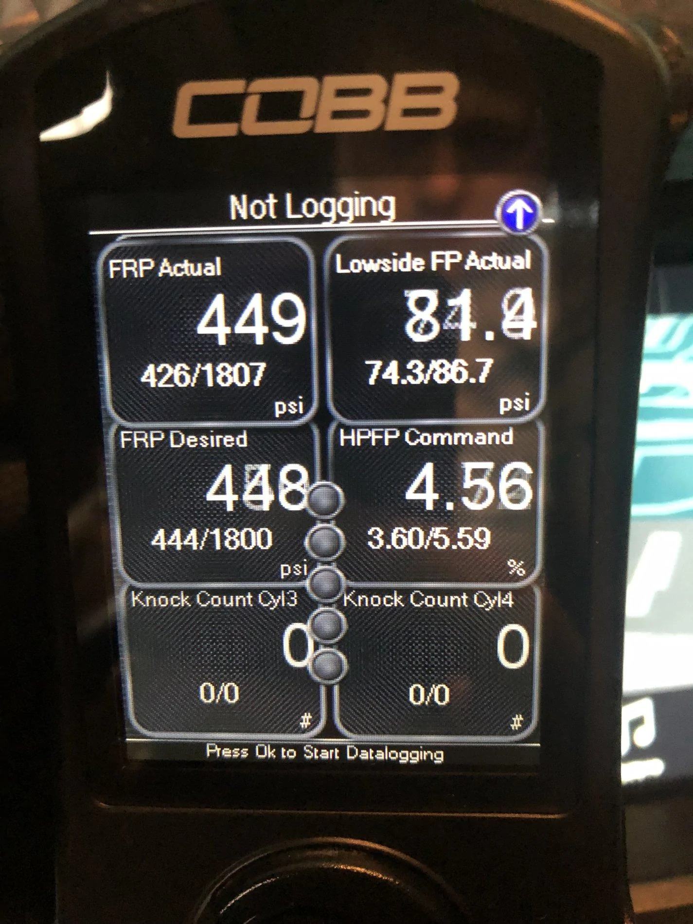

I ordered a new sensor from ebay, but until it reaches 30 days, that’s not enough or I can drive a sensor that I have from the factory. Here at idle photo, today.
Just keep an eye on your fuel pressure actual vs desired. If the actual is constantly way lower than the desired especially under power, then park it.

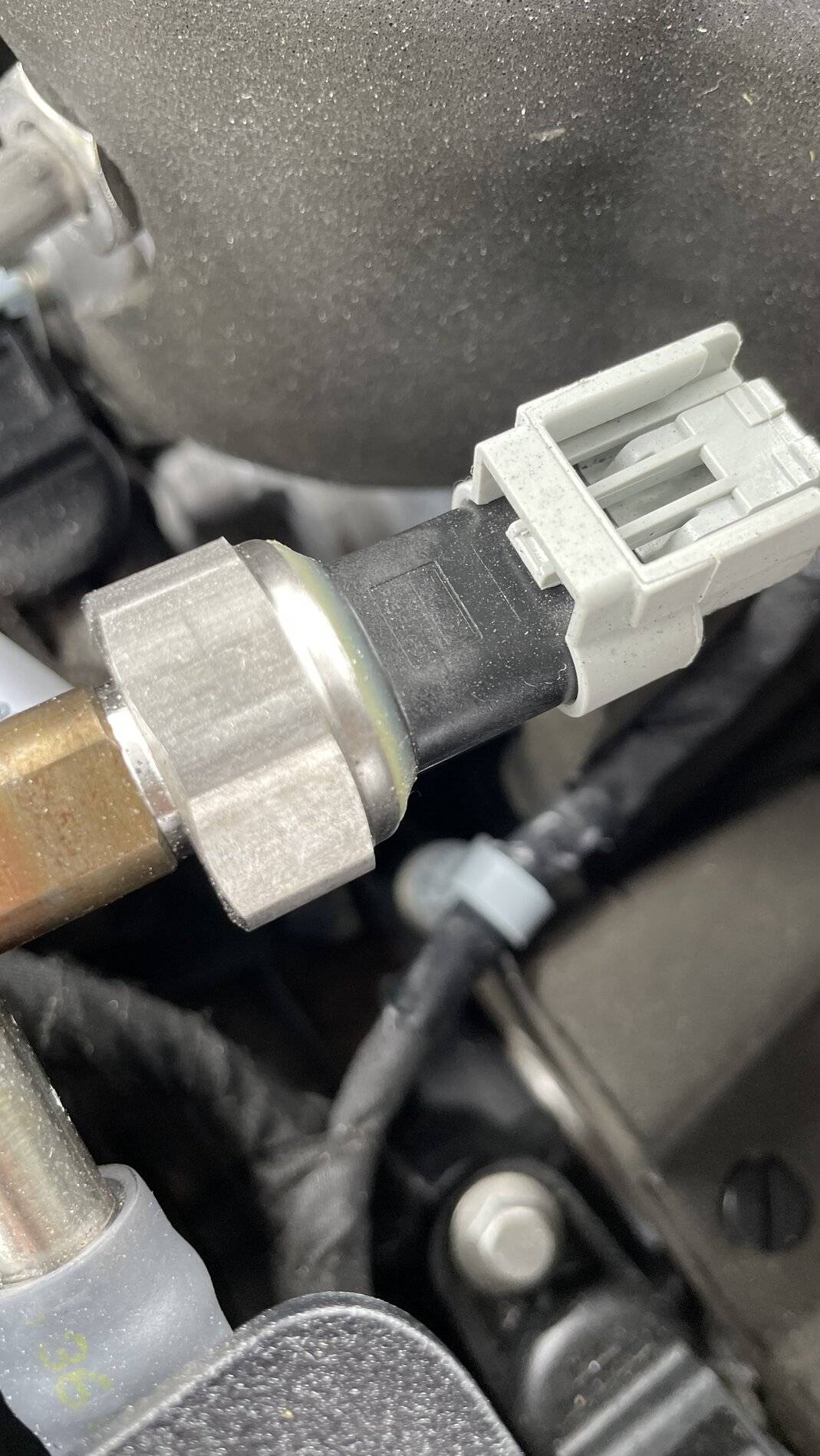

Thanks Blyman93 for sharing this. I just replaced mine, very easy. BTW, if you don't have a 24mm deep socket, check if you have a 15/16", that fits perfect and worked for me along with the 12mm wrench to hold the line. Mine cracked loose pretty easy after 5 years and about 50k miles. After breaking loose it was immediately finger loose. Replacement part came with the o-ring. The only place I've ever had a problem is, there's a left turn I make that I have to almost stop for and it's going slightly up hill in the turn, then flat. Almost every time I take that turn, the car stutters and lurches. I'll watch to see if this makes a difference there but my idle was already smooth. My engine is an early 15 Spain engine.

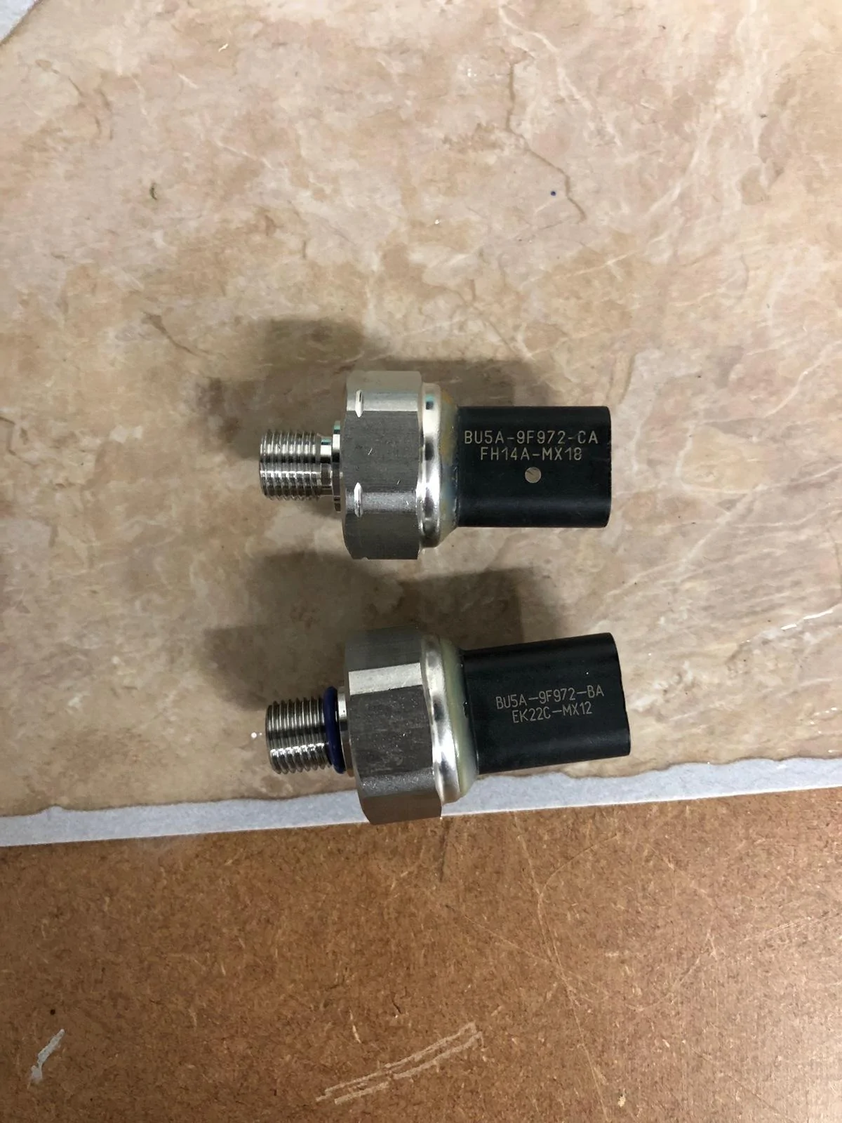

The sensor at the bottom (BA) is the factory sensor:
The blue O-ring didn't come on the new sensor so I had to move it over, you can definitely tell some exterior design changes.

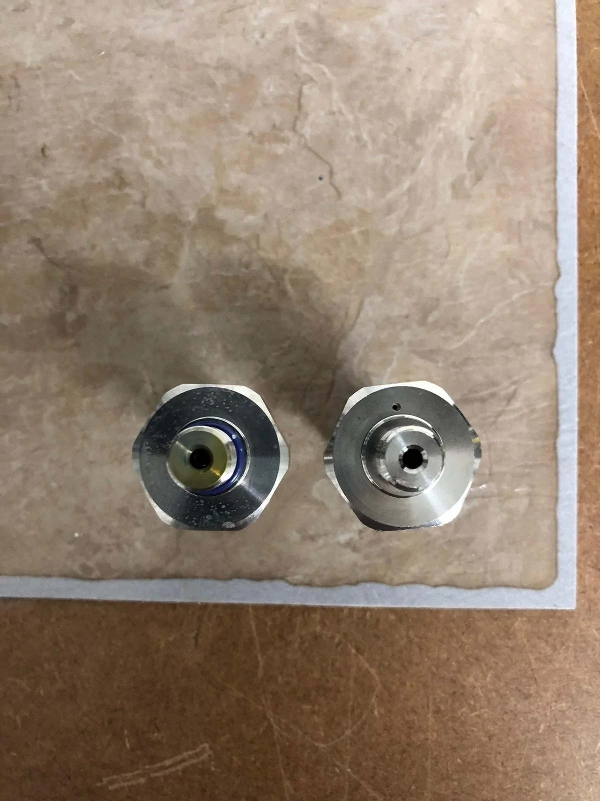

Here is the picture of the sensor itself:
You can see the vent hole that's mentioned before, and you can see the discoloration from the fuel vapor. I have only used 93 Octane, Top Tier fuel from Costco in this vehicle, it's never seen a lower octane rating.
