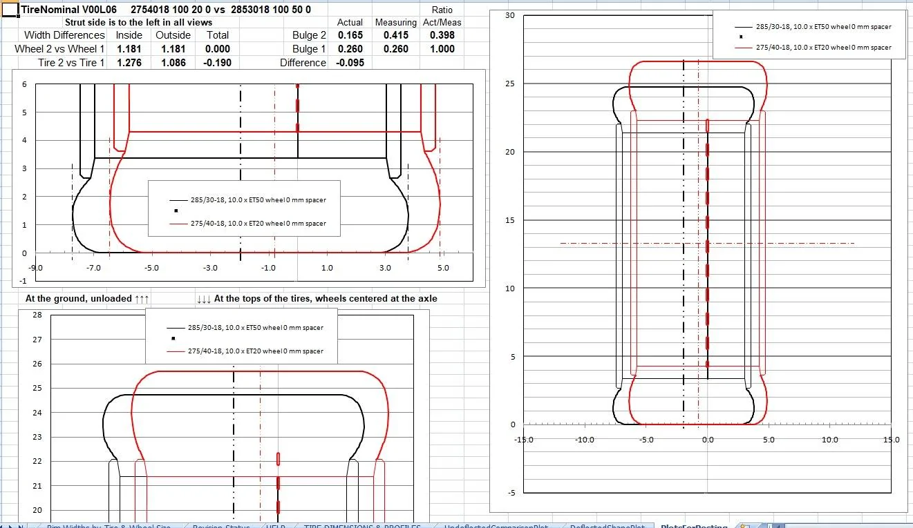

I went from 275 35 R18 front & 285 30 R 18 rear RE-71r tires to square 275 40 R18 Yokohama A052 tires and just ran my first event.
Surprisingly, it made the car EXTREMELY tail-happy and I softened my strano rear swaybar from full stiff to the middle setting at lunch. In prep for next week, I put the rear bar to full soft.
I'm somewhat less surprised. You've added a lot of sidewall height without changing the as-mounted section width much (I'm assuming that you're still running the same wheels for both your 'before Yokes' and 'after Yokes' events. So I'm expecting a bigger change in lateral tire distortion out back than up front (compared to before).
Almost an inch more sidewall height translates to a 1" higher geometric rear roll center, which is itself an oversteer effect. The half inch added to the front geo-RC height isn't going to balance that, and load transfer through the geo-RC's happens almost instantaneously (no waiting for roll to develop).
Comparison shown with 30mm different offsets for clarity; at the same offset too many of the lines fell almost on top of each other.

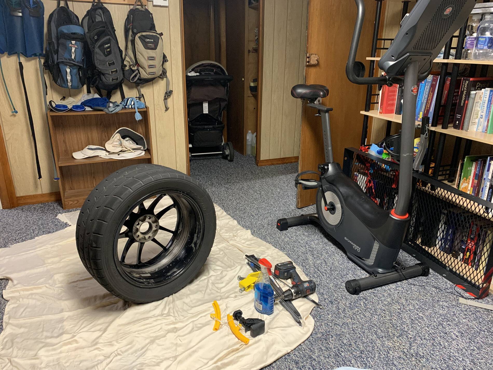

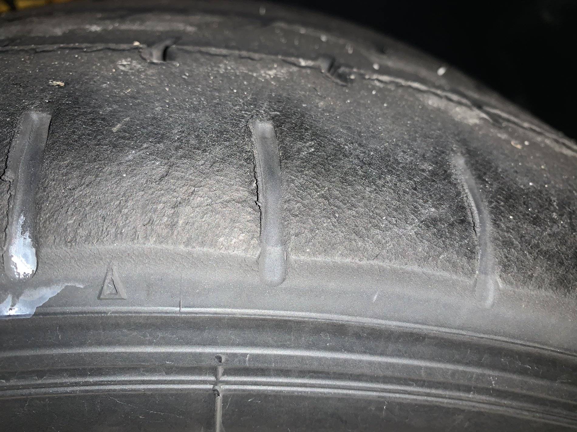

I think after 3 or 4 events total I should rotate the tires front to back. and probably flip after another 3 or 4.
The course was so tight that my friend in STS hunted me down at lunch trying to give me the keys to his car. "Don't go out there with the Mustang, Its a suicide mission." Despite this I left with a big smile and PAXed 15/67. Based on that I would say these tires are a big success competitively... but also probably lighting money on fire.

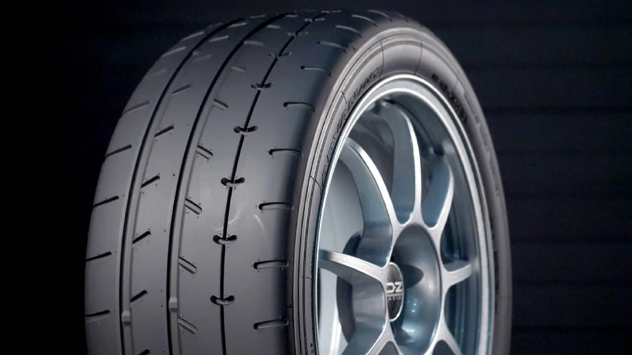

Attached is a stock photo of a new Yoko and my worst Yoko after 30 runs.
