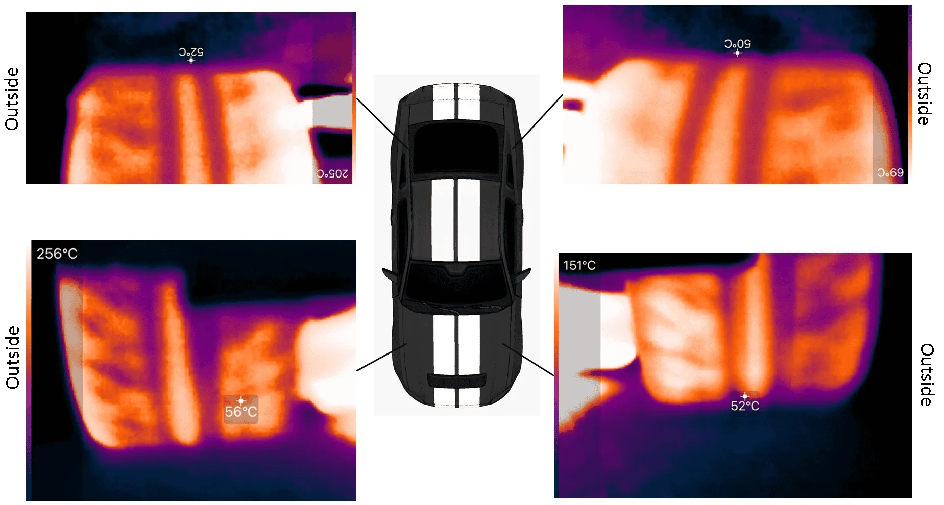

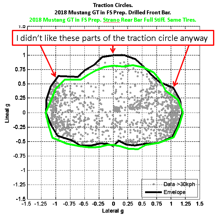

Lumberg voice - "Yaaaaaa, so I'm just gonna go ahead a disagree with that..."To add, one of our alien drivers gave the advice that a lot of front-back weight transfer upsets a car and makes it slow...The advice seems plausible.
and it seems plausible that I’m using front tire scrub as a brake.
What you do with your feet is every bit as important as what you do with your hands and giving the front vertical load to turn on entry is crucial. It's a little ambiguous, but, while a lot of front-back weight transfer may upset the car, the appropriate amount (which is not zero) is necessary to really go fast. As far as you using the front tire scrub as a brake, that's what I saw.
This course had a bunch of slaloms (a Miata driver must have set it up!), so that's a mostly steady throttle maneuver, but in more 'normal' corners, you have to present the car to the corner loaded enough to make it want to turn or you'll induce understeer. If you try to fix *that* understeer with chassis adjustments, then you'll end up with a car which still has the understeer, but also has an alignment or roll-couple which tends toward oversteer.
