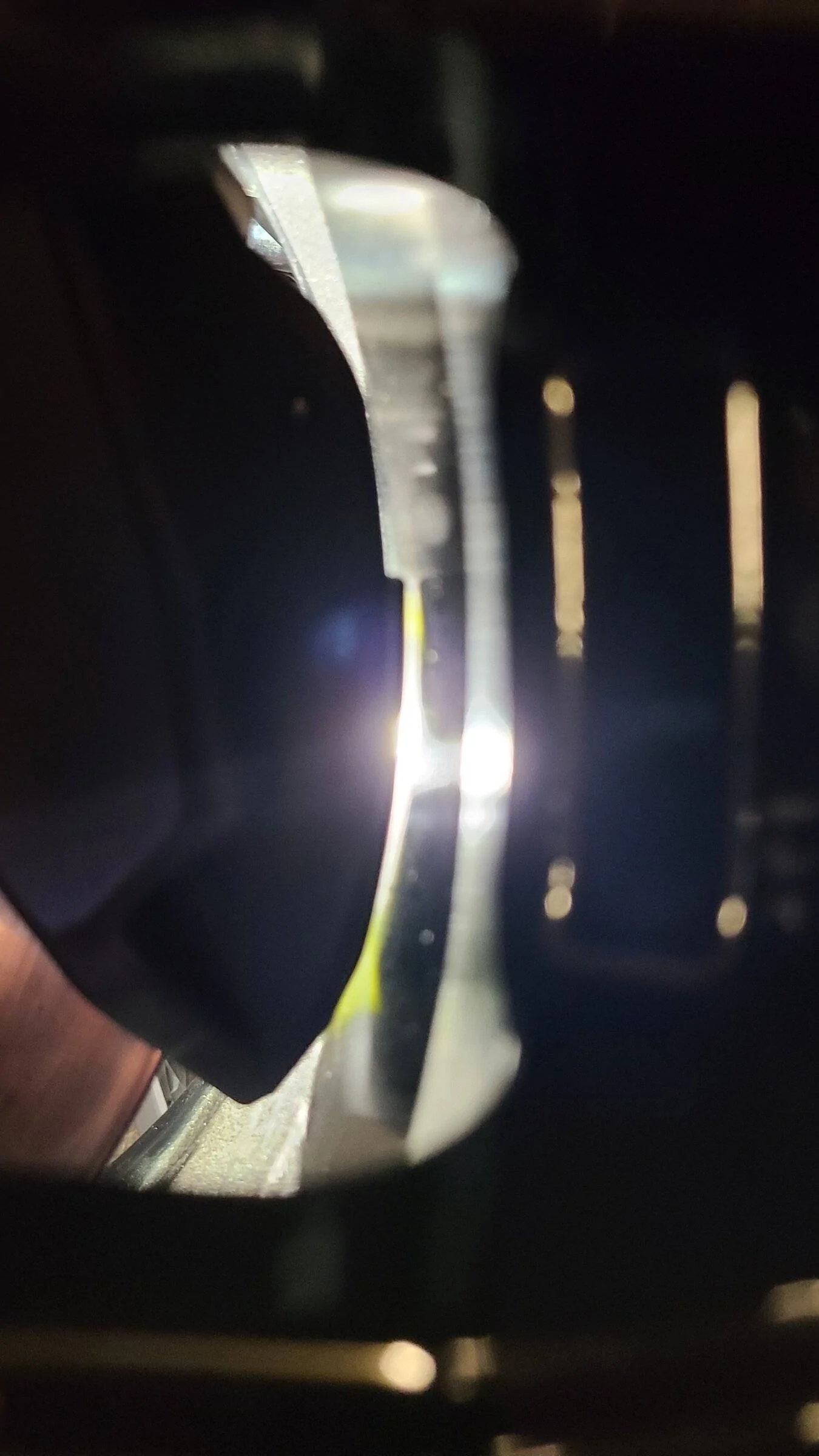

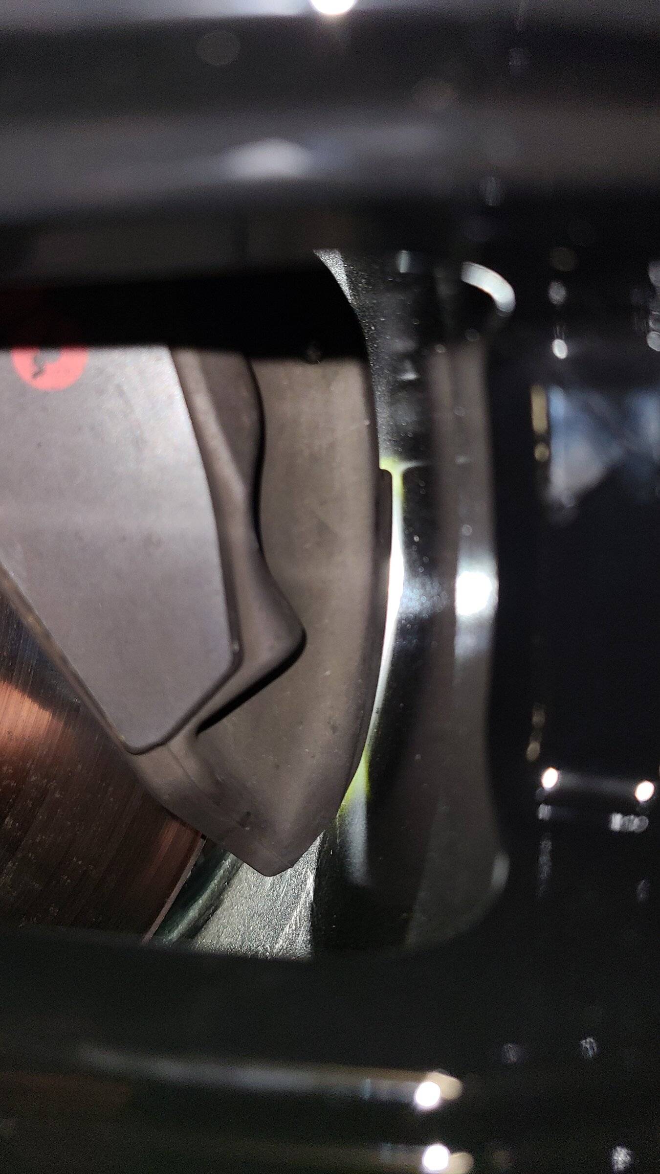

Flow One wheels 18x11s fit with about 2mm clearance between barrel and calipers. The rub in this video is the wheel rubbing on the strut with hiw I have it setup right now. Slotted MCS maxed inward so I'll just pull them out a little and adjust at tower.
I'm gonna send it I think.
Thanks for the leg work. I just ordered 4. At that price, I feel like I should have ordered 12.
