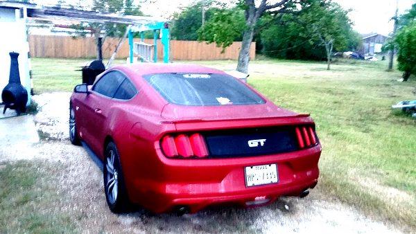

Wider than 255?
I'd like to run 255/45/18's and save money for power adders or more suspension goodies but are 255's wide enough for track/road performance in a sticky tire? Sure the wider 10" wheels and tires look better but tell me about performance.

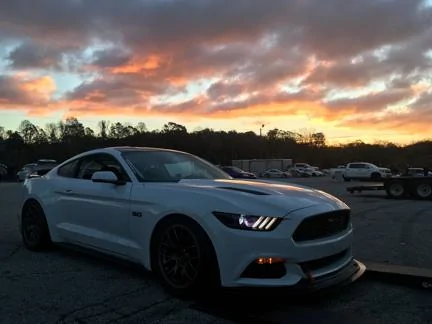

Road Atlanta
Make/Model/engine/trans/packages: 2015 Ford Mustang GT/PP
Track/Course: Road Atlanta
Best Lap Time: 1:37.42
Virtual Best Lap Time: 1:37.30
Brake Pads: XP20f XP12r
Tires (Size & Model): Very tired Pirelli slicks 305/680/18 square
Suspension: RideTech Coilovers
Other Mods:GT350r wing, 3" Front Splitter, Headers and custom exhaust
Improved a little over my last time but on a fresh set of Pirelli slicks and with better track conditions there is a 1:35.xx in the car. The track was treacherous both Sat and Sun, very green, cold weather, and even with tires up to temp and late into each session turn 7 was nothing more than a coast to track out, any attempt to get back on the power would lead to a loss of traction event. After spinning once at turn 7 I backed it down a lot in that corner the rest of the weekend. Had a few issues with the GoPro, but got some video just not all of the sessions. Could not get the GoPro to trigger at all on Saturday, Sunday it worked fine.

I have a GT350 Intake Manifold and am tuned for 7900rpm, I have to restrain myself every time I take the car to the track because it is For Sale and I am trying to be nice to the engine and keep it out of the 7000+ rpms. Should the new owner decide to run it up there it is ready but for now I only use the extended rpm range to avoid a shift between corners.
The Viper was very fast and well driven, it was funny because after that session the driver came over to my pit area and said "For a Mustang that car was well driven, most Mustangs are not" I was sort of shocked by his statement then I realized it was certainly meant as a compliment as he would not have taken his time to come find me if he did not see something he liked. It is funny to me that most track guys do not realize what Ford has done with the S550 and summarily dismiss them as a slow platform. Even at stock power levels with minimal bolt ons these cars are quick. They just need another 75-100whp to deal with the straights. There was a trio of Camaro ZL1/1LE cars in my run group, all of them on R7s and none of them could muster a pass, even on the long back straight.

Few questions. What wheel dimensions? I'm using same slicks on 18x10s. What are you selling it for?
I've received that same comment each time I've been on track this year. "You were flying, usually don't have to let mustangs by me." Car is great just needs fortified a bit and can rip some serious times, and is a blast to drive.

I run 18 x 10 Apex wheels square with 305/680/18.
This car was our test build to find out what needed to be addressed to make the car fast, safe, and reliable. All the info about the car and the others being built are on our website www.trackcarbuilds.com
I should have two (Silver and Black) more identical builds ready for sale by January unless someone wants to buy one and make a lot of changes prior to them being ready.
