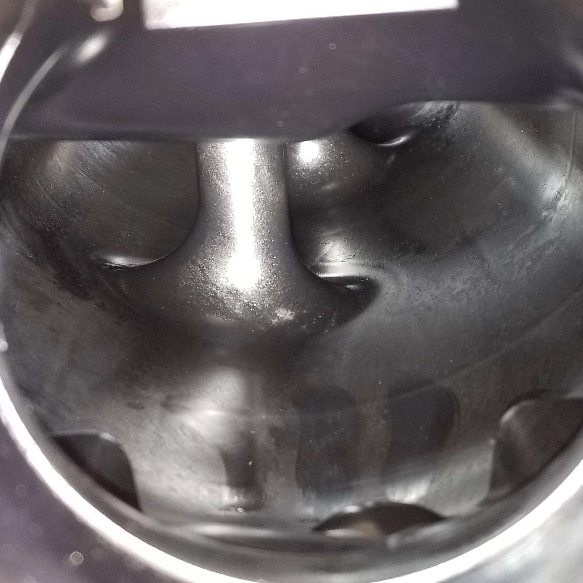

here's a picture of my manifold's internals. it is oily.
is it within norm or excessive?
the car is having passengee, but no driver side can. Consumes no oil. Passenger side does contain some oil by the oil change time, but not excessive. It is UPR can which I saw a lot of positive reviews of.
Driver side did have JLT can which was catching nothing and overall I was not overly happy with its design so I removed it

Thats what my intake manifold looked like inside. Nothing major just a bit shiny. I ended up taking off my pass side catch can because I thought I could hear an air leak on one of the connections.
Didn't seem to matter cause I had pinging with or without it.
