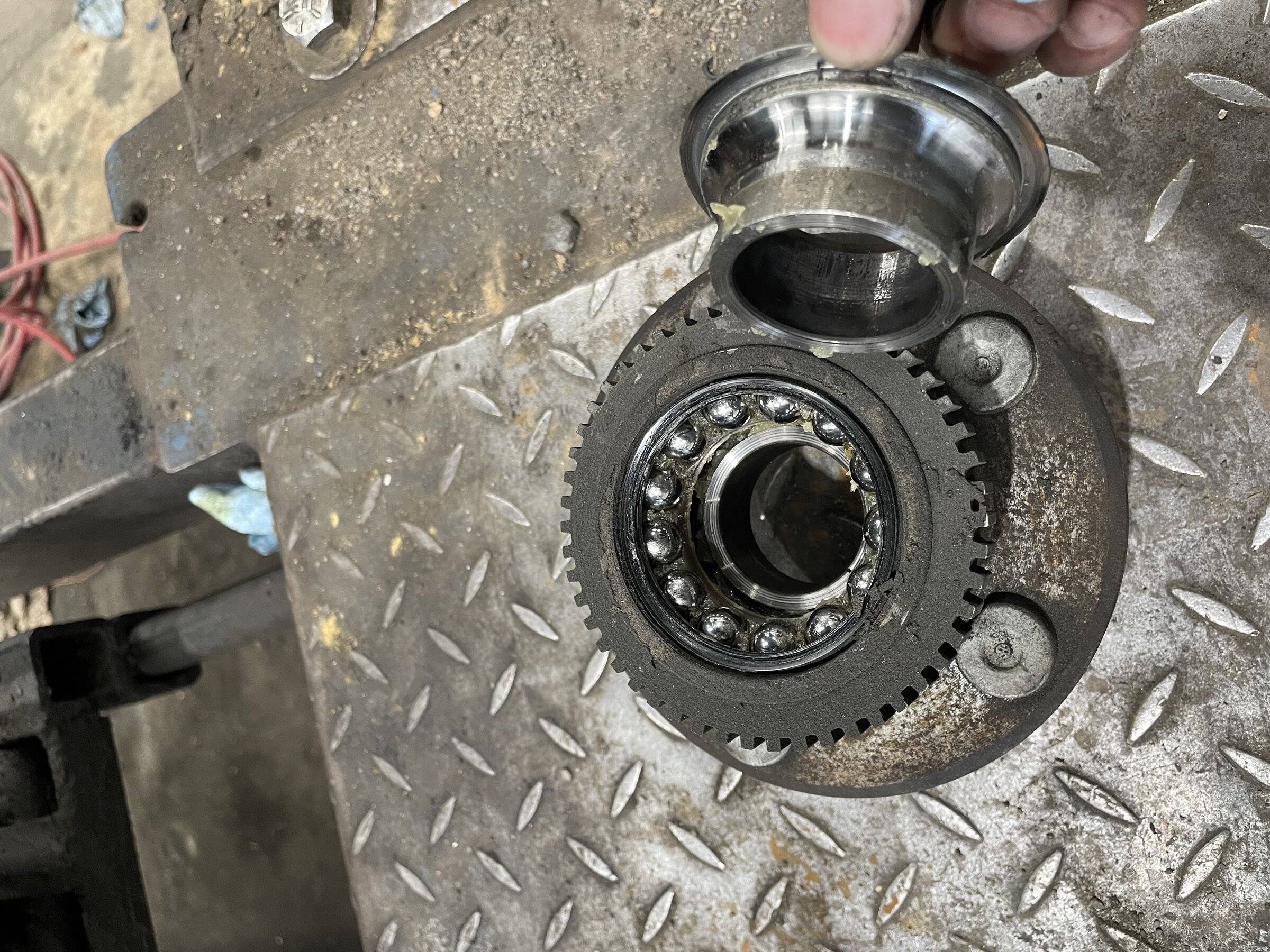

Just fixed the wheel hub. To my surprise, it was the right wheel bearing that was bad. Left one was intact
That cap I’m holding is supposed to be sealing the bearing and isn’t supposed to come out. It was just sitting there when I took the axle nut.

That is trashed. Lucky it didn't fall apart going down the road
