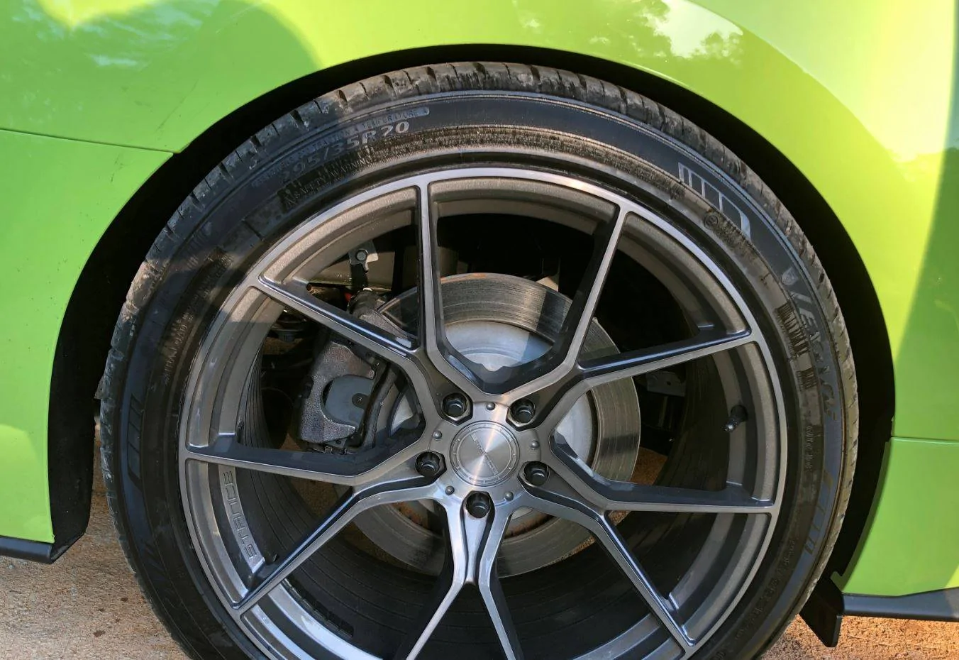

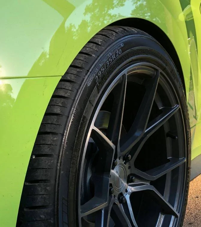

That is good to know, thanks! I guess I didn't notice that the driver rear side sat lower with the 19" PP wheels and tires with the stock springs. It makes me nervous because that fender lip is about 1/4" from the tire. I also have an aggressive wheel and tire setup. I installed the Stance SF07's in gumetal with 275/35/20 and 295/35/20 in the rear. The offset is pretty aggressive on the rear wheels. Since I have to drop the subframe I figured I would swap out the Steeda springs (1.0" inch drop) with the .5" BMR springs and I could rest a little easier while driving around town. The Steeda's in the front are spot on and I like the linear spring rates.
The BMR drag spring drop more than BMR Performance springs just be aware of that. Those are nice wheels. I am same with aggressive offset which is why my rear tires stick out a bit and rubbing happened.

This weekend I installed the BMR performance springs in the rear (finished up my fronts as well by installing the Maximum Motorsports caster / camber plates and Steeda Bump stop kit). I will say this, both sides of the rear are even now and I have 3/4" between the tire and the fender lip on both sides. So changing out the rear springs fixed my issue. I suppose I could have gone with spring spacers but both sides would still be uneven unless I went with 2 different sizes I suppose. Regardless, I am a happy camper now. The car looks the same from both sides lol. Drove a few miles to help set the springs, installing the Steeda IRS subframe bushing support kit (I already did the subframe alignment kit) this week and then FINALLY I can take it in to be aligned.
