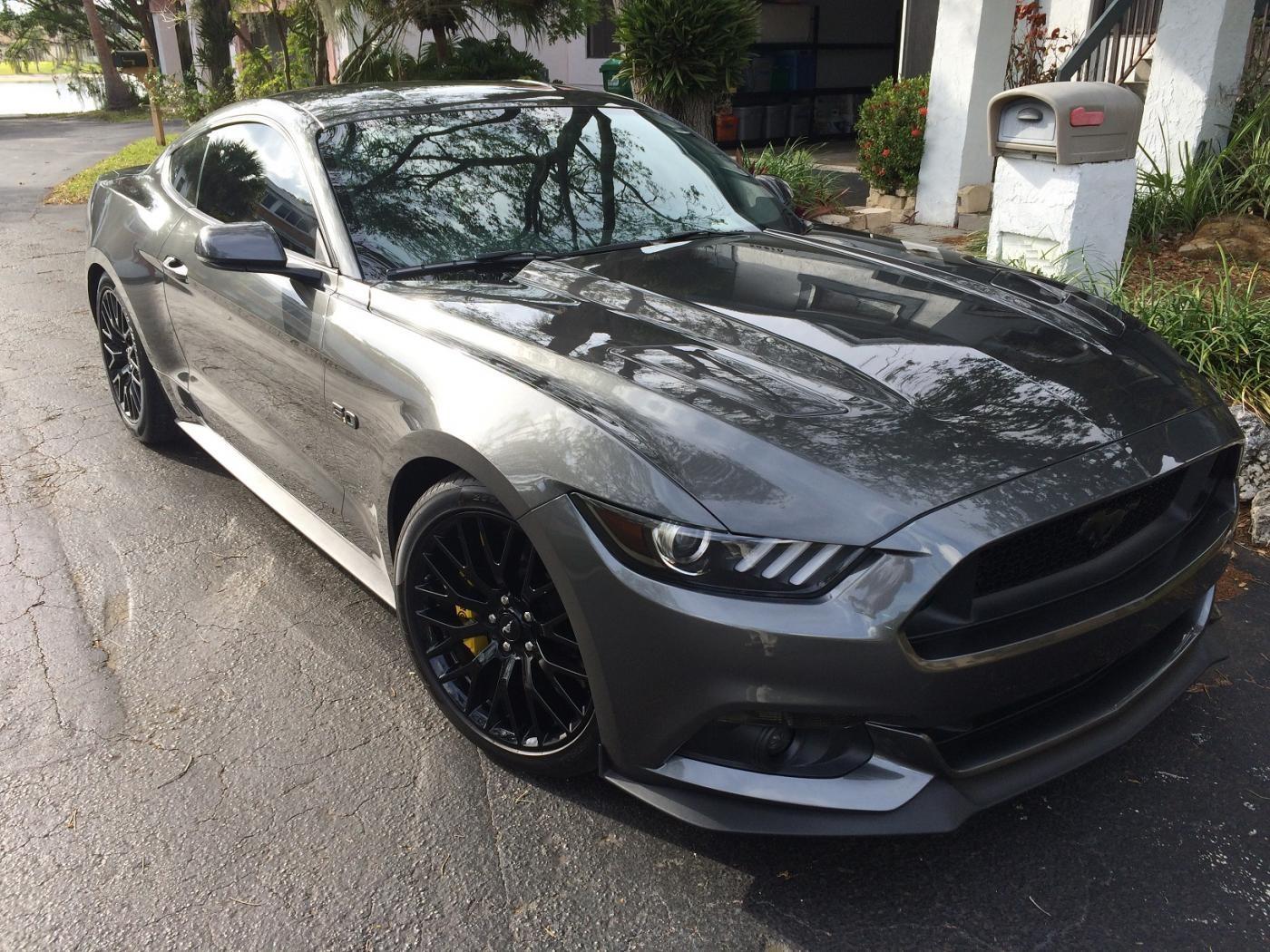

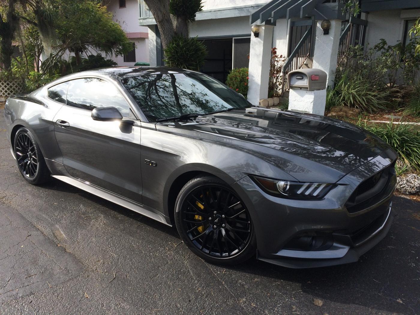

So I've been a long time lurker since way back when Chazcron was rendering body panels and i decided it was time for me to provide some details on my project GT PP and and the pros and cons to my mods
this is my current list of mods:
20% tinted windows
diode dynamics interior LED conversion kit
diode dynamics reversing light LED
Eibach pro lowering springs
Powder coated my brakes yellow
I Plastidiped my emblems black and yellow dotted my 5.0
I tinted my side markers and reflectors and the corner of my headlight with a kit from anchor room
I also have the Borla S-type exhaust ordered and in transit.
Here she is, Epona (name is from a Celtic horse goddess and I'm also a huge Legend of Zelda fan)

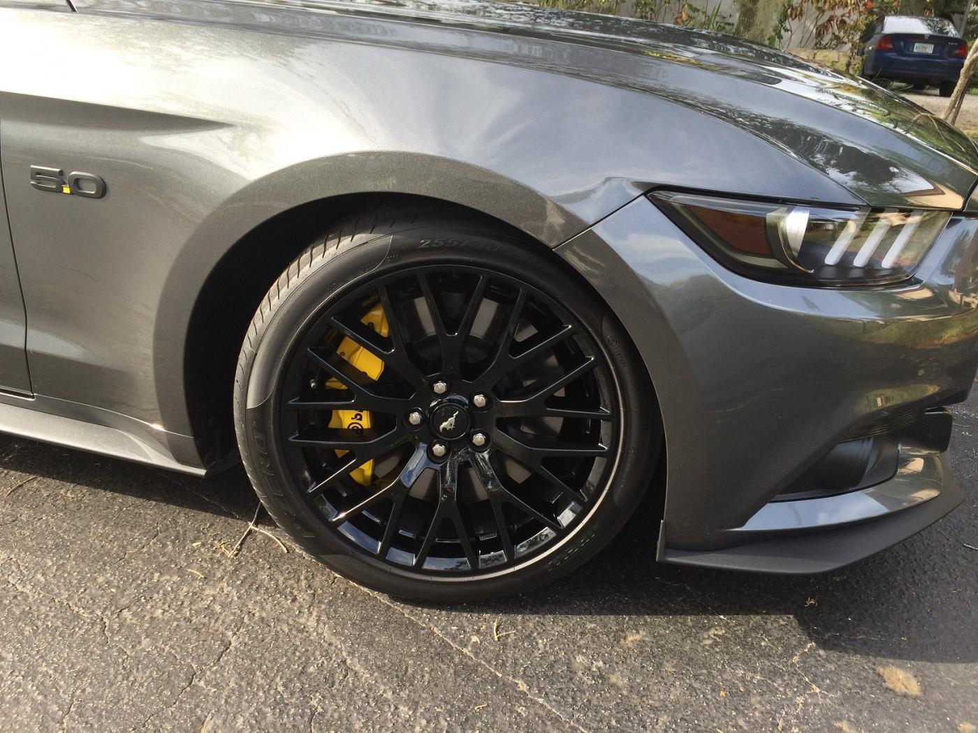

OK first mod feedback ... powder coated brakes. they look awesome, but are such a pain to keep clean. i will be looking into carbon ceramic brake pads to deal with the brake dust, but for now im just cleaning them regularly.

well i started out with a DIY kit you can buy online which i royally F***ed up then i found a local shop that removed my disaster and powdercoated them. i had to remove all parts and then rebuild the brakes when i got them back ... (take plenty of before removal pics) the brembos are pretty straight forward to put back together, but the rears were a bit of a pain. there are diagrams online from previous models that are close enough to help with the rears.
the final part is re installing and flushing the brake lines. Make sure you have the right brake fluid ( dont quote me but i think it was DOT3.. i dont remember, i did it in early january.) and dont get any of that stuff on your brakes because it will ruin the powdercoat. if you do get some on it by mistake DO NOT WIPE OFF... pour plenty of water over it to remove the fluid and pat dry. if you dont know how to flush brake lines, youtube is a wonderful source of knowledge.

Do you mind if I asked how much you payed to get them powdered coated? Or PM me. Im looking to get the same color.

I Payed 400 which I know is a lot but they did remove the mess I made and did all 4 brakes. They're also one of the few places in Miami that does that.

I think the yellow looks pretty good, can't go wrong with red on the Magnetic either. How was the "Brembo" lettering done? Did they added after the PC?
P.S.
No stickers...please.

It's vinyl decal... I was worried about it at first so I bought a bunch of extras, but it's held up very well. I couldn't figure out any other way. I considered putting a clear coat over it, but decided against it.

Car looks badass.

OK, I didn't mean the Brembo sticker, that's something I would do, looks good. I guess I was referring to Horse Stickers, if that's what you were considering.

What color Plastidip did you go with?
Did you gloss it? It doesn't look like???
One magnificent Magnetic!
