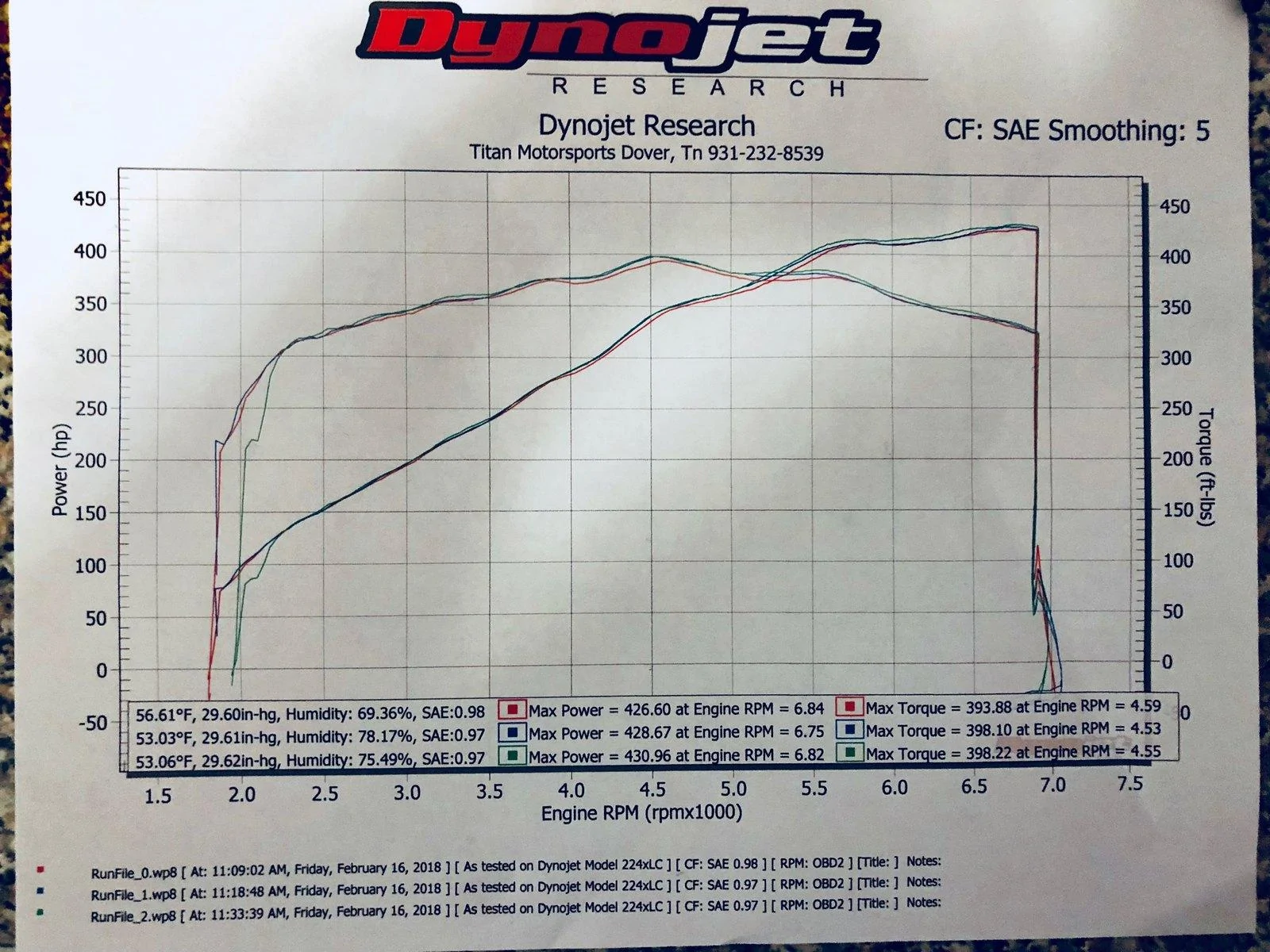

Yeah youve got another 1 or 200 rpm before it starts falling off. At 431 rwhp and 12 percent drive train loss youre at 482 hp. At 398 tq youre at 445 engine tq. Even at 10 percent drive train loss engine hp is 474.
Dynojets always read high...just the way they are(that one is really generous though). Good for a base number so when you add mods if your using the same dyno you can see the results better.
^^Correct. I came over from Supra territory and Titan always came in high with those cars. I would have thought no more than 20hp so, yeah, that one is generous.
