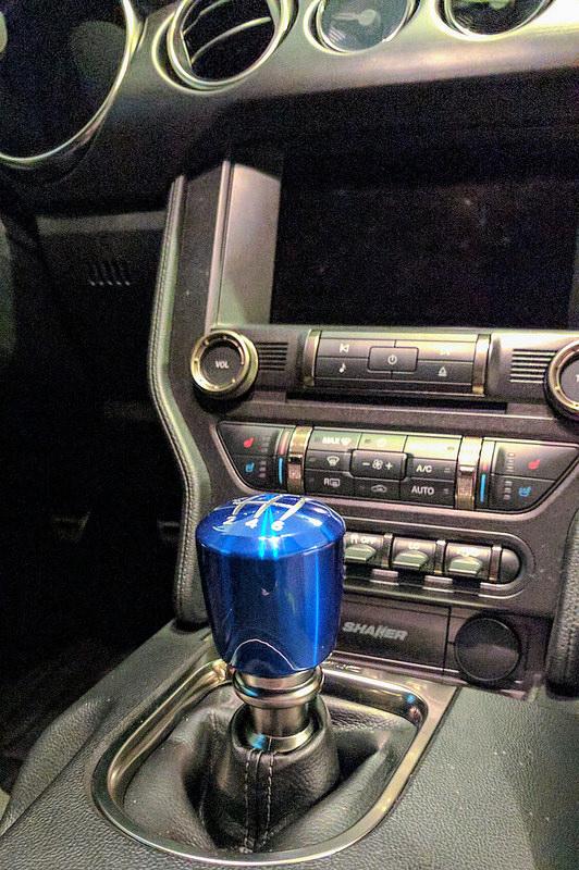

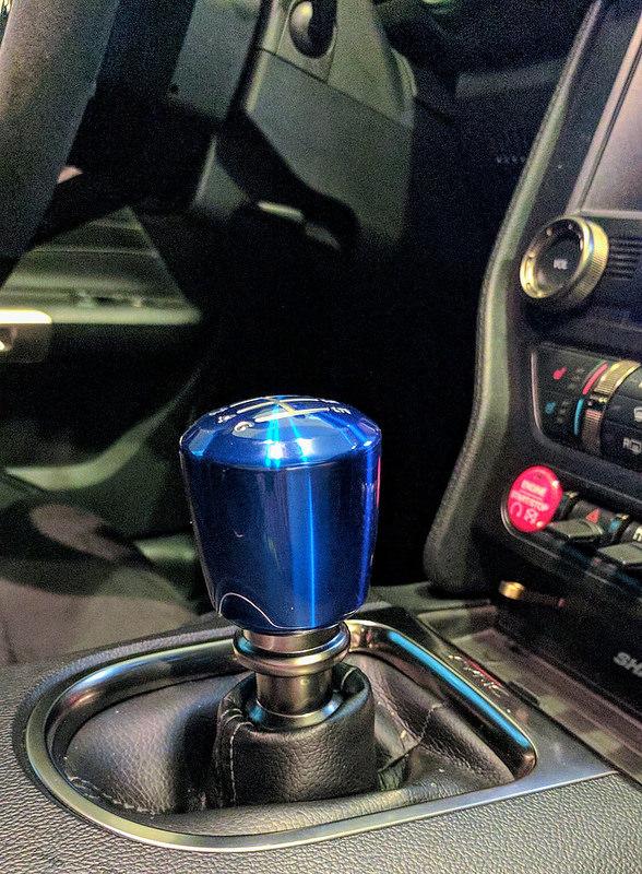

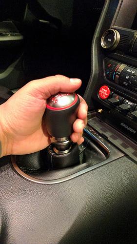

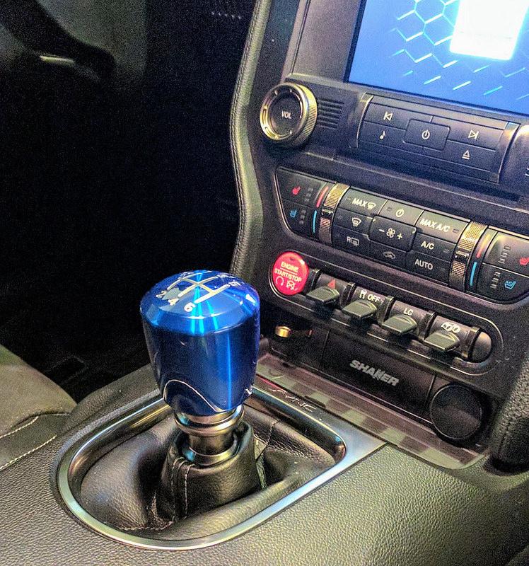

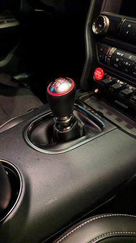

I have switched shift knobs like a woman changes shoes, since I purchased this car. I know I'll never go back to having anything but a manual transmission. After two shift knobs, I decided to spend some extra dough and throw on a Ford Performance Short Throw Shift Kit. The difference is indescribable. Now what else but to finish it off with a custom Raceseng weighted shift knob!
Here's the Short Throw Kit with the OEM shift knob:
and here's my current setup:
Raceseng - Ashiko Big Bore - Translucent Blue on Ford Performance GT350 Short Throw Shifter -
