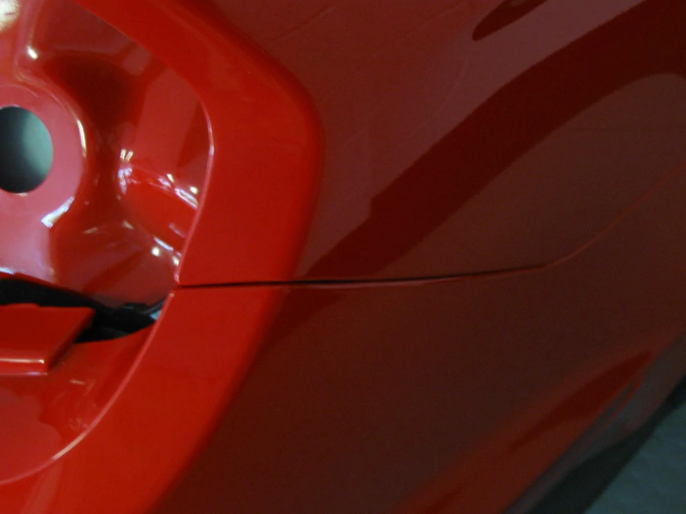

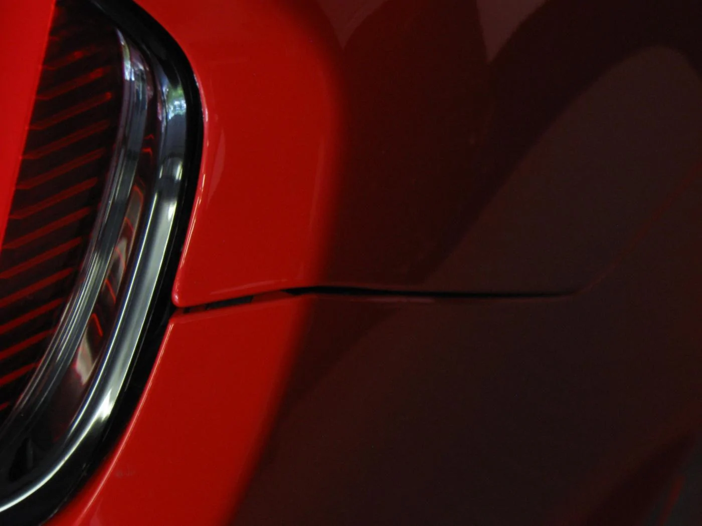

Only have the right side. Before, with Jack and after. Maybe a slight improvement. After picture is a lot closer so it actually looks worse, but it isn't.I'd be interested to see if if someone could post pictures of the before/after...

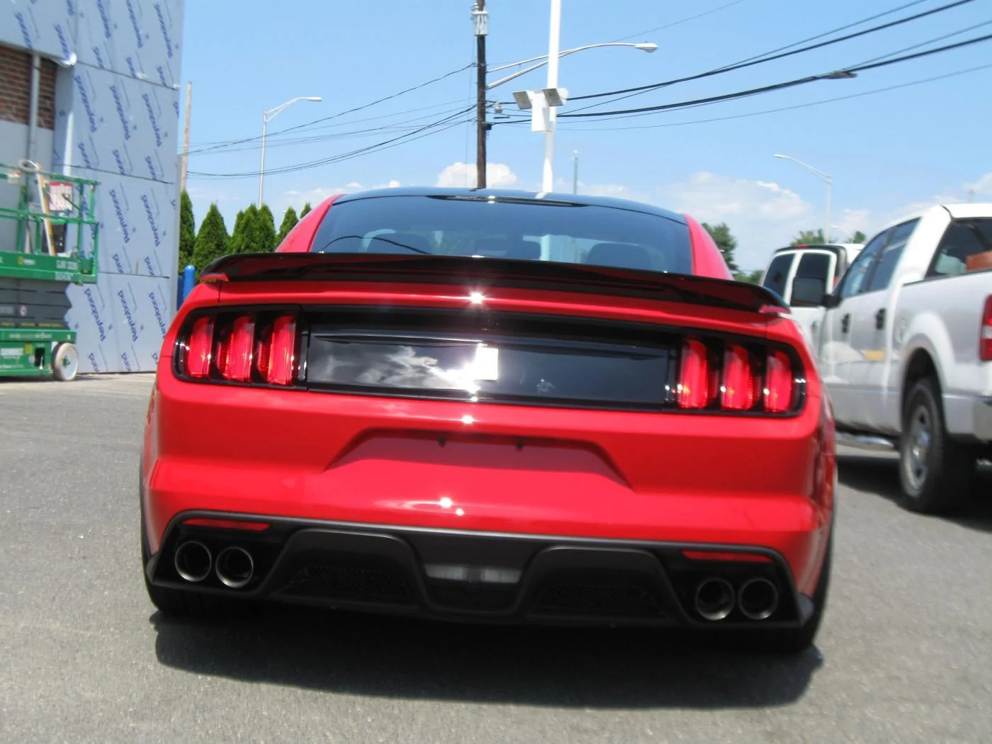

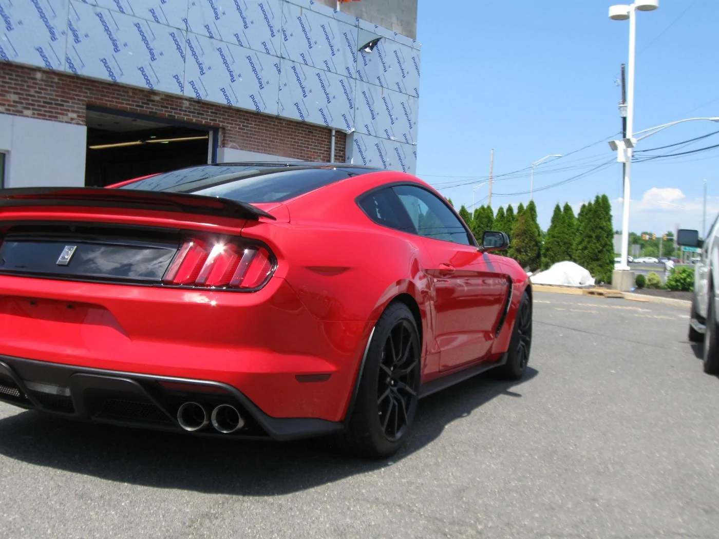

Here are my gaps, I think I can live with this, for now

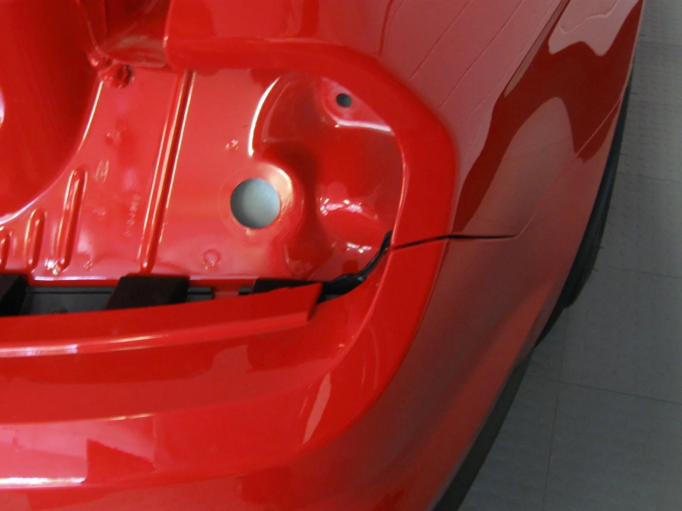

Thankyou! It looks like they are not soldered on the clips like mine!I removed my tail lights in an attempt to fix the problem. I took a lot of pics to document my fix, but my fix didn't work as well as I hoped, so I wont bother.
As I stated earlier, it is a design problem, not an assembly problem. The top of the bumper cover is supported by a tab on the bumper cover sliding into a slot on the black plastic component. Not a very secure connection. I don't think there is much more to be done unless you disassemble the whole back end and try to realign it, in which case other gaps will most likely increase. I'm done and am going to live with it.
My fix:
1) Raised both bumper sides with jacks to get the gap where I wanted it (it looked good - too bad we can't drive around on jacks!)
2) Applied some 3M 2216 2 part Epoxy adhesive to both sides where the tab goes thru the slot. Let it cure overnight with the jacks in place.
Very slight improvement. The Adhesive held fine, but the black plastic piece itself is not stiff enough to support the weight and must have deflected a bit. I suppose what I did will at least stop it from moving further.
