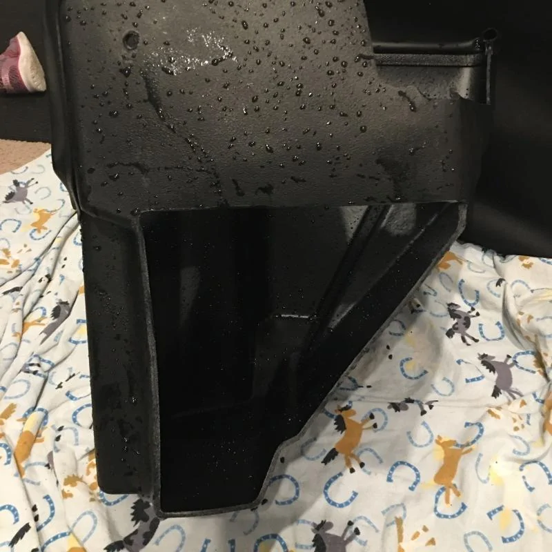

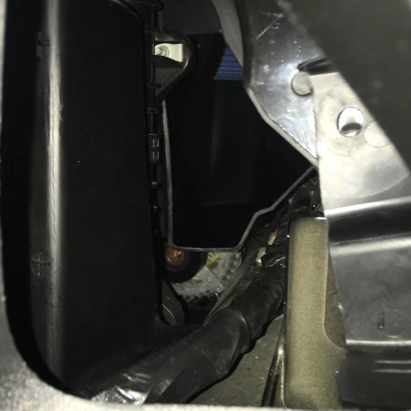

Yes and because I did not want to chop up my stock air box.Fantastic work Gibbo. I look forward to your results as I'm looking hard at this intake. Did you go with GT350 ram air duct because it is larger? I remember PMAS stating that the factory GT snorkel was limiting.
You see mine was previously opened up and I had the Velossa with stock intake which at speed would be 2-3c above ambient and 3-5c above at lower speeds. But the PMAS was 7-10 above ambient at speed once car was fully upto temperature and at lower speeds could very quickly go to 20c above and in traffic as much as 40c over, yes crazy. Though it would cool back down to 10c over once moving at speed again, it took ages to get back to that 3-5c range.I opened up my grille and only see 5-7 degrees hotter IATs when driving. I think people overthink this IAT thing with any of these open air intakes.
Maybe but the IATs have lowered considerably and at $38 I can highly recommend it.I think you're having a placebo effect good sir but I'm happy that the intake is working great for you.
