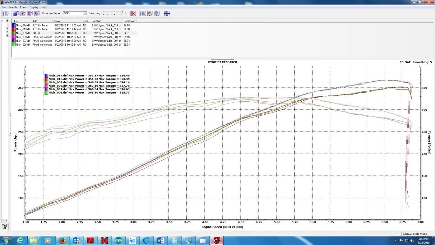

Anyone dyno this thing with a tune vs a tuned JLT back to back yet?
I calibrated a maf to test it against the JLT without a tune. Gains should be similar if not a little more with a tune because it will be making more power and therefore be more restrictive. I'm not sure if anybody has done the test with a tune though.
This was on a 13 but the intake kits are pretty much the same.

Why are the gear ratio numbers different between the pulls?

So you calibrated a stock maf to use it with a JLT and both made similar power WITHOUT tunes? Just making sure I understood.

We calibrated a maf to make the JLT work with a stock tune the same way we make one work for ours. The JLT picked up 5WHP over stock on a stock car and ours picked up 16 over the JLT on the same stock car.
