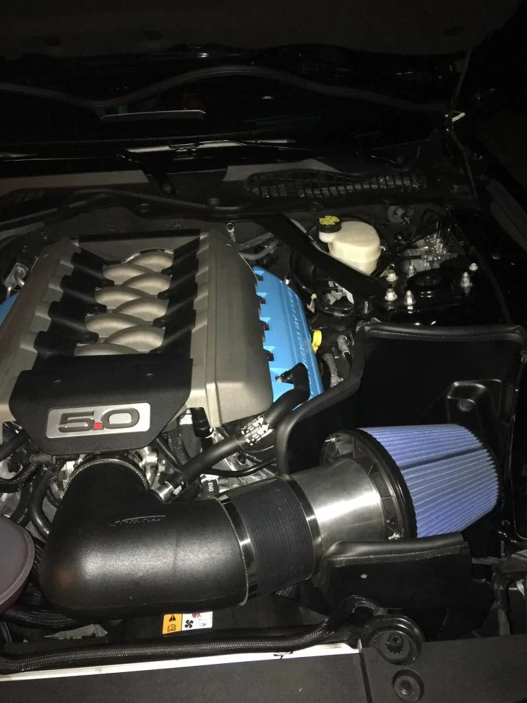

I put mine on this evening. I had zero trouble with the couplers just use a little man strength and it's easy but I've installed 6 ply couplers on turbo setups and those don't stretch. Also no issues with the bolts for the bubble tank. The one clamp for the 4" part of the coupler is a tad small but no big deal it works. The only issue I had was the bolt hole in the box doesn't line up that well with the speed clip on the body because the side of the box hits the body (fender) before it lines up 100%. I plan on cutting the side of the box so more air from the inner fender can wash over the filter which should help it fit better as well.

My box fits perfectly. Did you transfer the rubber grommet and rubber that is on the nipples type part that lines up the box? I transfered those two from stock box.

Looks like something some dude made in his basement. Any chance PMAS has plans to make it look a little nicer?
It's really not that ugly. AEM, BBK and K&N make far uglier intakes for the S-550 (especially the chrome versions) and those make zero power gains because they use 3.5" tube like stock and tiny filters.

Is the maf housing suppose to be that far in? Mine didn't seem to make it that far and don't want to crush the wires to sensor.
