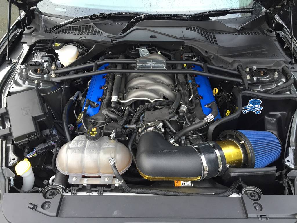

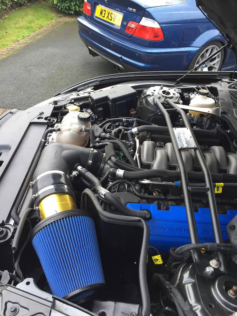

So first of all a couple of images of my install how it is now (maf behind heatshield):
You will see I have used gold heat reflective tape to try and keep temperatures down, after a 30 minute drive I can report the intake tube, maf tube and filter are still cool to the touch, whereas rest of the engine is red hot. Though the tape on the plastic PMAS tube is peeling so that might have to come off.
I originally installed with maf sensor outside heatshield, did it make any difference changing it so it was inside the heatshield, I'd say it dropped the driving IAT by around 2c, so now only 4c above ambient temp reported, so its a very minor difference, in traffic IAT's still shoot up quickly compared to stock air box, but on the flip side they also come back down far quicker once moving.
Also I have zero issues closing the hood/bonnet, it closes with no resistance so I can only assume nothing is touching at all. :)

FWIW, PMAS lost flow using any type of ducting in front of the box and they advise against it.

Gibbo 90% of your post was fairly unecessary. Its pretty match the same stuff youve been saying. Other then you threw in some back handed compliments. Also its a damn open element intake. They make noise even the unnecessary carbon fiber ones. You have some unrealistic expectations. Just my observation
Dev hes been told about the duct multiple times. He is still hung up on iat. Even after the sensor has been shown to not be 100% accurate

On a cold start my car still showedon't 9 degrees over ambient temperature Witch leaded me to beleive it's not fully accurate. Don't really matter to me since multiple times I've read flow outweighs cold air.

Difference is now I am posting from actual experience and owning the intake, I enjoyed typing it, am sure others will enjoy reading it.
Plastic intakes, carbon fiber intakes, yes make noise, but the tone is completely different, plus carbon fiber has better properties for resisting heat soak. :)
